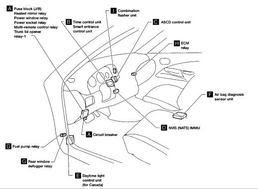

I just need a diagram of the fuse box.
May 8, 2018 at 5:08 PM

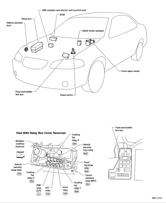

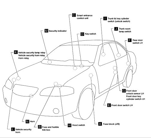

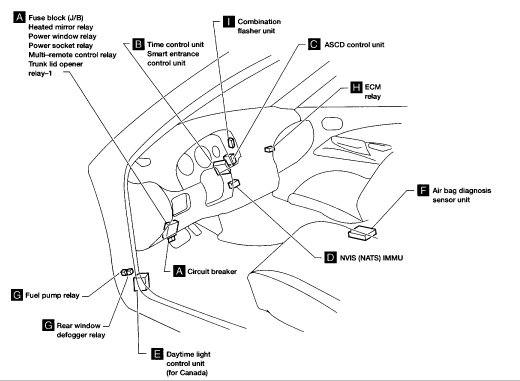

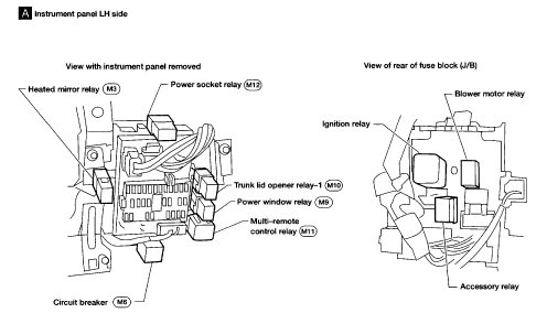

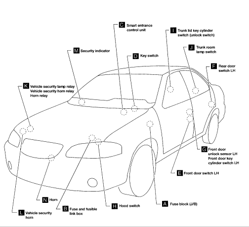

Hi and thanks for using 2CarPros.com. I have attached pictures of the fuse, circuit breakers, and relay blocks along with locations. Additionally, here are directions on replacement:
