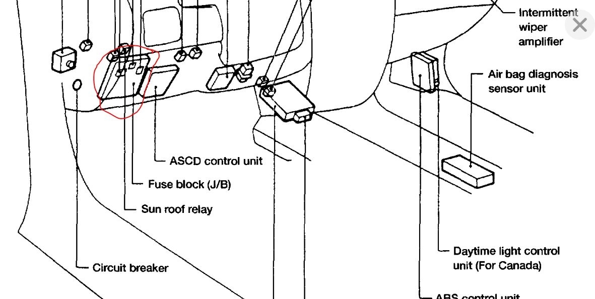

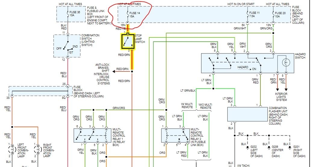

lost fuse interior fuse diagram would like to know number for rear brake lights.

It is in the fuse block under the left side of the dash. It is fuse 14 in the fuse block. I attached a wiring diagram for you to view. If the fuse is not the issue, we can do some testing to find the fault.
