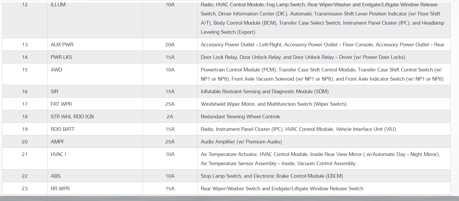

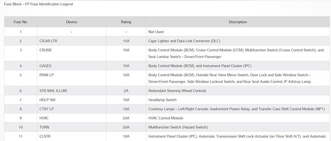

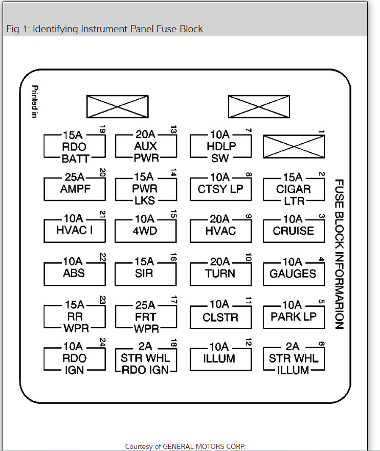

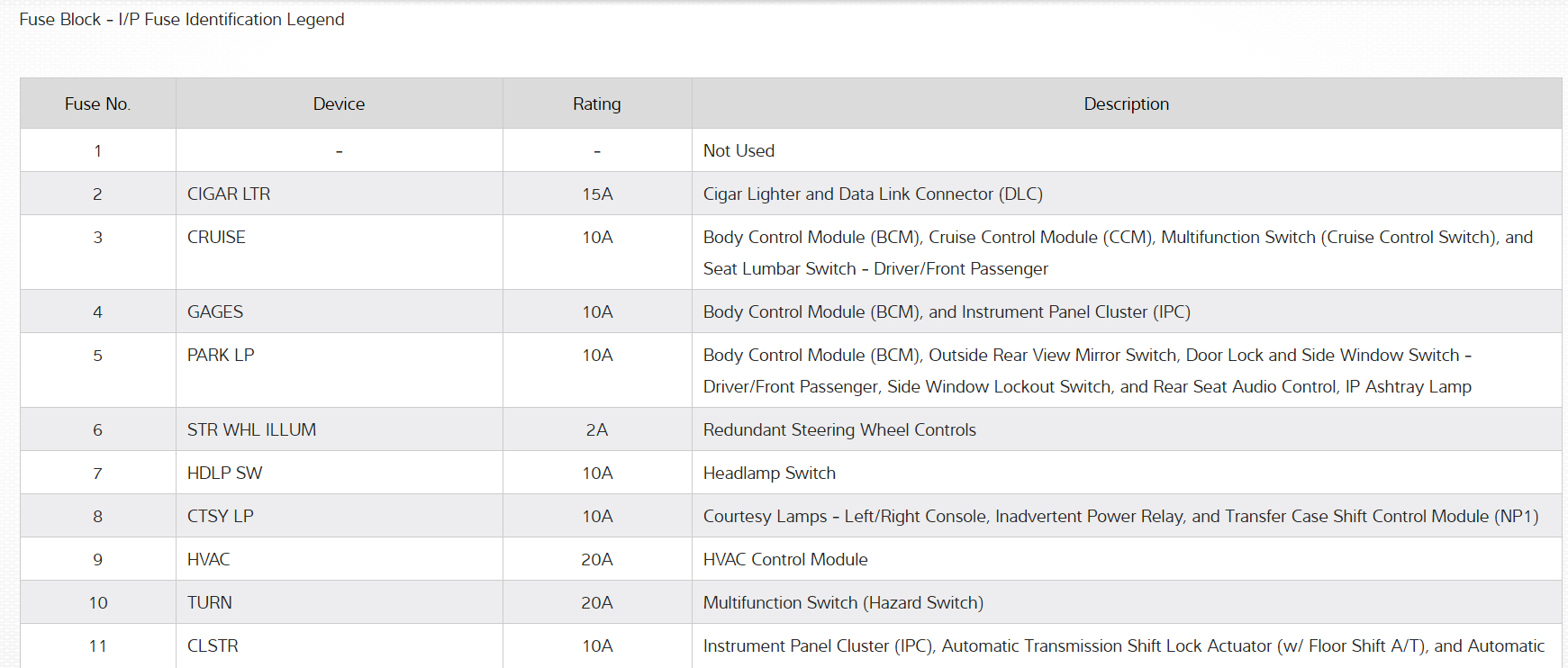

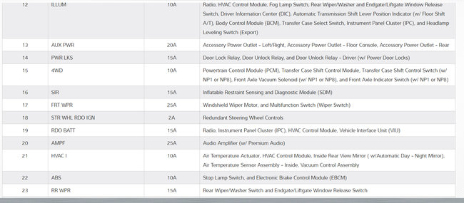

It looks like fuse 17(25A) in the instrument fuse panel which is located on the left side of the instrument panel near the door jamb switch. I have included diagrams if it and the fuse legend below.
