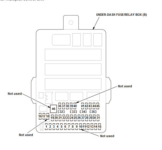

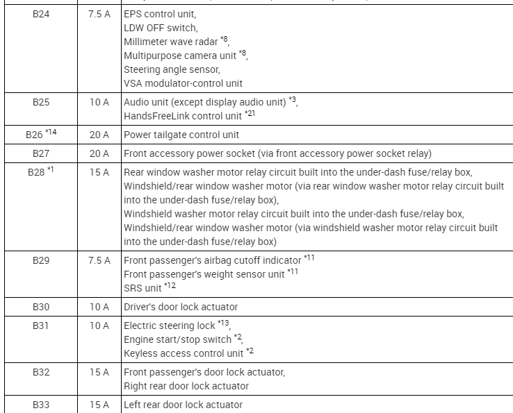

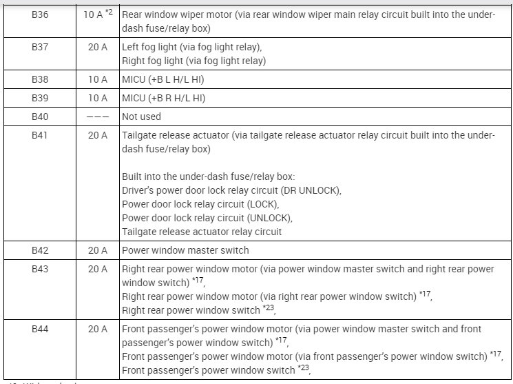

I am pretty sure I have popped fuse, but can't read the numbers, and can't easily reach the panel. Any suggestions on how to replace it?

Here are tutorials showing how to replace fuses:
https://www.2carpros.com/articles/how-a-car-fuse-works

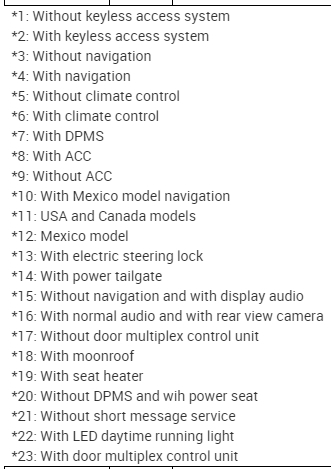

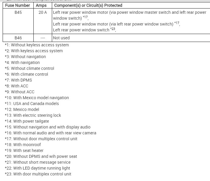

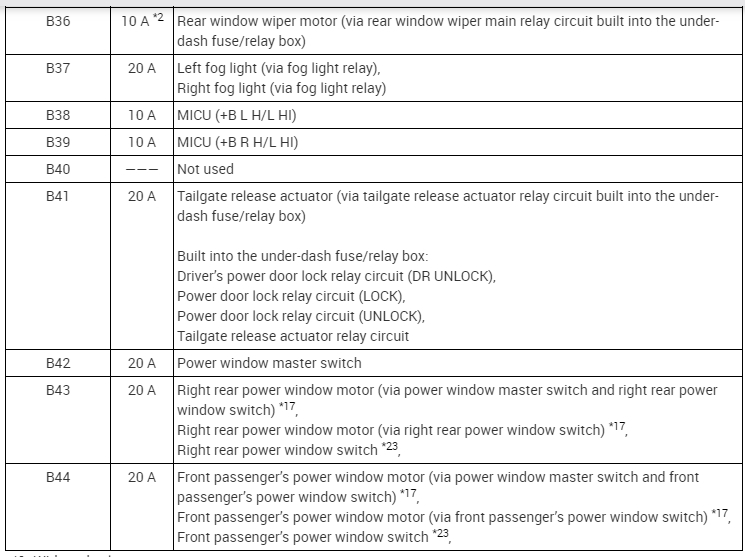

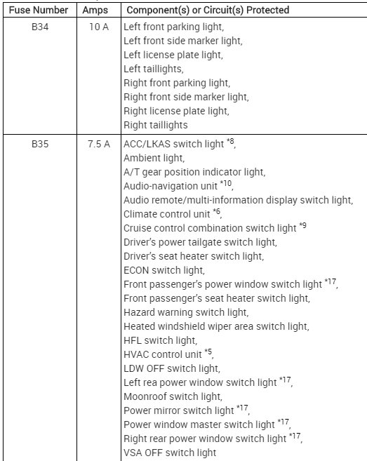

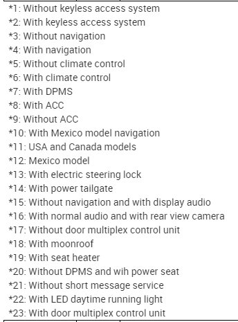

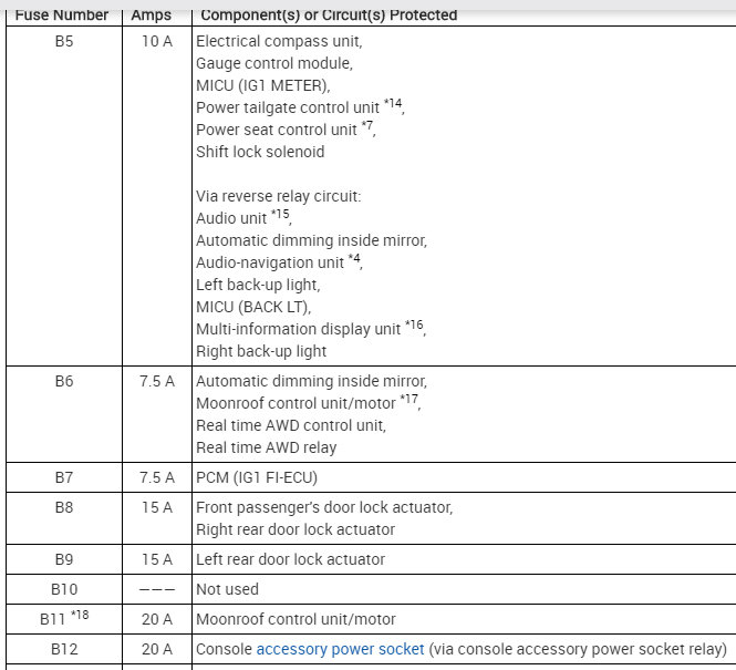

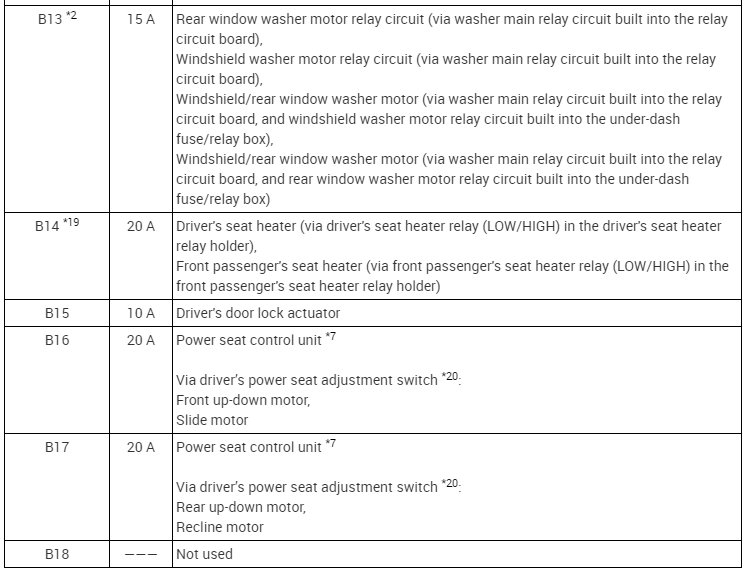

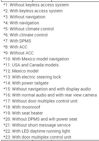

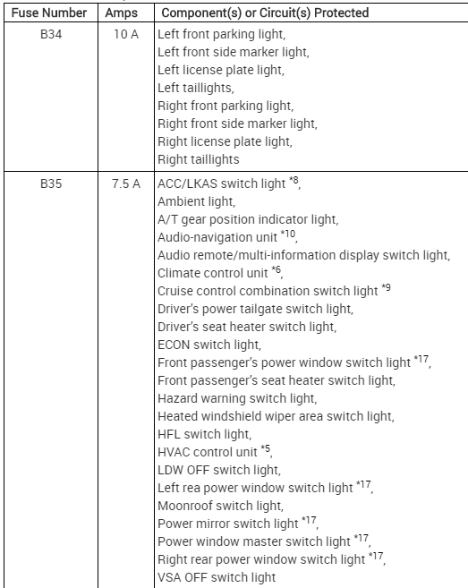

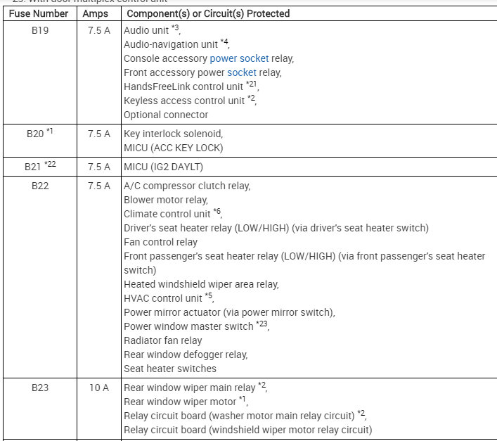

I've attached below pictures showing the fuse numbers and what circuits they protect including the amperage requirement.Hope this helps and thanks for using 2CarPros.
