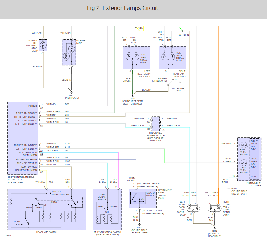

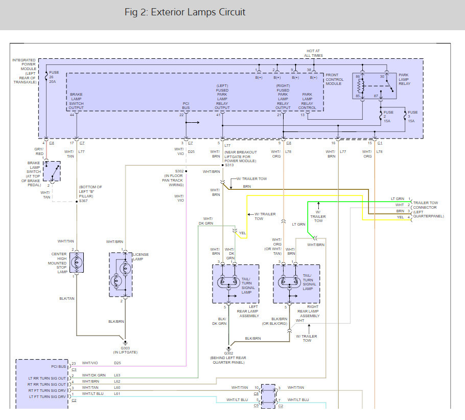

There is a parking light relay that supplies power to those fuses. Here is a wiring diagram so you can see how the system works.

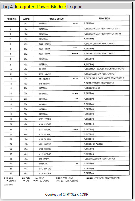

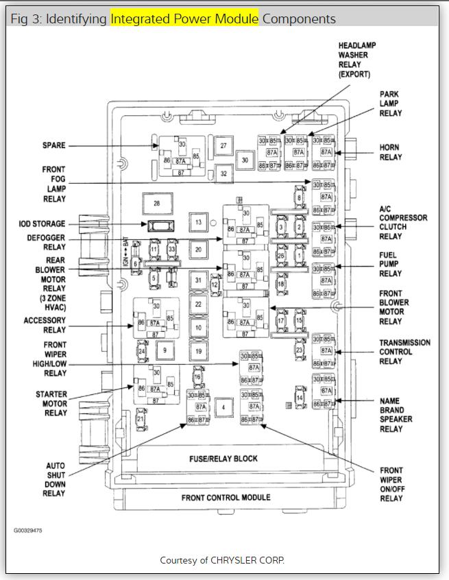

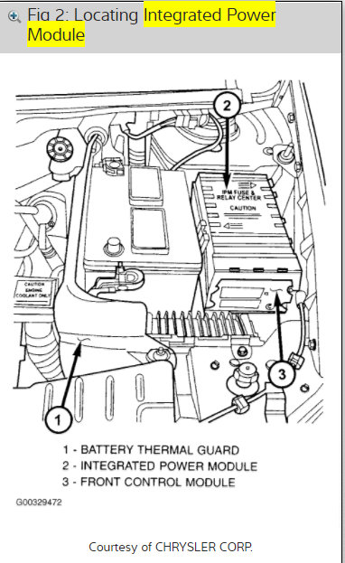

Here are the fuse panel diagrams and a guide to show you how to test the relay.
Check out the diagrams (below).
