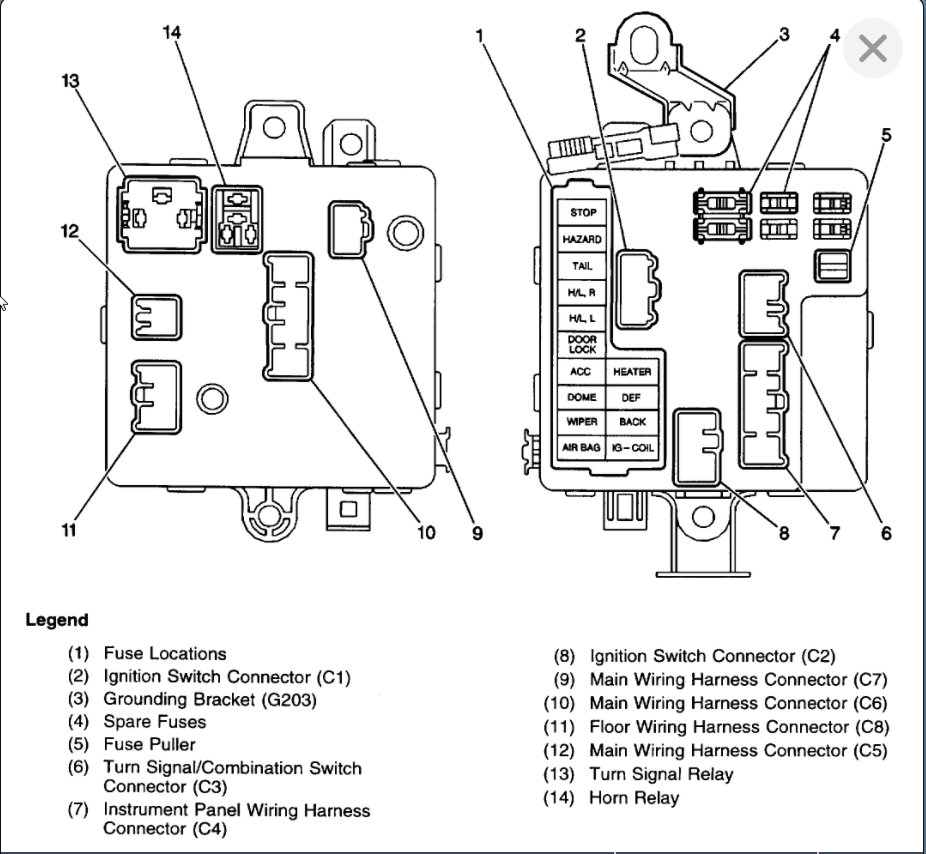

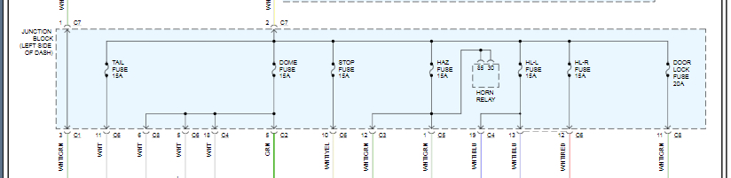

I don't have the dash panel cover or the service manual and need to know what size fuses go where and what accessories they operate please?
Oct 13, 2020 at 2:24 PM
Take a look at the diagrams that I posted for your review. Let us know what other info that you need. Thanks
Oct 13, 2020 at 3:46 PM

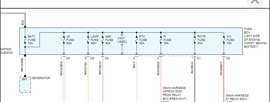

TRACEY JOHNSON-NEWELL
where can i find out what amperage for each fuse slot?
Oct 14, 2020 at 8:08 PM
You gave me image of fuse panel with accessory labels, but i need to know what size fuses go where?
Oct 15, 2020 at 11:27 AM

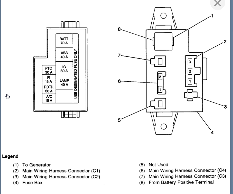

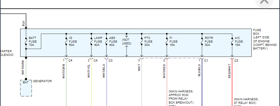

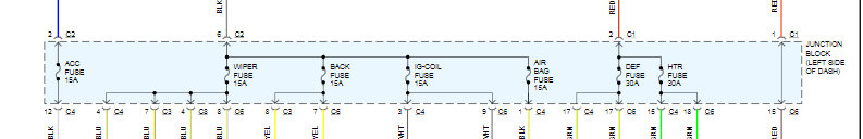

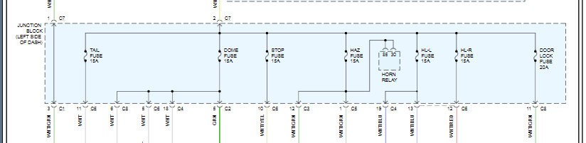

Sorry. I didn't notice that but they do not have a junction box diagram with fuse sizes so I attached the wiring diagram that shows the fuses with the amp reading for each. I also attached the underhood fuse box.
Oct 15, 2020 at 7:57 PM
