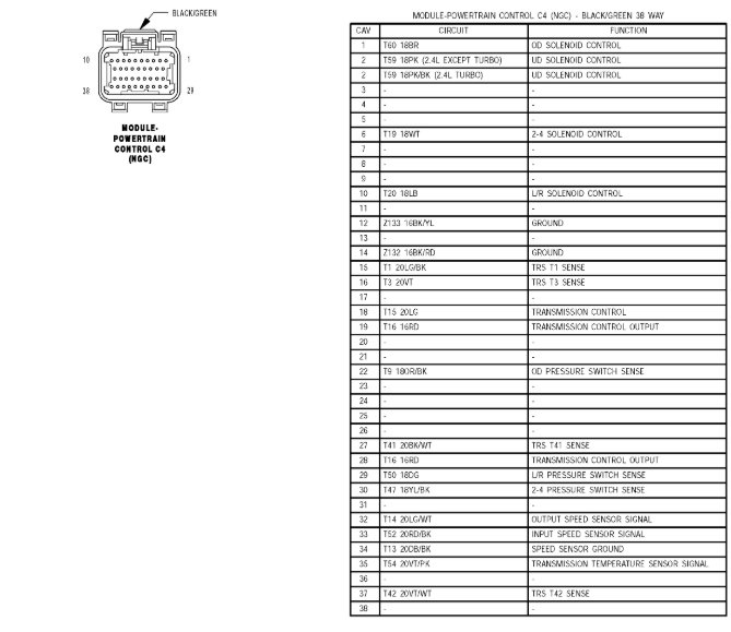

Need to find the fuse for a transmission control module.

Good afternoon,
The transmission control module is part of the engine control module.
Does the engine run?
Is the check engine light on? if it is, do you know the code?
I will attach a connector diagram for the ECM that has the controls for the transmission.
