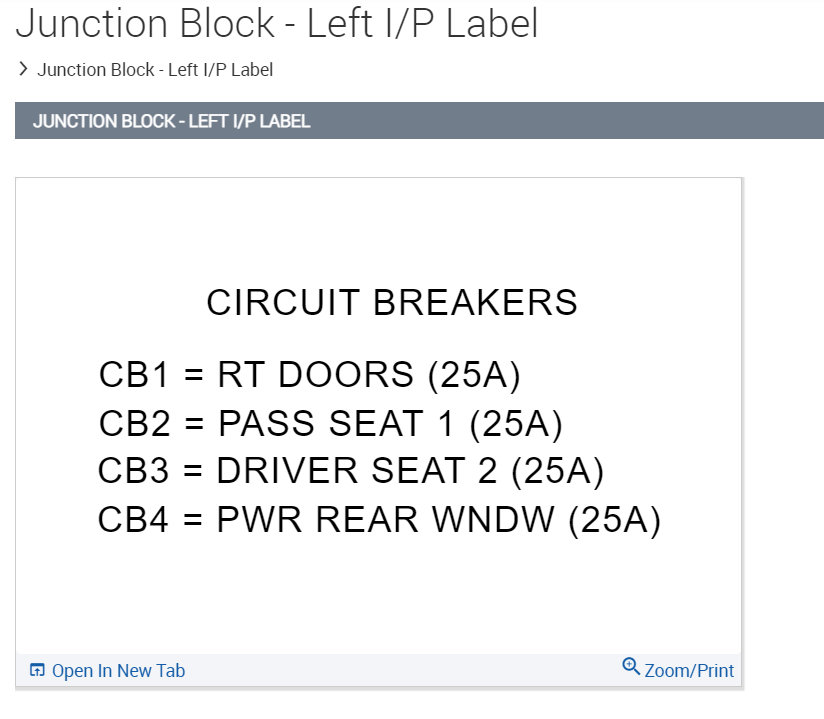

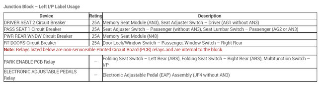

It is the "pass seat 1 circuit breaker" in the left end of the dash fuse panel. here is a guide to help check for power and the fuse location in the diagrams below. Also found the seat motor wiring diagrams so you can see how the system works.
