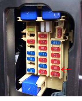

There are some conflicting information for that fuse location. But it should be on the fuse box at the left side of the dash (where the door meets the dash)
It should be a 10A fuse.
The fuse cover will have diagrams showing each fuse function.
See picture below for reference.
Let me know if you have any questions.
Thank you

Thank you for your quick response. Unfortunately, the fuse is good, so I am guessing the pump is defective. Have appt to take it in Wednesday.
