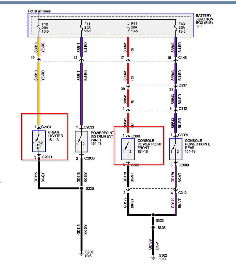

I don’t know the location of the fuse for the 12 V auxiliary plug and cigarette lighter plug. I think the fuse to both ports are blown and I need to know the location number to the fuses.
Aug 12, 2020 at 6:15 PM

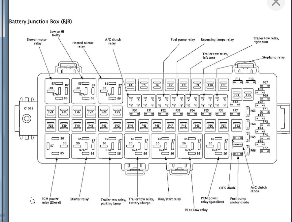

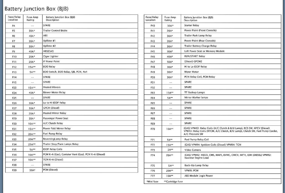

It appears this is F10 and F41 in the battery junction block. I attached this info. Let me know if you have questions. Check out the diagrams (Below). Please let us know what you find. Thanks
