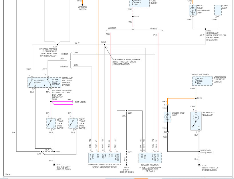

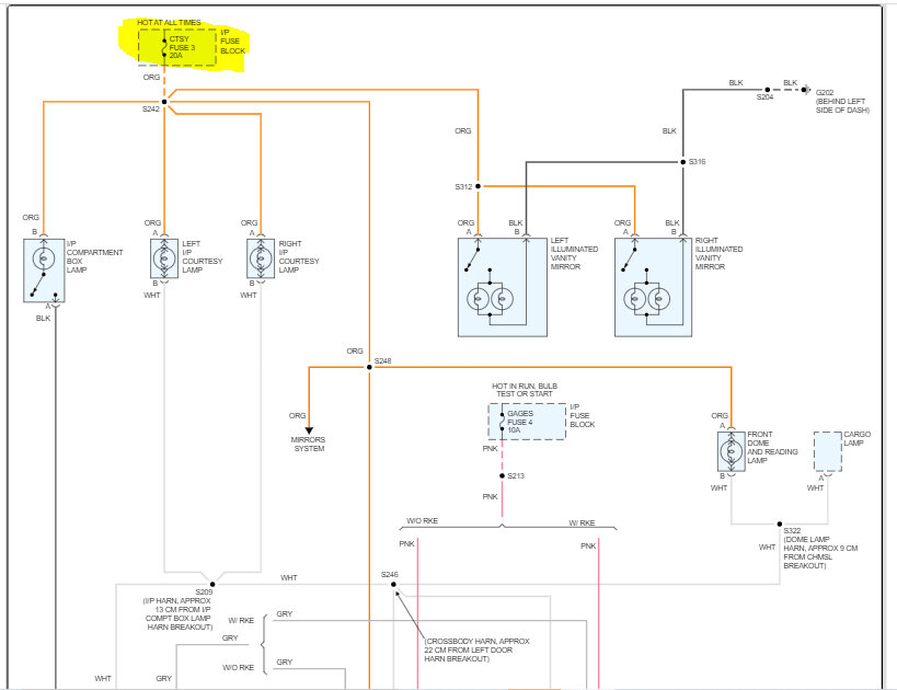

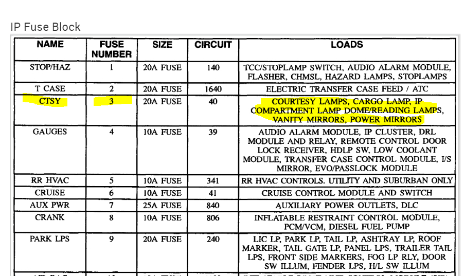

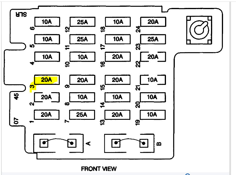

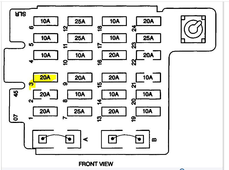

The fuse for the interior courtesy lamps is in the instrument panel fuse box. It will be fuse 3 in the box. If you look at the last two pics below, I highlighted the fuse and highlighted everything it powers.

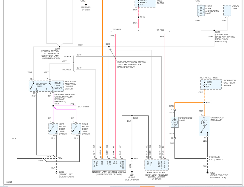

I attached the wiring schematic for the circuit as well so that you have a reference.,
If you check the fuse and it appears good, confirm it has power to and from it.
See pics below.
