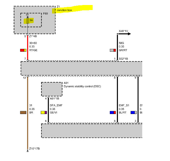

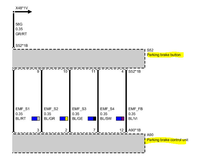

Hi:
I attached two pics below. They are a side by side view. I highlighted the fuse.
What noise are you hearing and can you tell where it is coming from? It sounds like someone damaged the worm gear in the PB actuator. Also, can you provide me with P codes? I not finding any of the ones listed above under the manufacturer's code list.

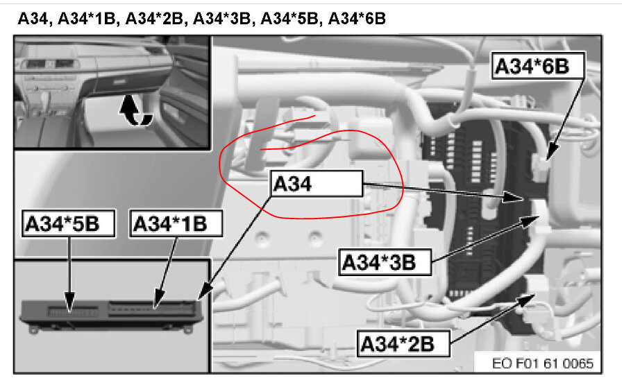

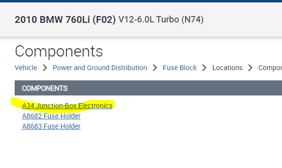

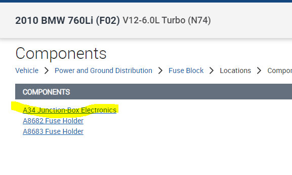

Where exactly are they located, is it in! He front fuse box, rear or where exactly?
Feb 27, 2024 at 7:55 PM
I attached what the manual is showing me. Let me know if it helps.
See pics below.
