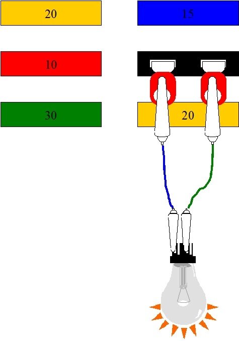

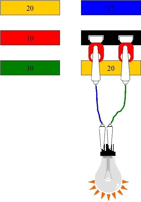

I will be looking for a wiring diagram shortly, but in the meantime, a way to find a short without burning through dozens of fuses is to replace the blown fuse with a pair of spade terminals, then use small jumper wires to connect them to a twelve volt light bulb. A brake light bulb works well. When the circuit is live and the short is present, the bulb will be full brightness and hot so be sure it is not laying on the carpet or against a plastic door panel. Now you can unplug electrical connectors and move things around to see what makes the short go away. When it does, the bulb will get dim or go out.

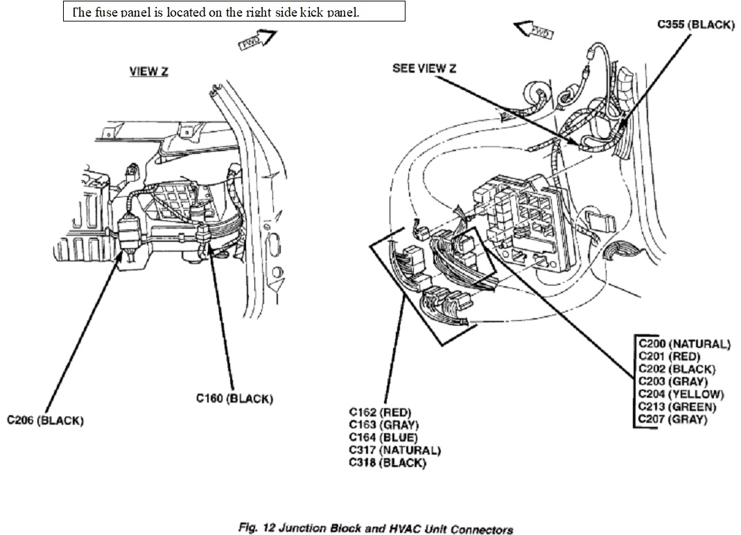

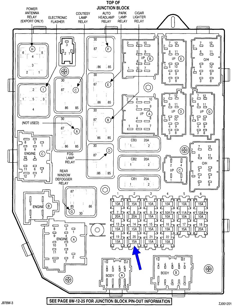

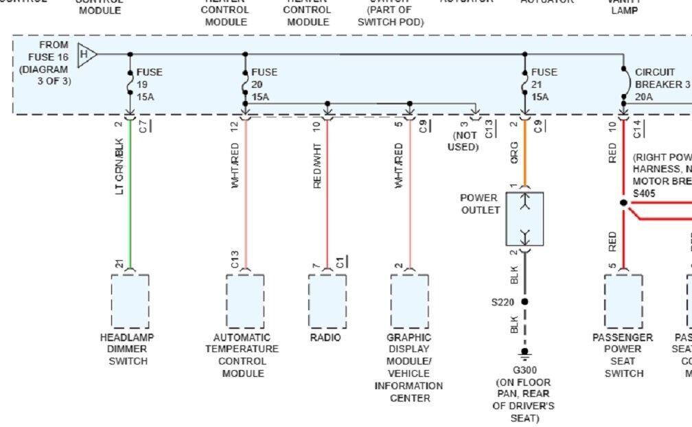

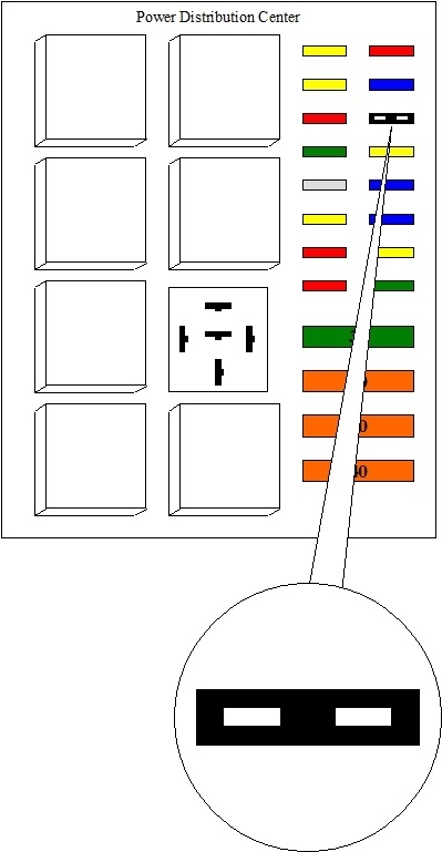

First let me verify I'm in the right fuse box. The first drawing shows the location of the Junction Block, down by the right kick panel. If that is correct, verify I'm looking at the right fuse, # 20, a 15-amp as you said. That's in the second drawing.
The third diagram is an expanded section that includes fuse # 20 and the three things it feeds, which you also already found. There are two 12-volt feeds to the radio, one switched with the ignition switch, and this one that's for the clock and station preset memories. My experience at the Chrysler / Dodge dealership and with years of repairing their radios, is that memory circuit has almost always been tied in with the interior lamps circuit as that also always stays powered up. According to this diagram, your interior lights are on a totally different fuse and circuit. Please verify your interior lights still work to avoid confusion on my part.
If you have the original radio and it works properly, that should not cause this fuse to blow. If it doesn't work properly, unplug the gray 7-pin connector. The other two modules are likely to also have two 12-volt feeds. If you have them out already, just unplug all their connectors for now.
I don't see any reference to this fuse feeding anything else, so if the fuse still blows, it is likely to be due to a grounded wire or, given the sad location of the Junction Block, corrosion build-up from road salt.

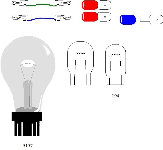

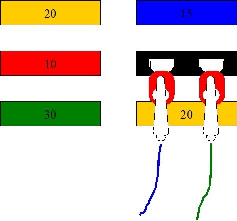

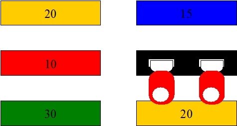

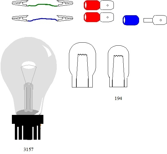

Next, I'm including drawings that show how to connect the bulb to replace the fuse. This is very basic and is intended for anyone else researching this topic. Rather than pick out bits and pieces, posting everything ensures I don't forget or skip over something.
