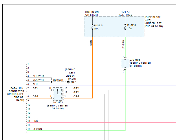

Do you know which fuse is for ODB-2 for the vehicle listed above because the scanner couldn't read anything? I want to check if it is blown.

Yep, we can help, here is a video to help and the fuse locations in the images below:
https://www.youtube.com/watch?v=6Tlg3JmgNSQ
Here is how to check the fuse:
There are two fuses of the data port, fuse# 5 and 8 in the fuse panel under the left side of the dash.
Image (Click to enlarge)
