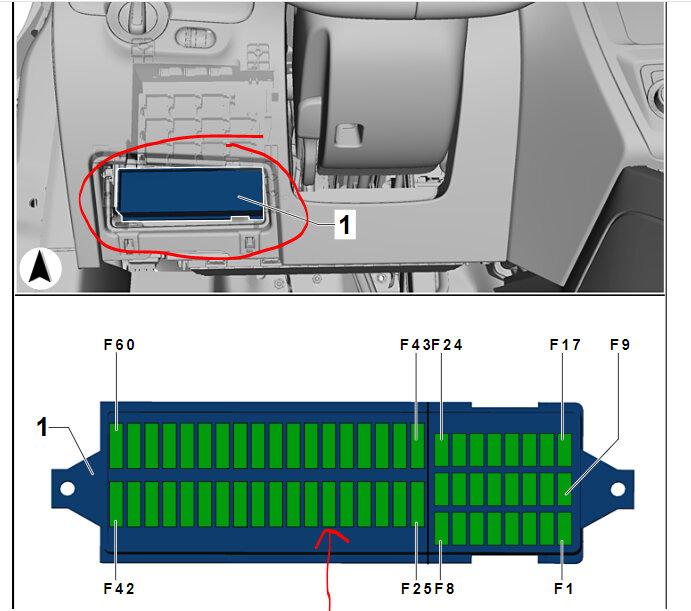

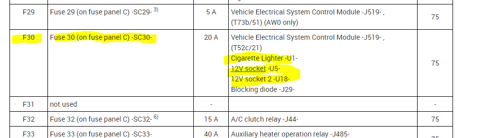

The fuse for the cigar lighter and power ports is located inside the vehicle on the left of the steering wheel. It is fuse 30.
I attached two pics below to help you locate it.
Let me know if this helps.
See pics below.

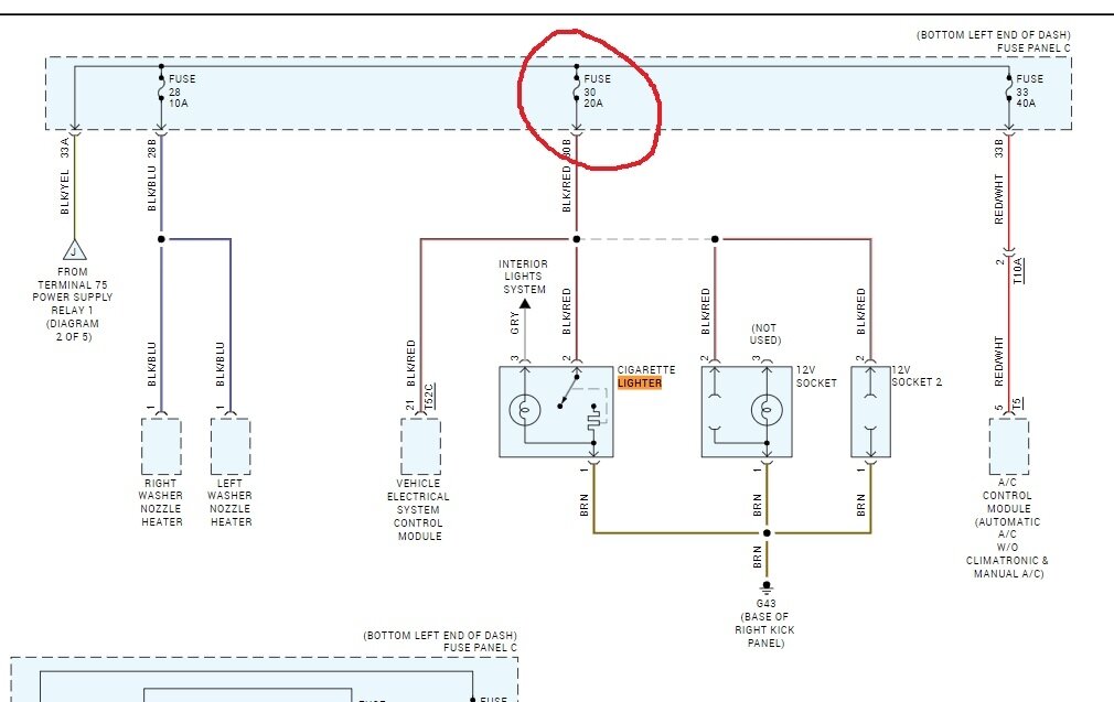

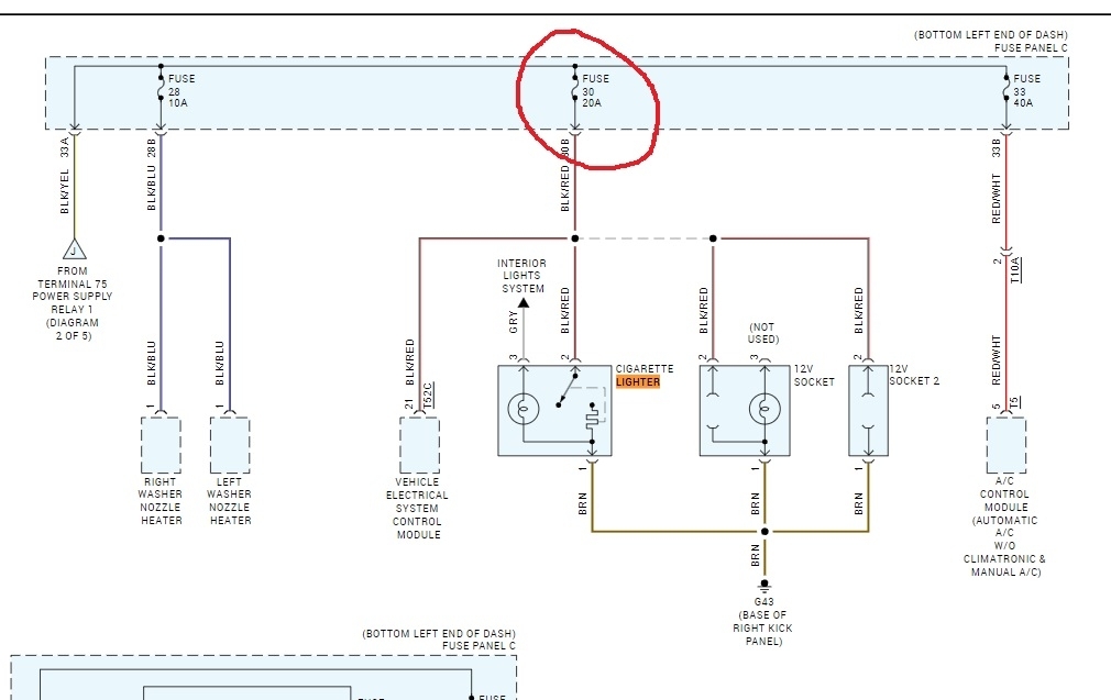

Hello FCARAVEO1940,
Attached is the power distribution diagram showing the fuse you are looking for.
It's located in the fuse panel at the bottom left end of the dashboard.
If the outlet isn't working, for sure check that out.
If you are putting in a camera system, there may be better options to wire it in so that you still have use of your outlet for other things. Please let us know if we can be of any further assistance!
