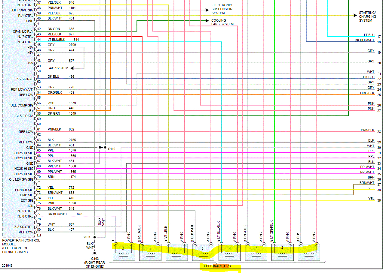

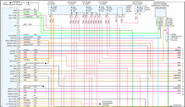

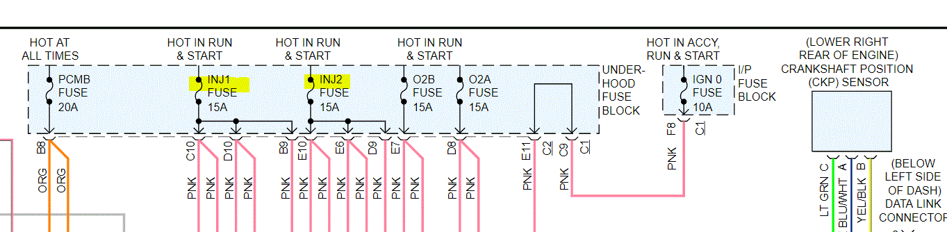

Okay, no problem. Can you tell me which fuse is blowing? If you look at pic 2, I highlighted two fuses. Pics 2 and 3 are a very small portion of the powertrain management. That is why I'm trying to narrow it down.
Interestingly, the injector fuses are hot at all times. Does the fuse blow as soon as you install a fuse or does the key need turned on?
If it blows as soon as it's plugged in, try disconnecting one injector at a time to see if there is one that prevents it from blowing.
Jul 25, 2021 at 9:42 PM
DAVID TOWNE
  • 10 POSTS
It’s the fuse marked 2*.
