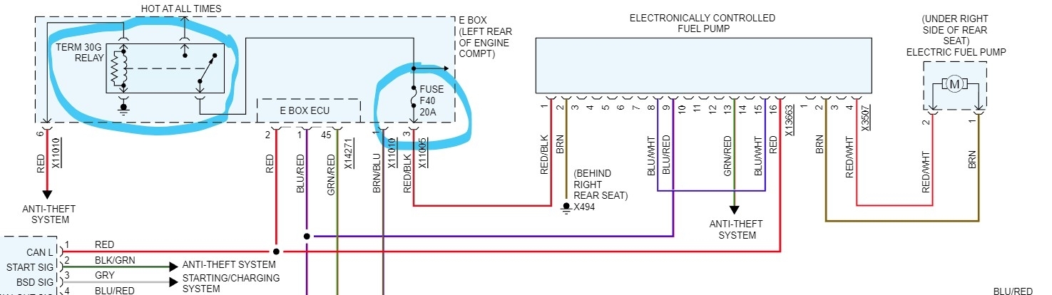

I don't have a picture fuse diagram for my car. I'm trying to look for fuel pump fuse.

Here is an image showing the fuse number (40) and the box it is in (Ebox, left rear of engine compartment, pump relay is in the same box).
Image (Click to enlarge)
