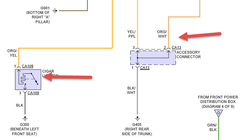

What would cause a direct short to the PJB fuse?
Jul 23, 2017 at 9:25 AM
HMAC300
  • 48,601 POSTS

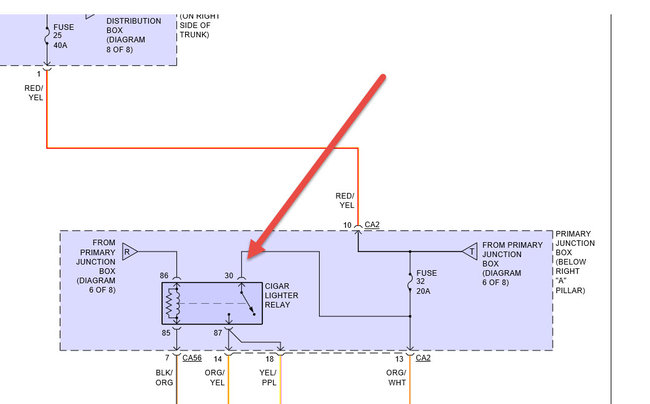

which number is PJB fuse? It can be a wire grounding out or some other problem but need number to trace it. Check items in picture as well as wire shorting out. May be a bad relay or cigar lighter. Or look for change in cigar lighter.
Jul 23, 2017 at 12:03 PM
MAXIMILIAM
  • 436 POSTS
Thanks got figured out. Is was the wire to the amp from the previous owner that is not in use anymore.
