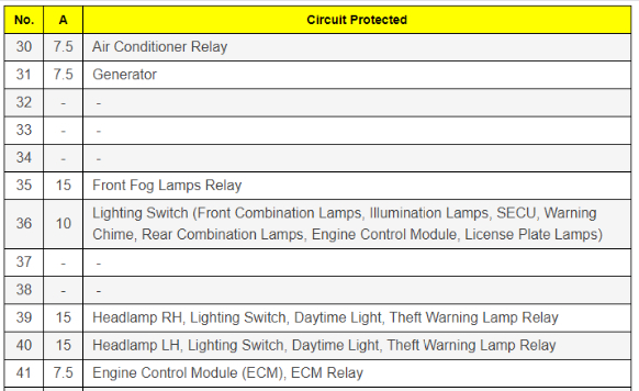

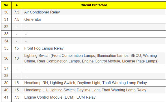

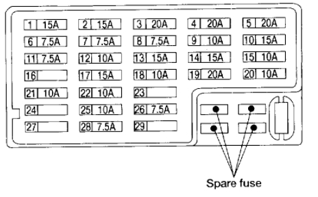

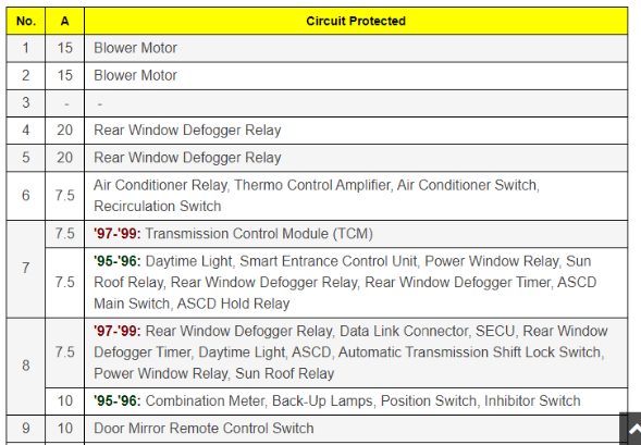

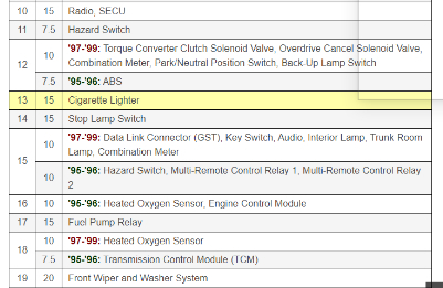

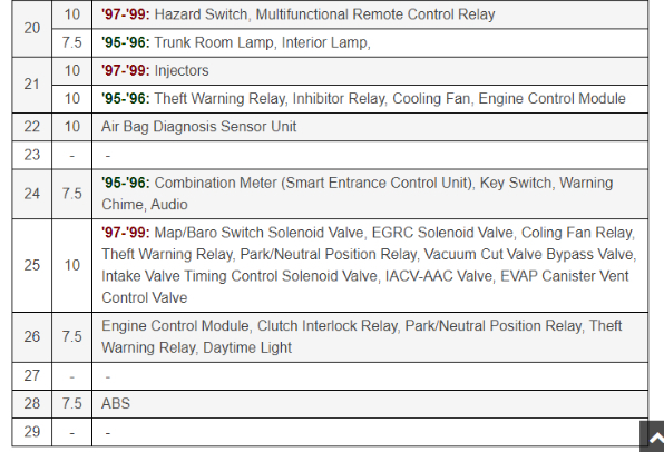

My fuse box near the battery is faded if you can send me the list of fuses and amps for GA16DE automatic 1.6 liter 1998 Sentra GXE.
Mar 11, 2021 at 4:26 PM
I-SMOGEM
CERTIFIED EXPERT
118 POSTS

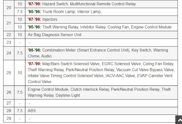

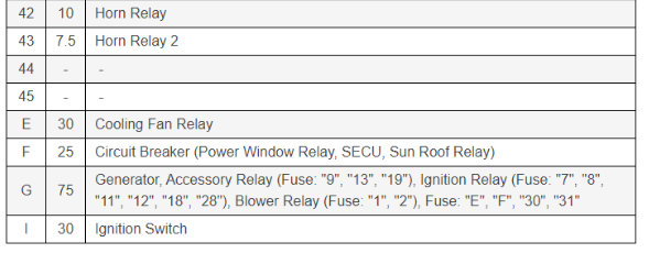

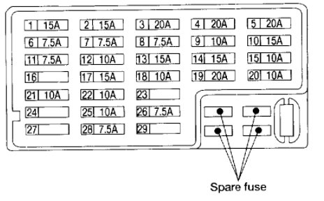

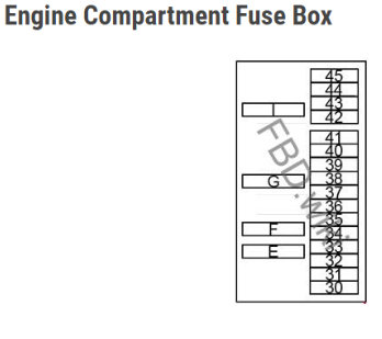

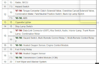

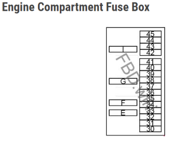

Hey azdanno04,
Below is a pic of the fuse block identifying the fuses by number, and the other pics are the descriptions of what the fuses are for the passenger compartment (just in case you needed them too). The next set are for the requested under hood fuse block.
