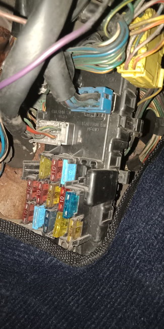

Thank you for helping out. Based on my certificate of registration it does says Mitsubishi Lancer 1989 model. I also took a picture of what my fuse box looks like but there is no cover nor any label to guide what fuse belongs to what.

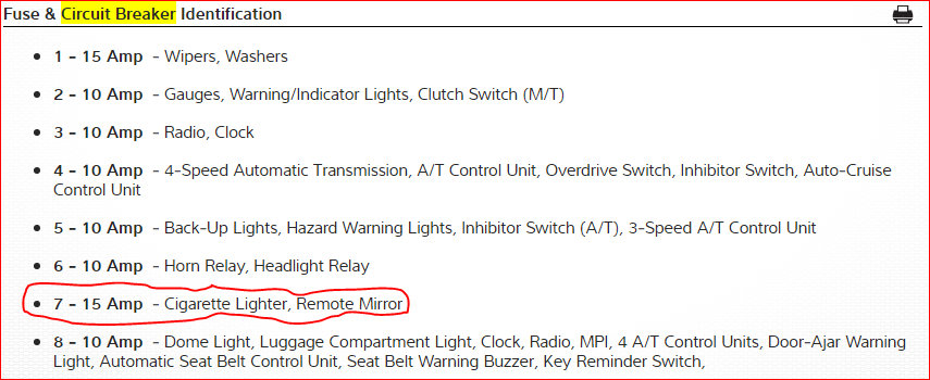

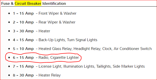

I have attached a few picture as a reference.The first is based on an 1989 Precis which shows fuse for cigarette light as location #6 a 15 AMP fuse. Second picture is based on an 1989 Mirage showing it as location #7 a 15 AMP fuse as well. Hope this helps! Danny-

Thanks for your help Danny. I was able to locate the cigarette lighter although it was a 10 AMP fuse, replaced it with a 10 AMP as well and the lighter was able to work.
