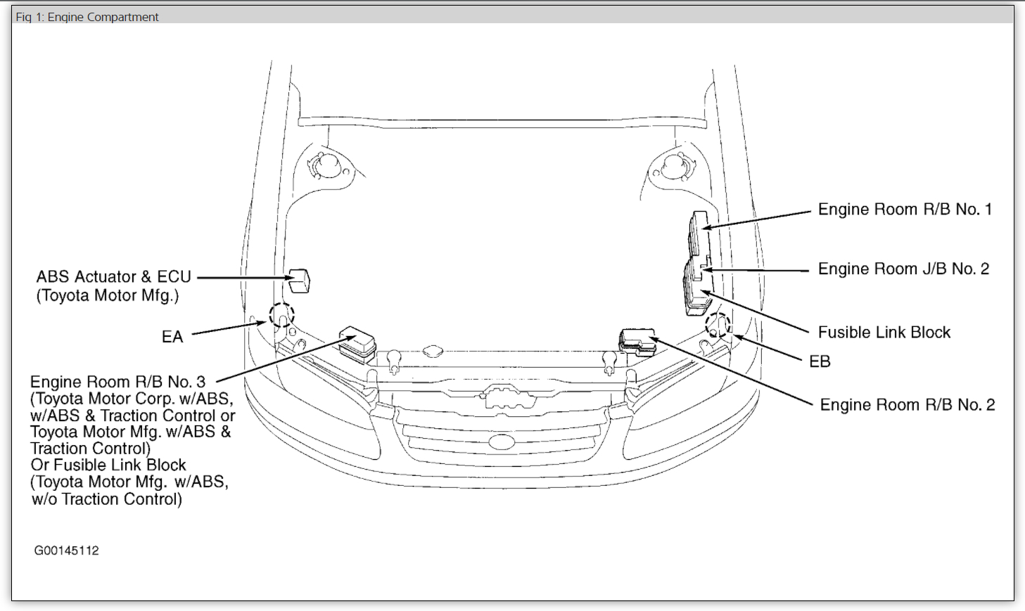

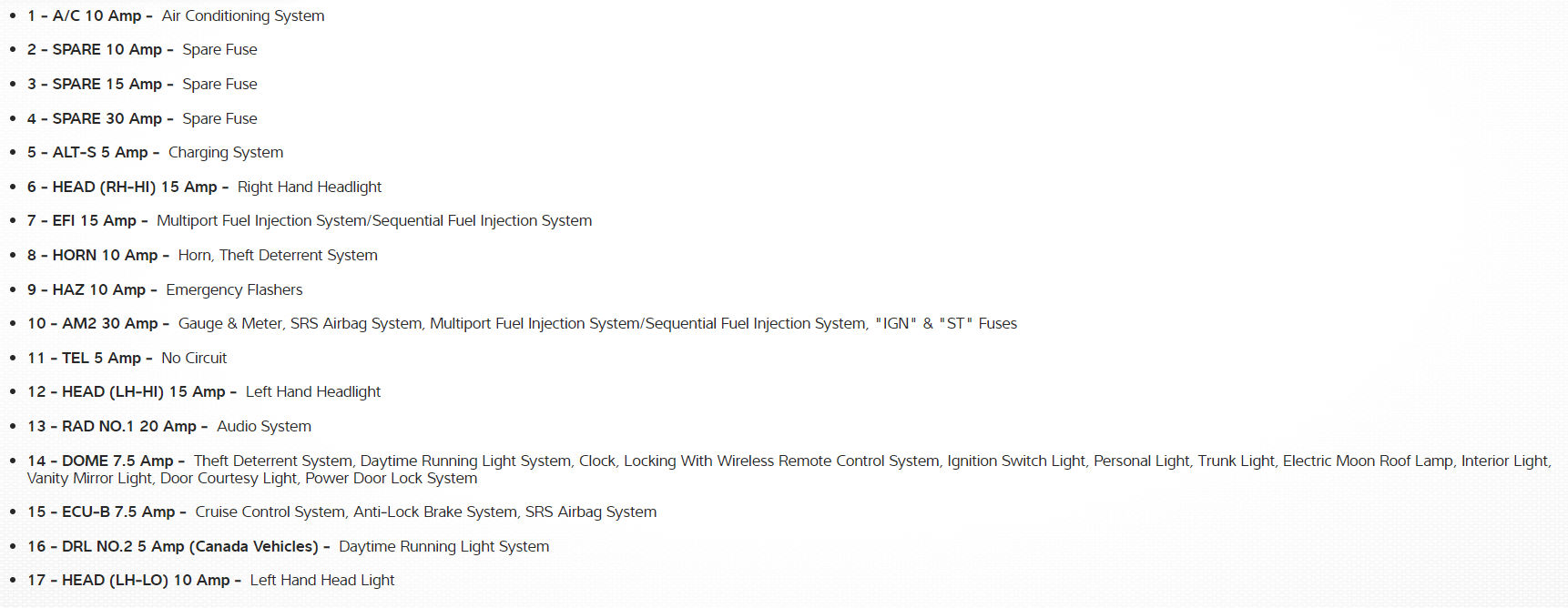

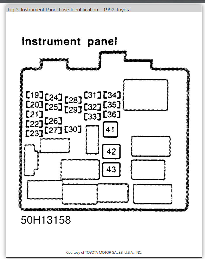

I need the fuse box layout for interior of car.
Sep 10, 2017 at 11:00 PM

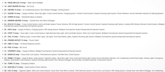

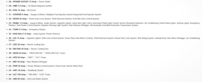

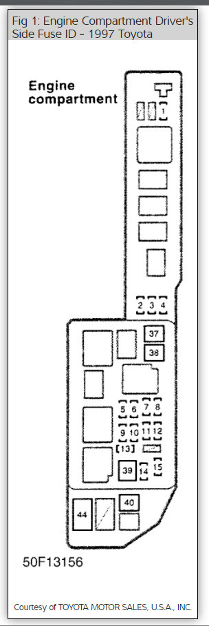

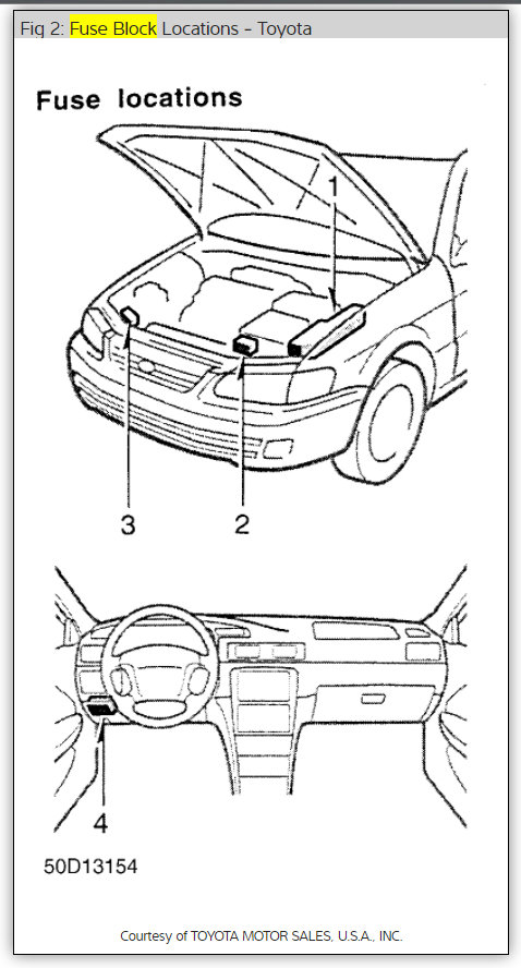

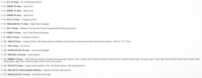

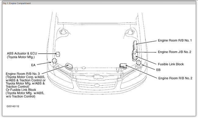

I found these diagrams and a guide to help you find out if the fuses are good or not.
Please let us know what happens so we can keep helping you.
