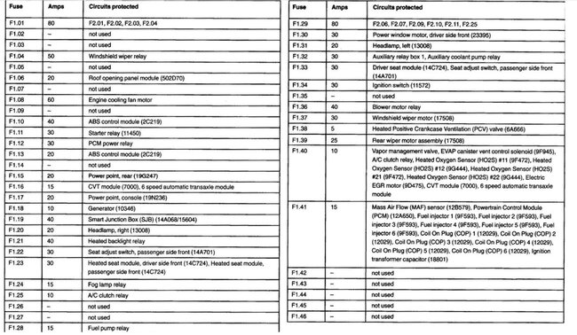

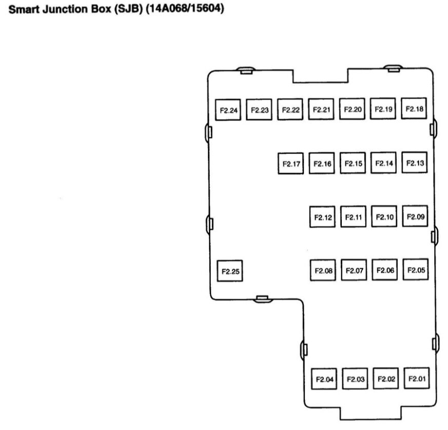

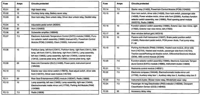

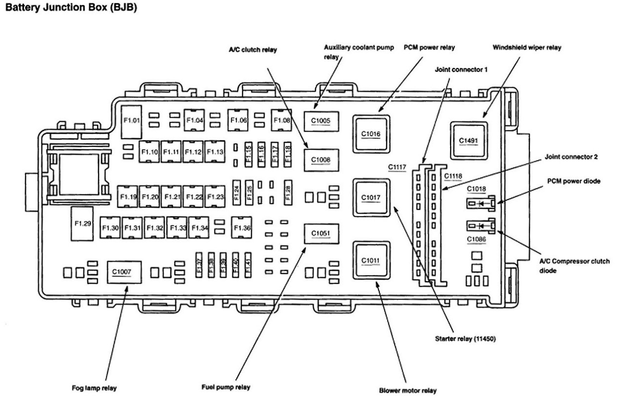

I can't find a fuse diagram for my car listed above. The A/C has stopped blowing cold air completely. I refilled the freon about 2 months ago and it worked great and only driven a couple times. Yesterday there was no cool air, just hot. I topped off the Freon not much gone and still nothing. I'm hoping it's just a fuse but probably not. Any ideas for checking what problem could be? Thanks. oh, yes, the fuse box diagrams for all fuses inside and out would be great.
Sep 2, 2024 at 1:43 PM
It could be the compressor has gone bad, does the compressor clutch kick on when the system is on? Here is a video and a guide to help us fix the problem and I have included the fuse diagrams as well, in the images below.
https://youtu.be/4EqdrBVb0sY?si=XsQkEQQ0uTl28Hv7
Here are the fuses locations as requested. Check out the images (below). Let us know how it goes.

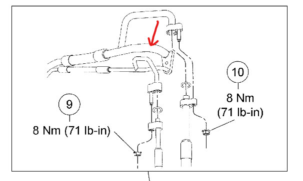

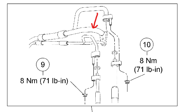

Yes, the clutch does engage.
Sep 2, 2024 at 7:15 PM
Okay, if the clutch engages, please feel the low side tube coming out of the firewall to see if it is cold. If so, you may have a temperature blend door actuator that is not working, and if it is not cold, we will need a high side pressure reading to determine if the compressor is bad. Check out the images (below). Please let us know what happens.
