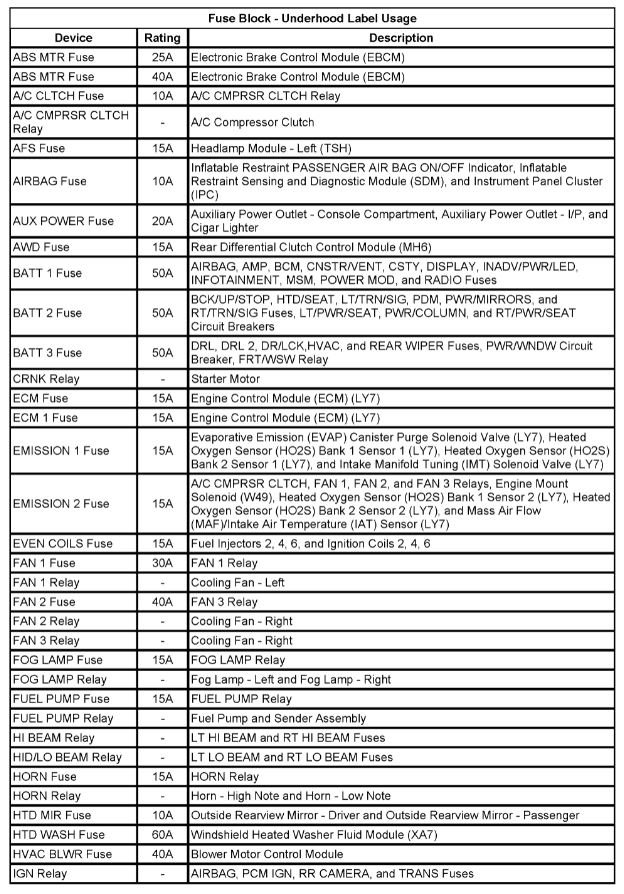

where us fuse box? Do you know does anyone know? I have had no luck with this
May 31, 2021 at 11:39 AM
STEVE W.
CERTIFIED EXPERT
15,113 POSTS

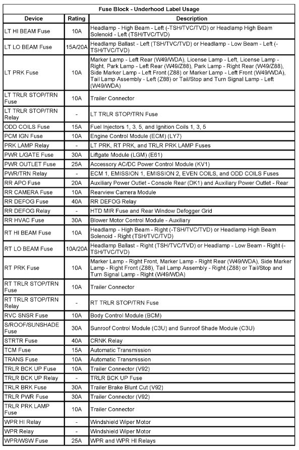

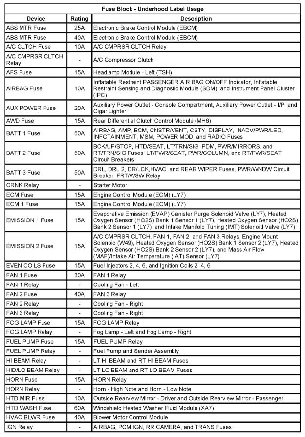

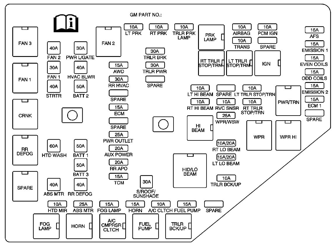

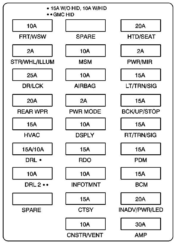

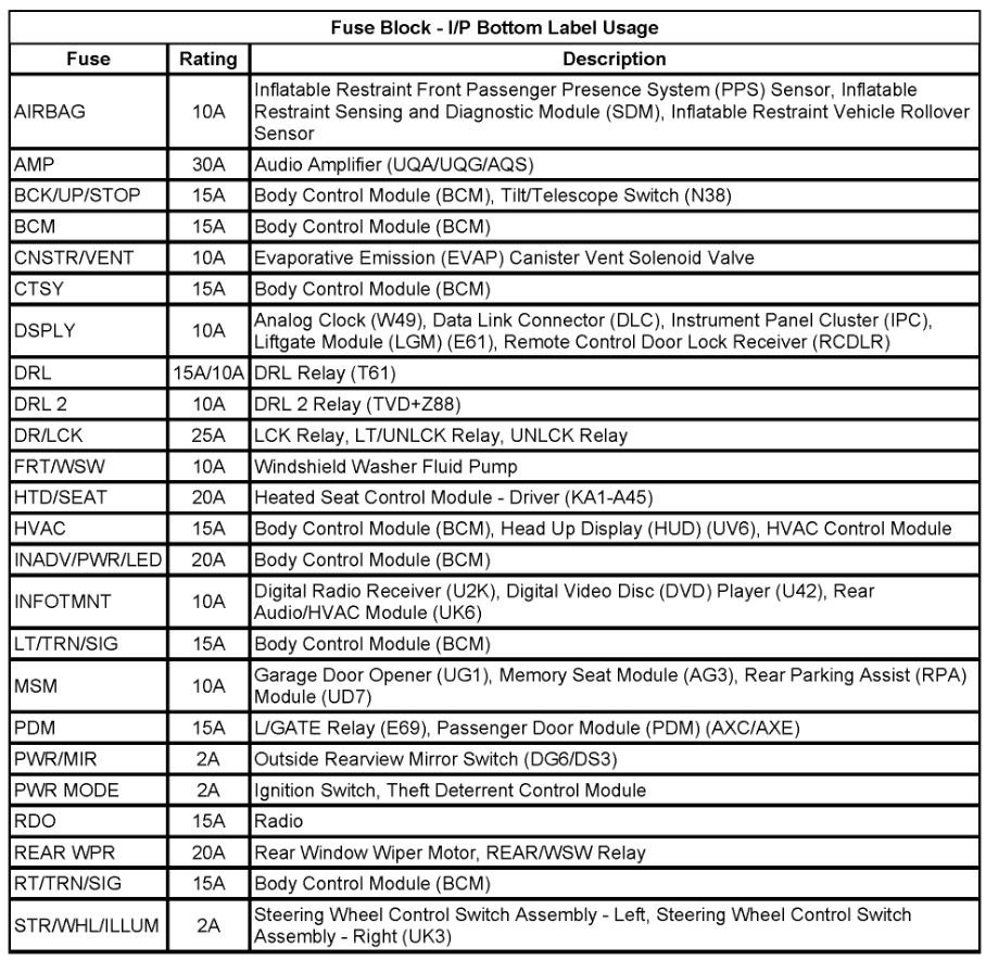

There are two boxes on that vehicle. One is under the hood at the power center and the other is in the passenger side under the instrument panel. Below you will find images of the fuse boxes and what the fuses power.
This will show you ways to test the fuses and circuits. https://www.2carpros.com/articles/how-to-check-a-car-fuse
