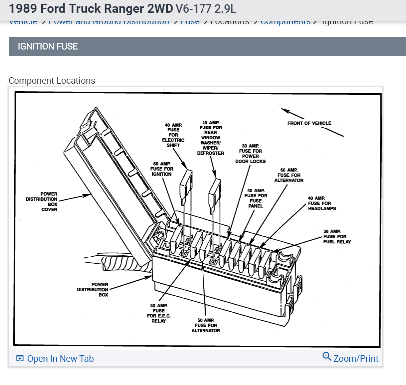

Where is the under-hood Fuse Box located?
1988 FORD RANGER
150,000 MILES • 2.3L • 4 CYL • 2WD • MANUAL
JDHERTTER
I am trying to locate the fuse box under the hood to see if a fuse is what's keeping my truck from starting.
Jul 2, 2022 at 5:36 PM

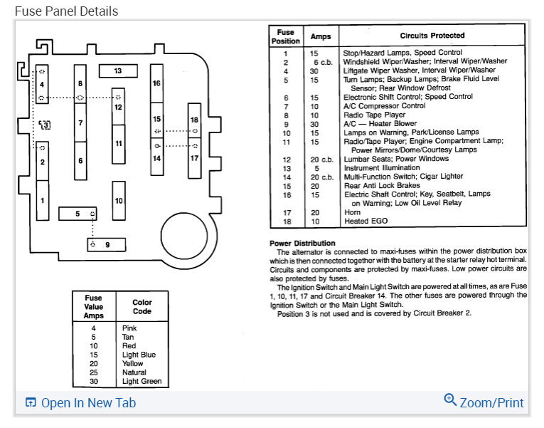

Sure, here is a guide to help you test the fuses and the fuse panel location under the dash and identification:
Check out the diagrams (below). Please let us know if you need anything else to get the problem fixed.
