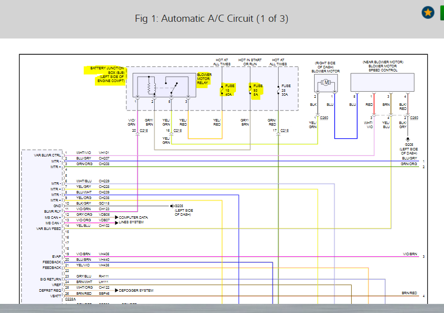

In the diagrams down below I have included the Heating Ventilation and Air Conditioning (HVAC) wiring diagram for you with the blower motor, the fuses that go to the blower motor, and the blower motor relay on it. Please note that I have highlighted the fuses and the relay and there location, which is in the Battery Junction Box on the left side of the engine compartment. Please go through this wiring diagram and get back to us with what you are able to find out.
