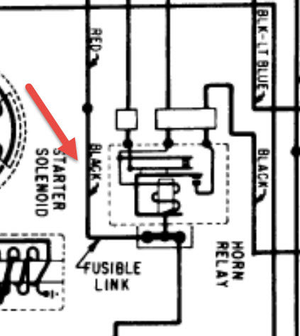

Should I have full time power to battery side of fuse block?
Jul 10, 2016 at 12:37 PM
HMAC300
  • 48,601 POSTS
yes, if you do not you have a problem either with the wiring or connector at firewall. check the fusible link that runs off the relay it is a black wire and turns into red. auto parts have these just make sure to get same size. see picture.
