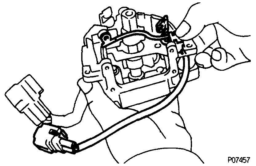

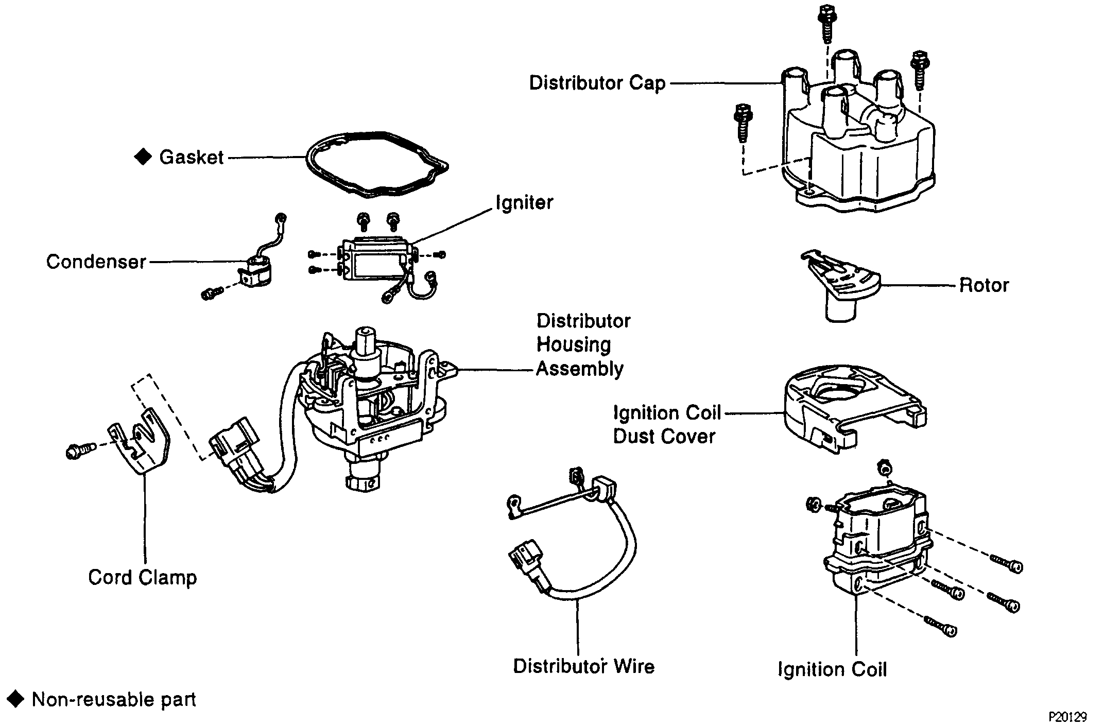

Here are directions for taking the distributor apart. What I suggest is to replace the condenser if you haven't, and make sure none of the wires are shorted in it. Often times, a wire will break internally from constant movement. Take a look through these directions and confirm everything looks good.
DISASSEMBLY AND ASSEMBLY
see pic 1
DISTRIBUTOR DISASSEMBLY
1. REMOVE DISTRIBUTOR CAP.
- Remove the 3 bolts and distributor cap.
2. REMOVE ROTOR.
3. REMOVE IGNITION COIL DUST COVER.
- Remove the dust cover.
- Remove the gasket.
4. REMOVE IGNITION COIL.

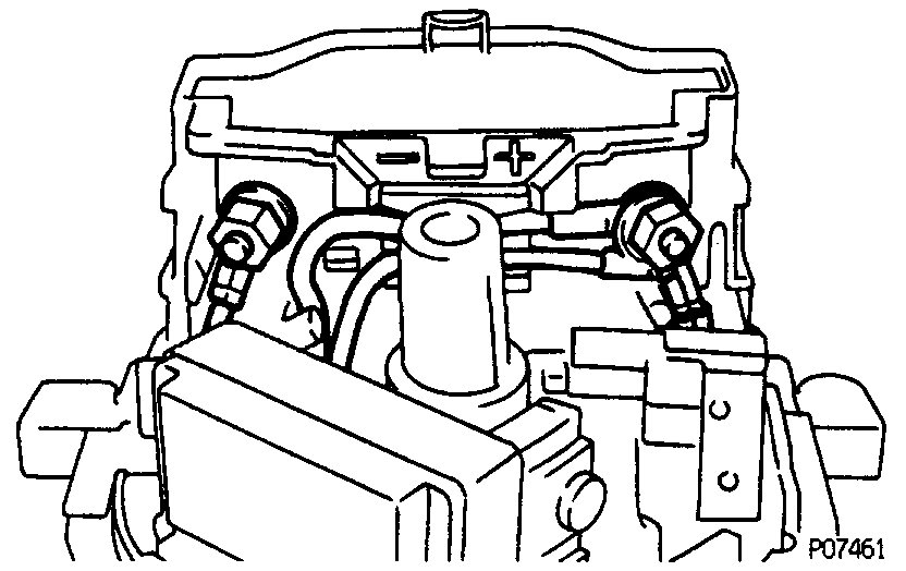

See picture 2

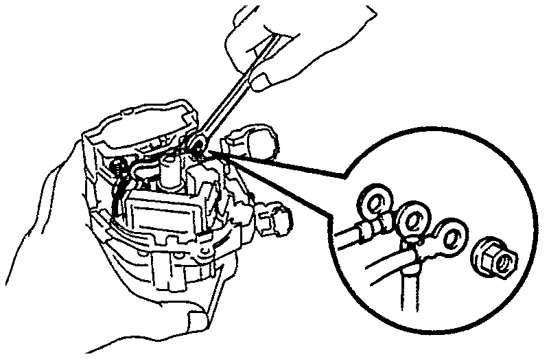

- Remove the 2 nuts, and disconnect the 4 wires from the ignition coil terminals.

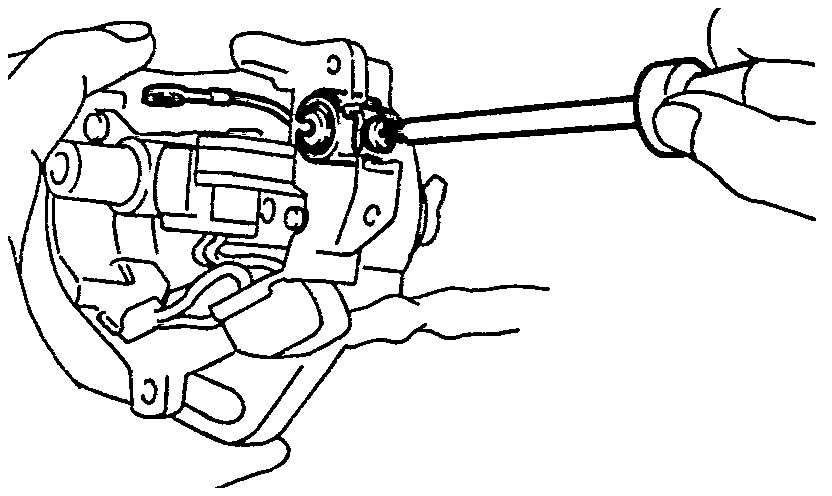

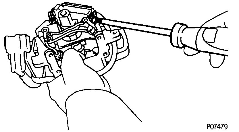

See picture 3
- Remove the 4 screws and ignition coil.

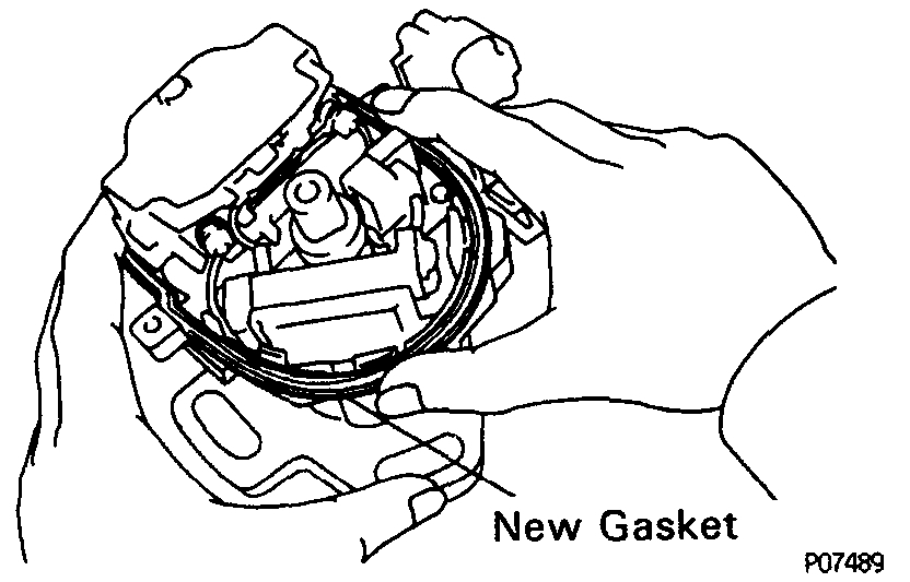

see pic 4
- Remove the 3 screws, and disconnect the 3 wires from the igniter terminals.

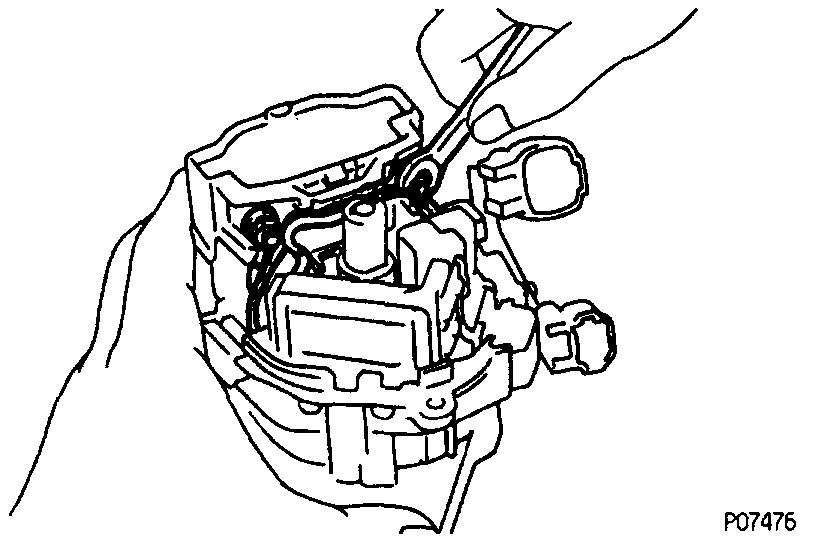

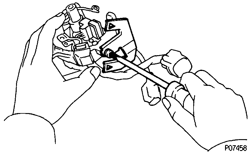

See picture 5
- Remove the 2 screws and igniter.

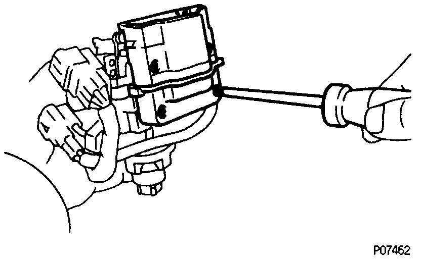

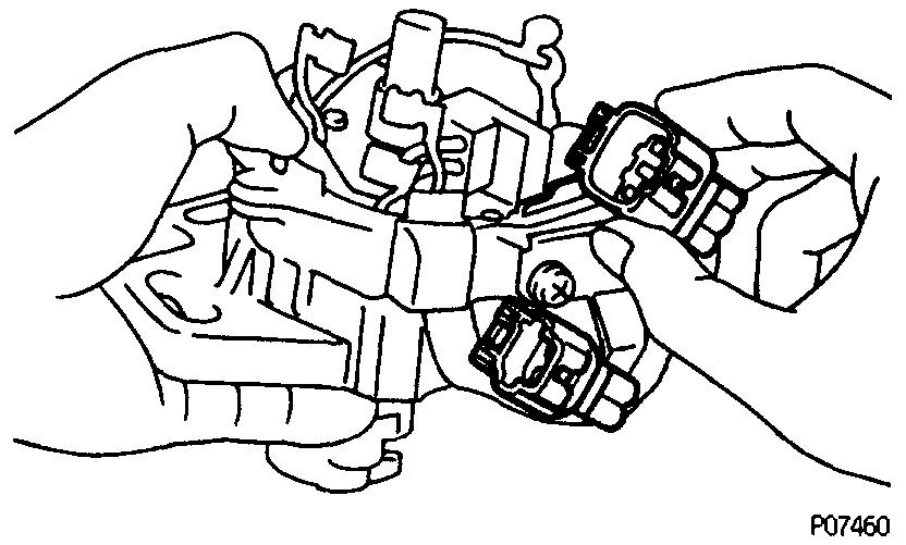

See picture 6
- Disconnect the 2 connectors from the cord clamp.

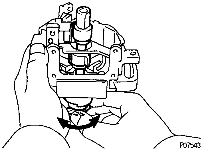

1. INSPECT SHAFT.
See picture 10
- Turn the shaft and check that it is not rough or worn.
- If it feels rough or worn, replace the distributor during assembly.

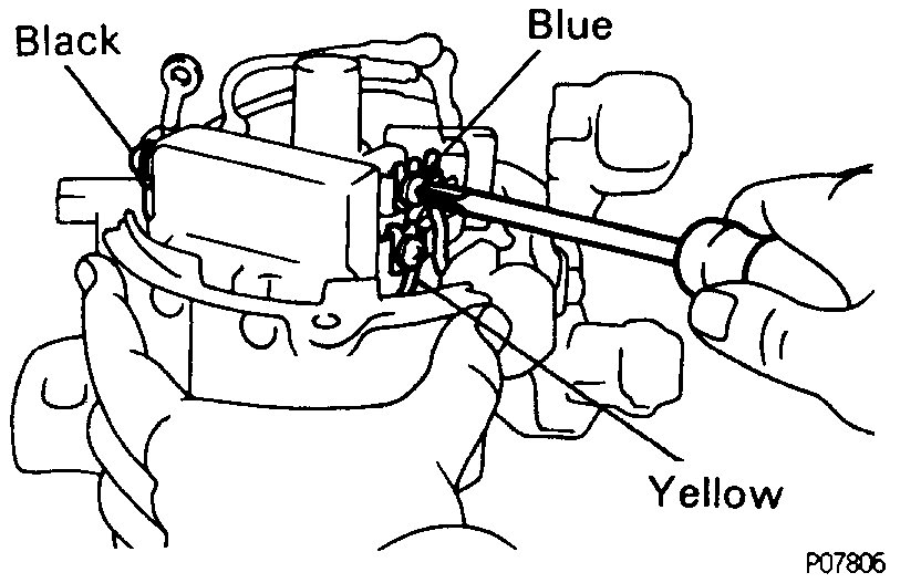

See picture 11
- Connect the 3 wires to the igniter terminals with the 3 screws.

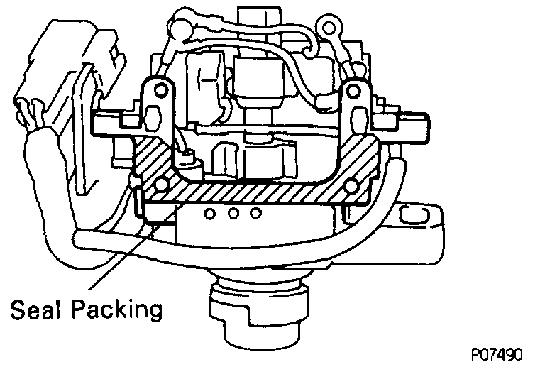

See picture 12
- Apply seal packing to the ignition coil installing surface of the housing as shown in the illustration.
- Seal packing: Part No. 08826-00080 or equivalent

See picture 13
- Connect the 4 wires to the ignition coil terminals with the 2 nuts as shown in the illustration.

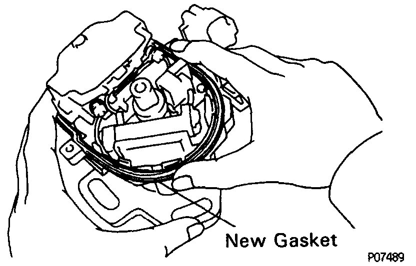

5. INSTALL IGNITION COIL DUST COVER.
See picture 15
- Install a new gasket to the distributor housing.
- Install the dust cover.

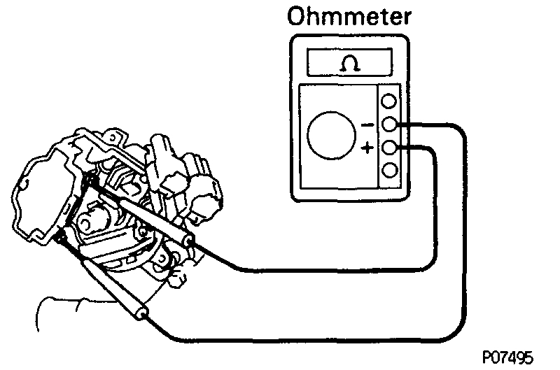

5. INSPECT PRIMARY COIL RESISTANCE.
Picture 1
- Using an ohmmeter, measure the resistance between the positive (+) and negative (-) terminals.
Primary coil resistance (Cold): 1.11 - 1.75 Ohms
Primary coil resistance (Hot): 1.41 - 2.05 Ohms
- If the resistance is not as specified, replace the ignition coil.

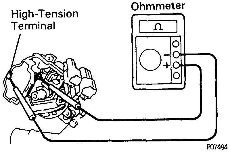

6. INSPECT SECONDARY COIL RESISTANCE.
Picture 2
- Using an ohmmeter, measure the resistance between the positive (+) and high-tension terminals.
Secondary coil resistance (Cold): 9.0 - 16.7 k Ohms
Secondary coil resistance (Hot): 11.4 - 18.4 kOhms
