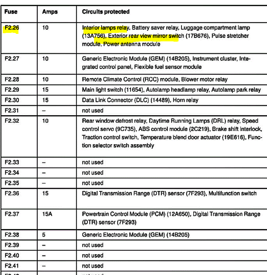

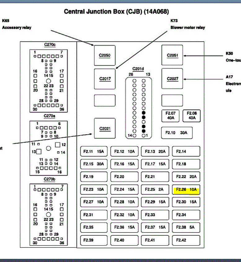

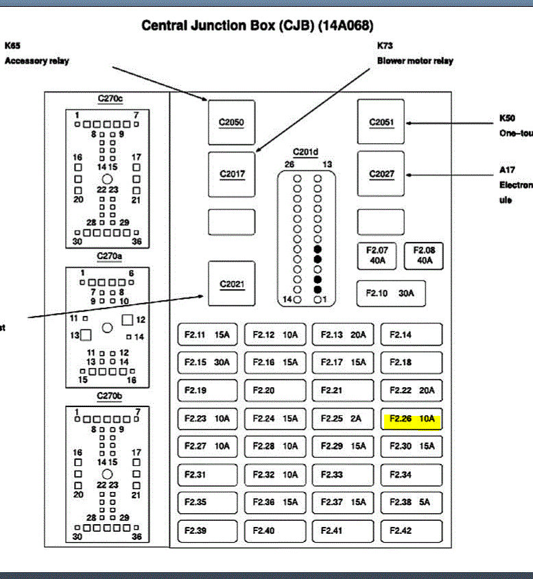

The fuse is located in the central junction box fuse panel. The fuse panel is located below and to the left of the steering wheel by the brake pedal.
I attached two pictures below. The first indicates fuse 2.26 is the one you are looking for. The second shows its location in the fuse box.
