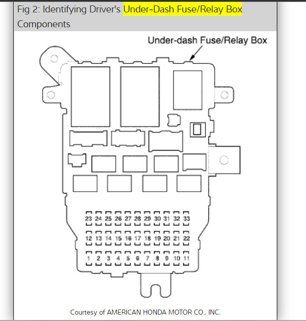

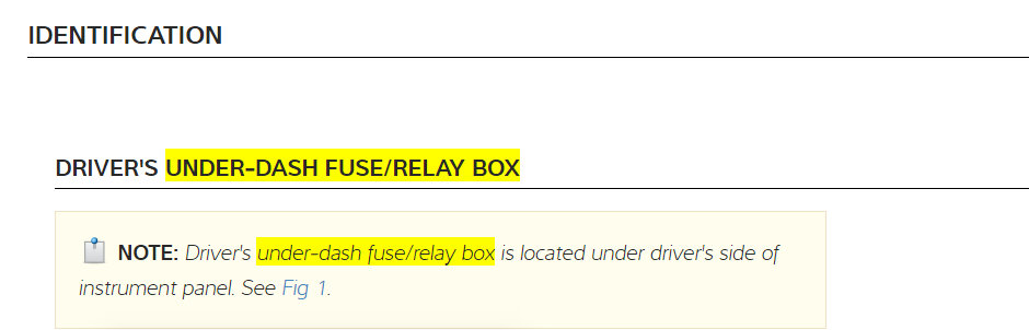

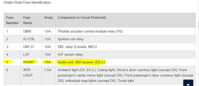

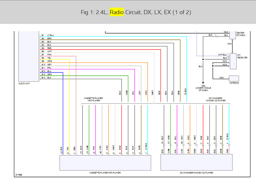

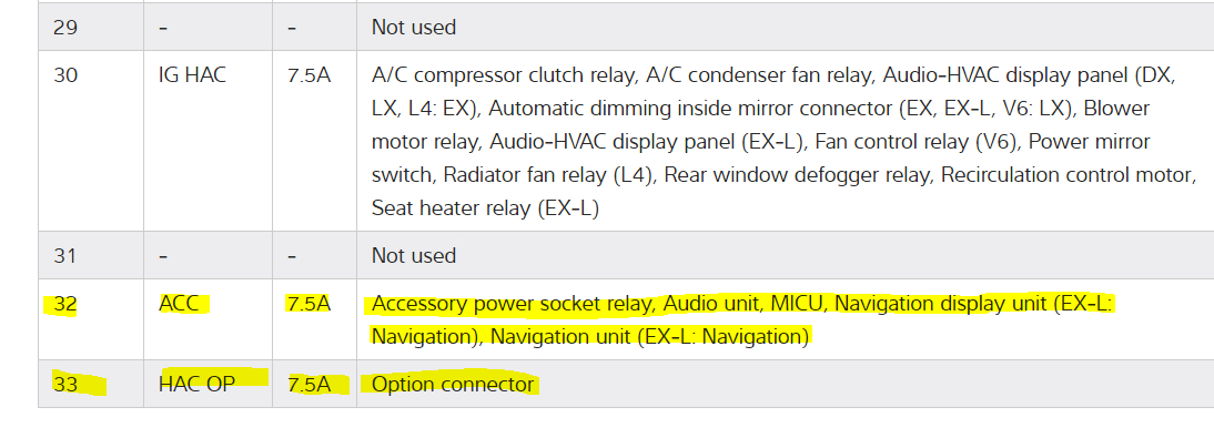

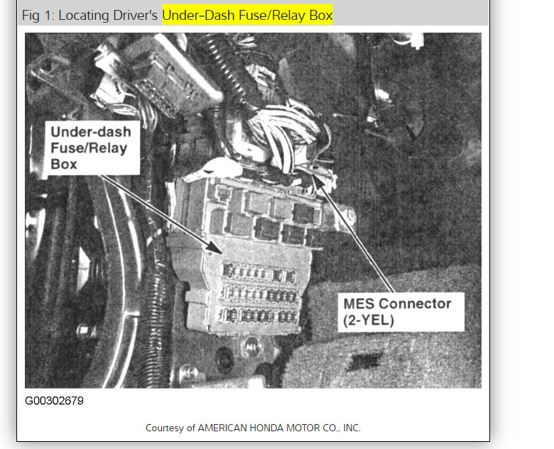

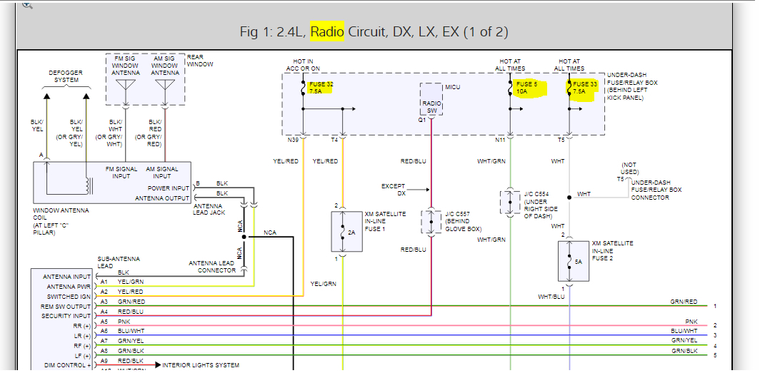

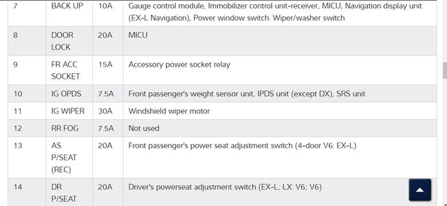

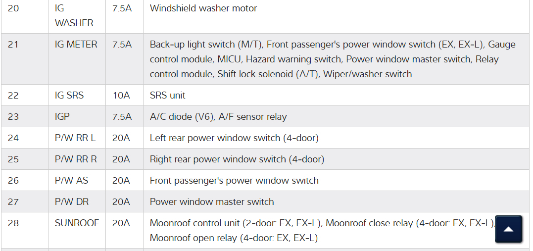

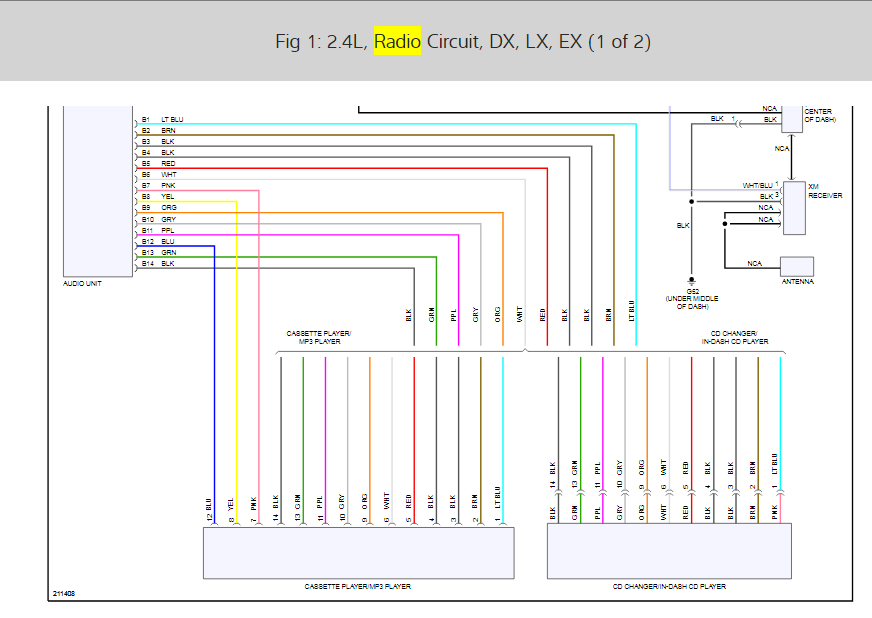

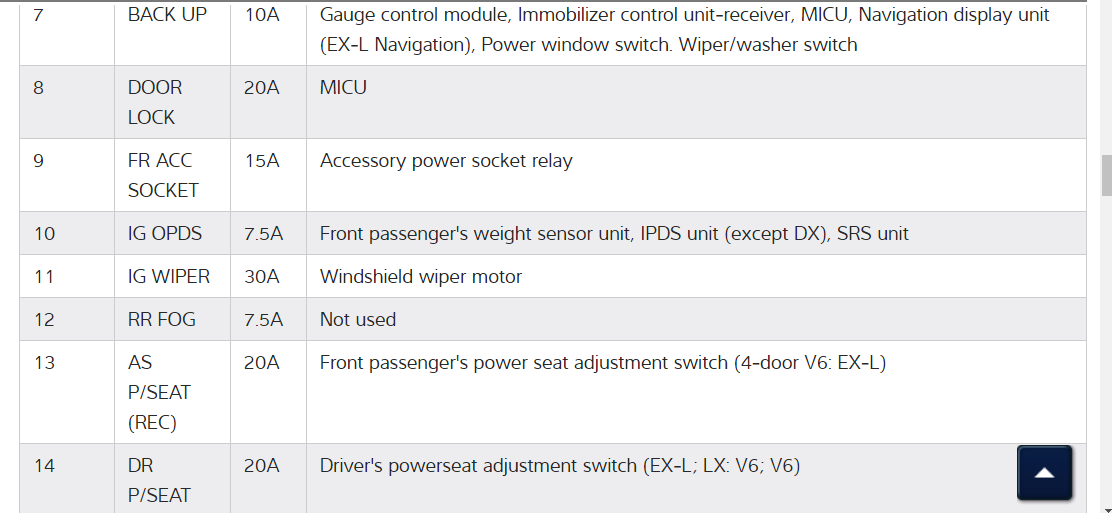

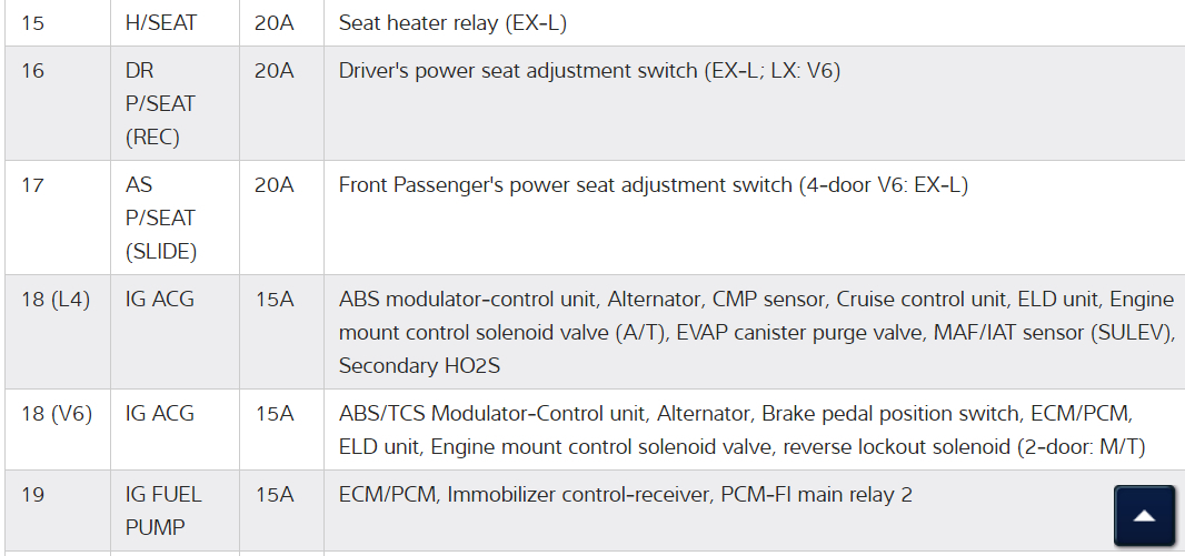

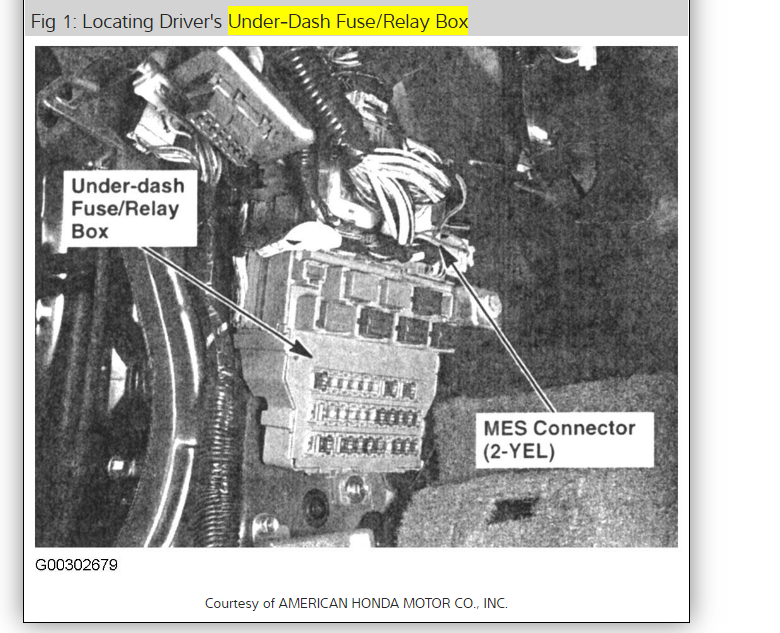

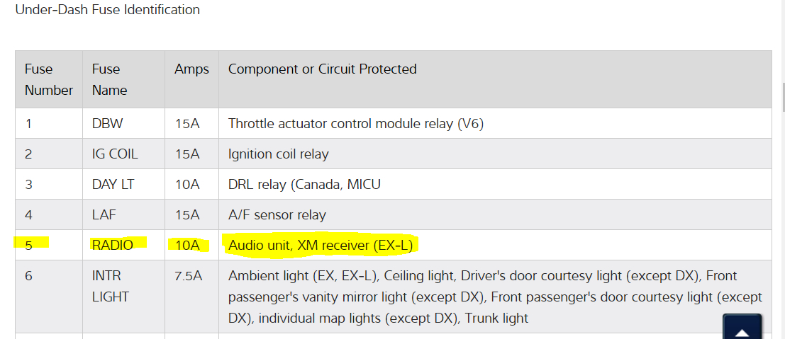

There are 3 fuses that are used in your vehicle's audio system. They are all located in the Under dash Fuse Panel. They are fuse #5,32, and 33. I have included in the diagrams down below a wiring diagram of your vehicle's radio CD/changer unit, and a diagram and callout of the Under dash Fuse Panel. Please go through this guide and get back to us with what you are able to find out.
