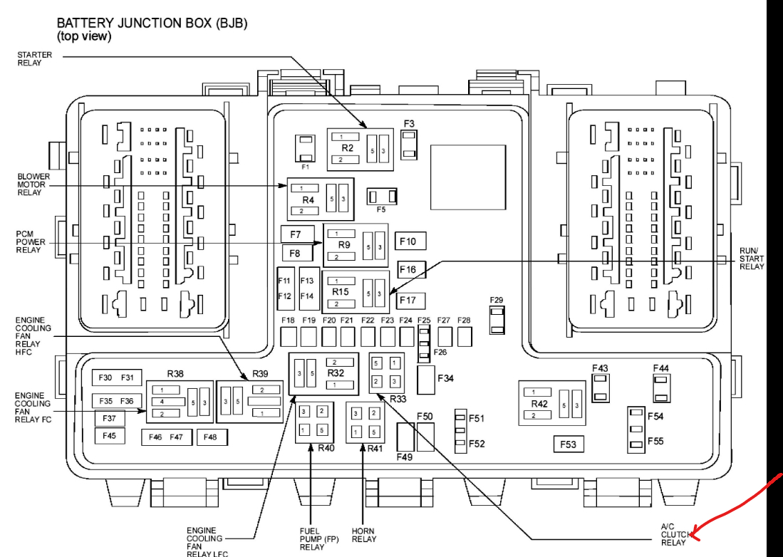

There is an A/C clutch relay that I would swap out, here is the location. Check out the images (below). Please let us know how it goes.

Thank you, sir. Monday I will get a new relay and drop that in there and cross my fingers that's it. I have seen also the evap sensor and its smart location Ford put it that the relay does it. Let you know how goes.
