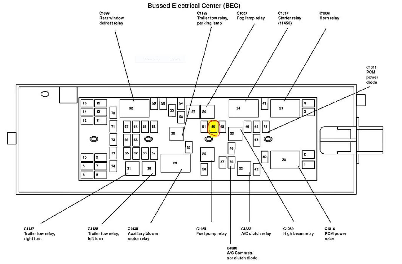

location of computer module fuse location. I want to reset computer.

The main fuse is located in the electrical center under the hood. Fuse number 49. However if you are trying to erase codes or similar it may not work depending on the problem.
