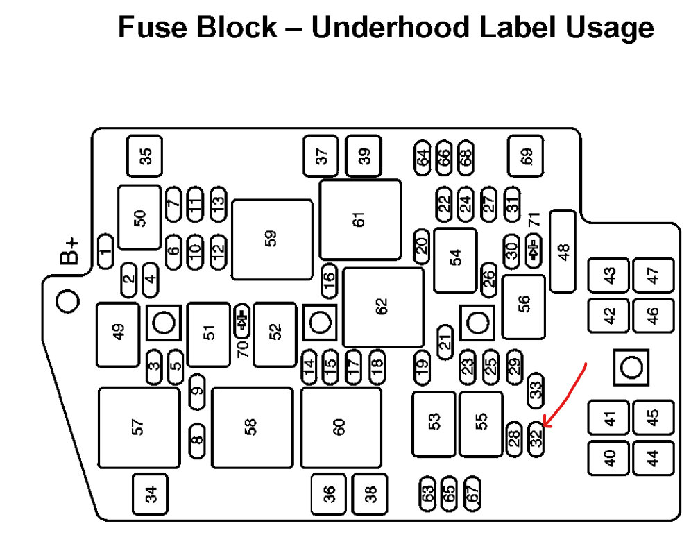

What fuse number to get the lighter working again?
Jul 13, 2025 at 4:52 PM
CERTIFIED EXPERT
53,854 POSTS
Hello Lore,
Sure, the cigarette lighter fuse is under the hood near the battery fuse panel, it is the fuse #32 FRT AUX here is the location in the images below. Let us know if you need anything else.
