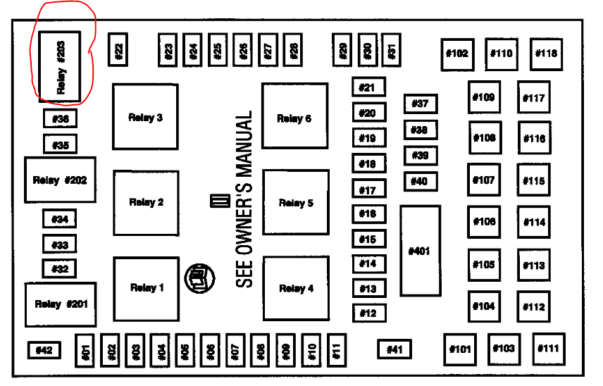

Drove to work in the morning fine. Started vehicle in the hot afternoon and the overdrive light was blinking, vehicle went into limp mode and ran rough. No recent repairs were done or anything out of the ordinary.

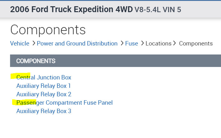

Found out that fuse 32 kept blowing. I was told to unplug everything related to fuse 32 and see if the fuse would still blow. Then plug everything back in one by one and checking if fuse blew.
I haven’t started unplugging anything yet. Wanted to get your input.

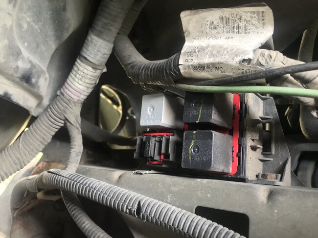

Fuse 32 starts with the catalyst monitor sensors in the photo.
40,000on new engine.
