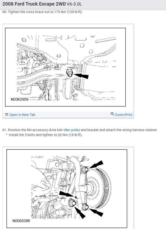

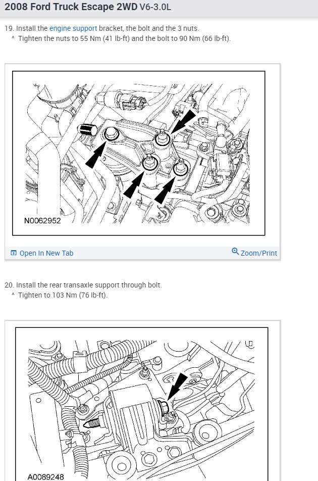

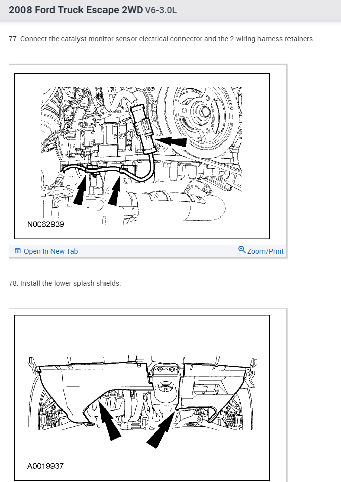

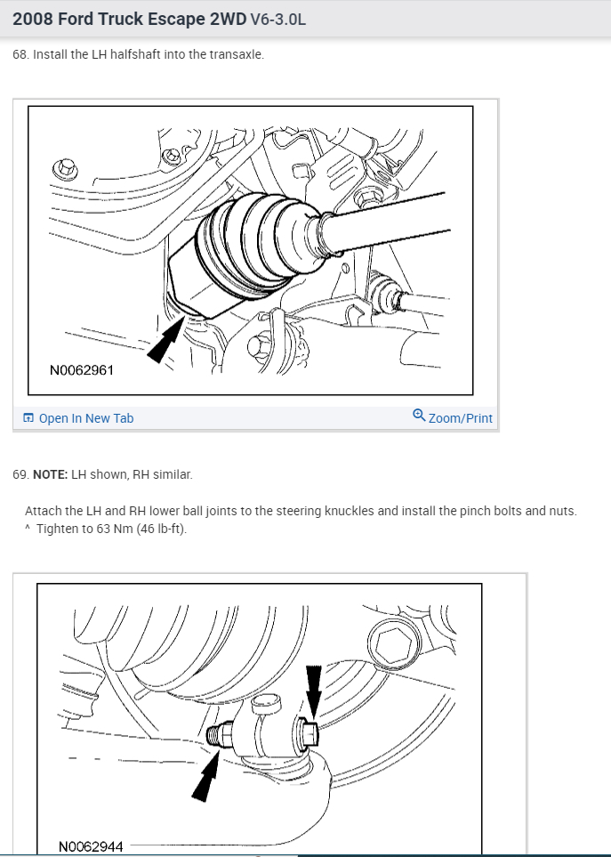

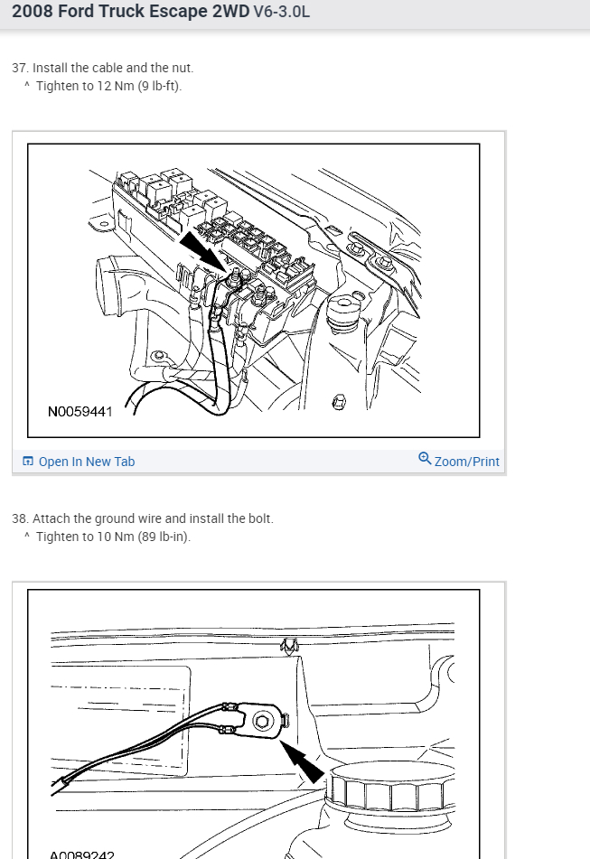

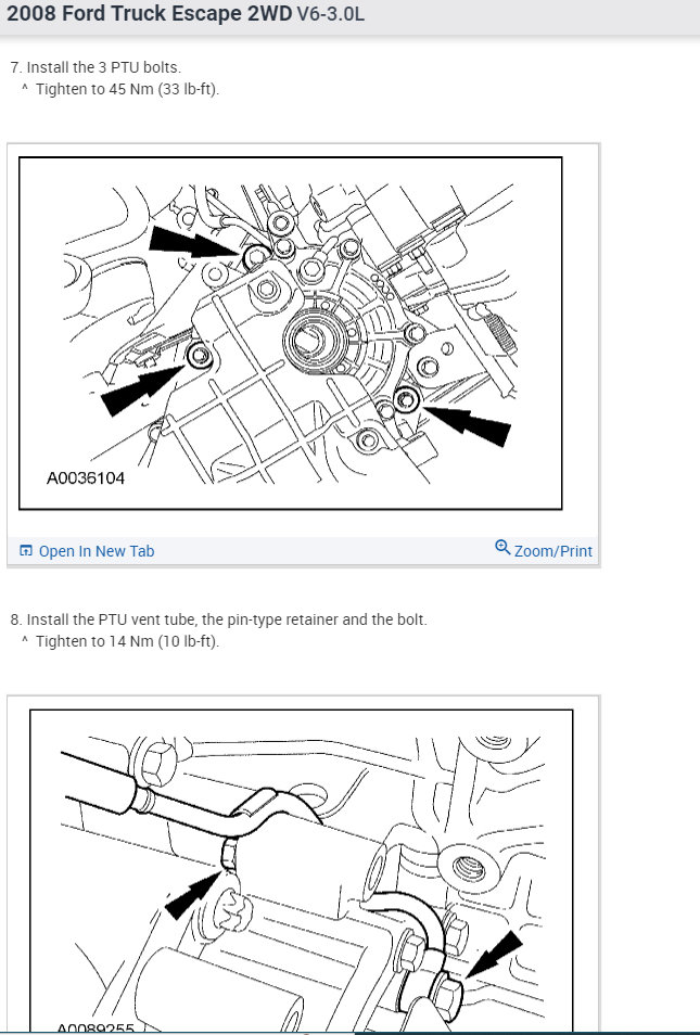

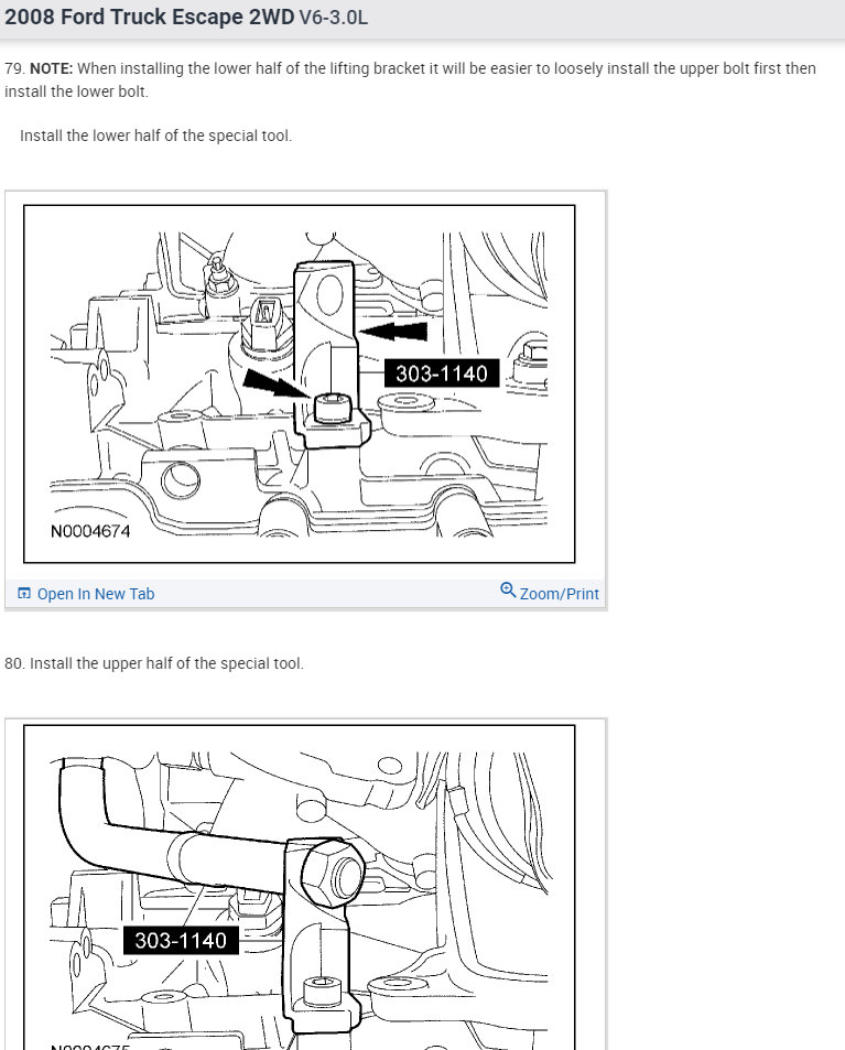

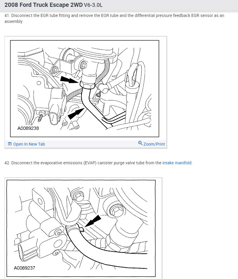

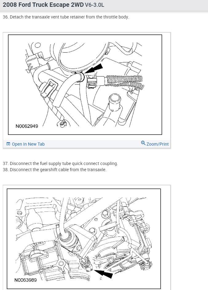

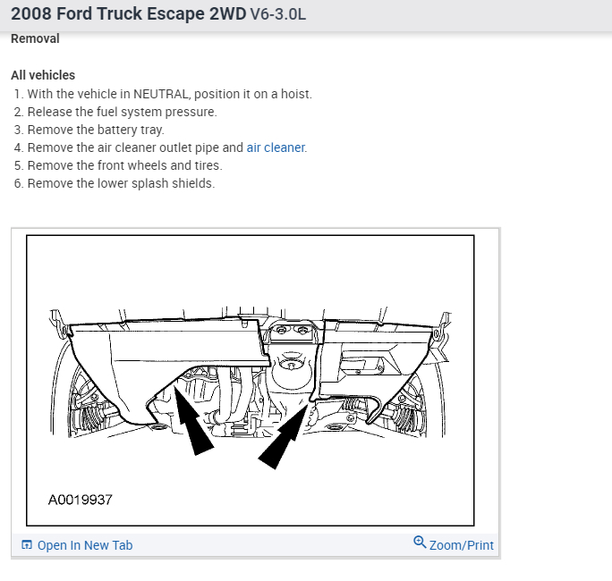

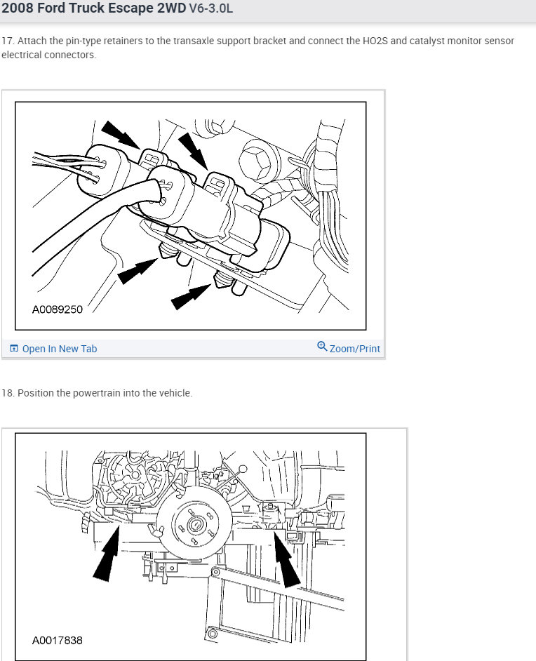

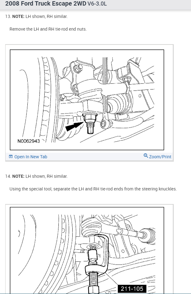

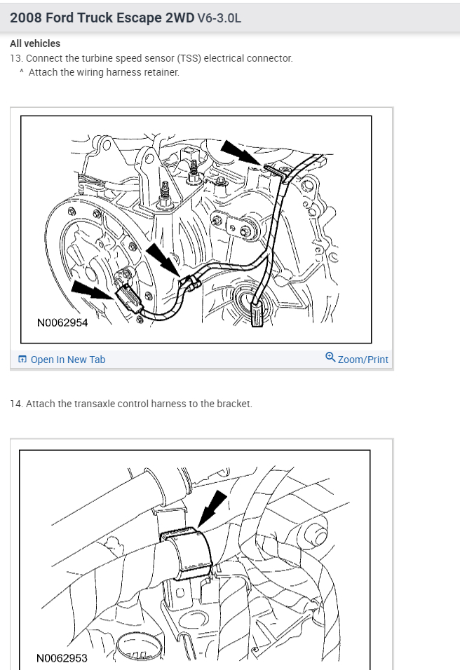

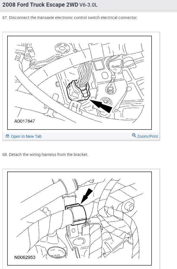

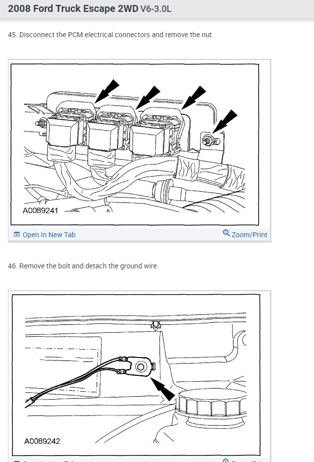

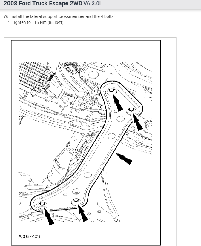

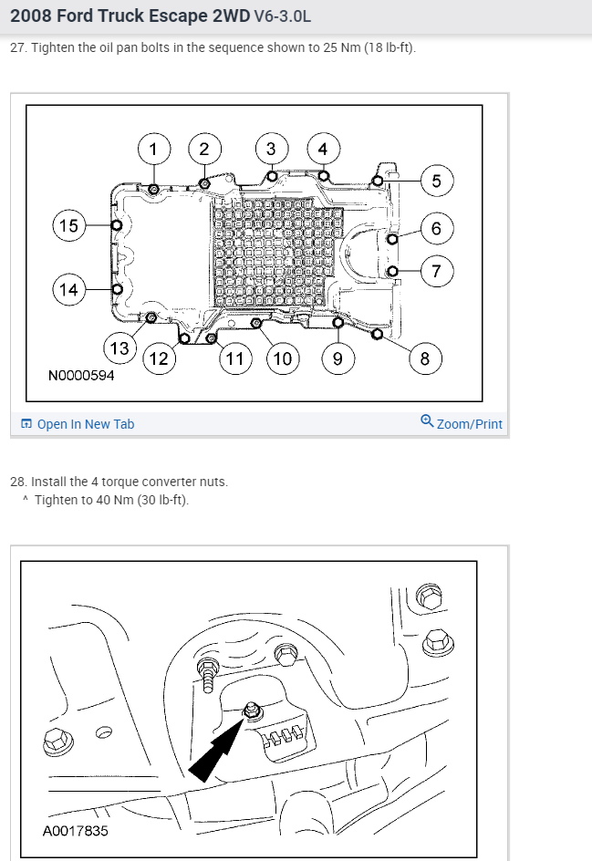

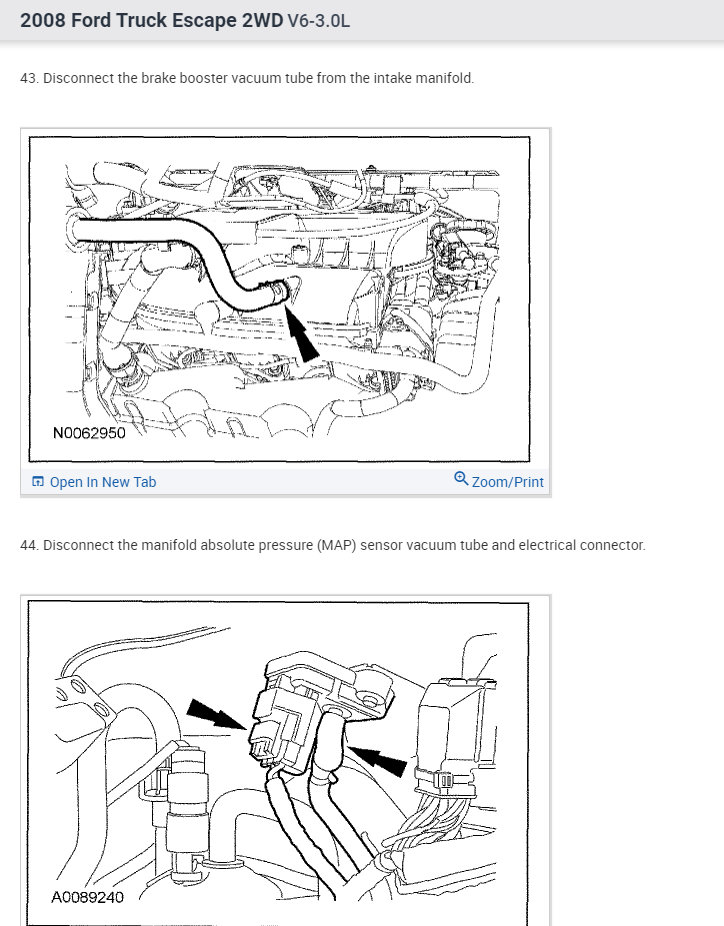

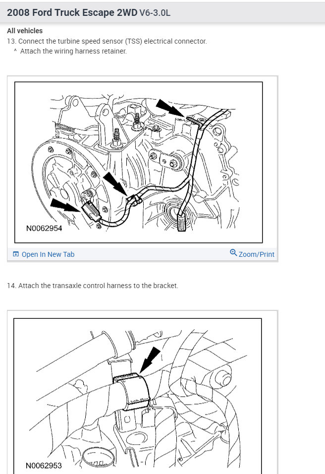

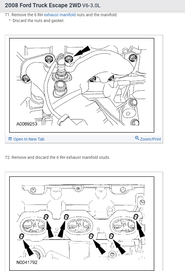

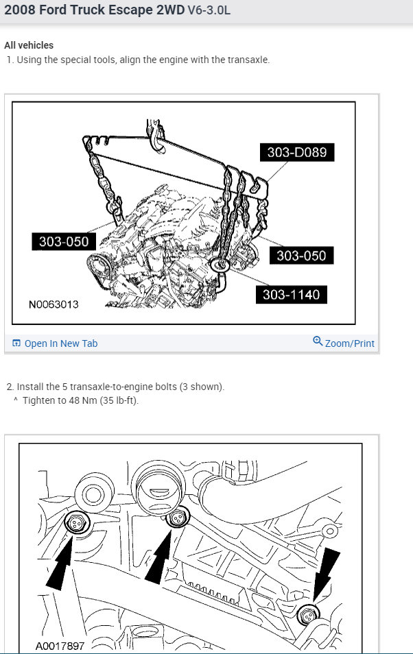

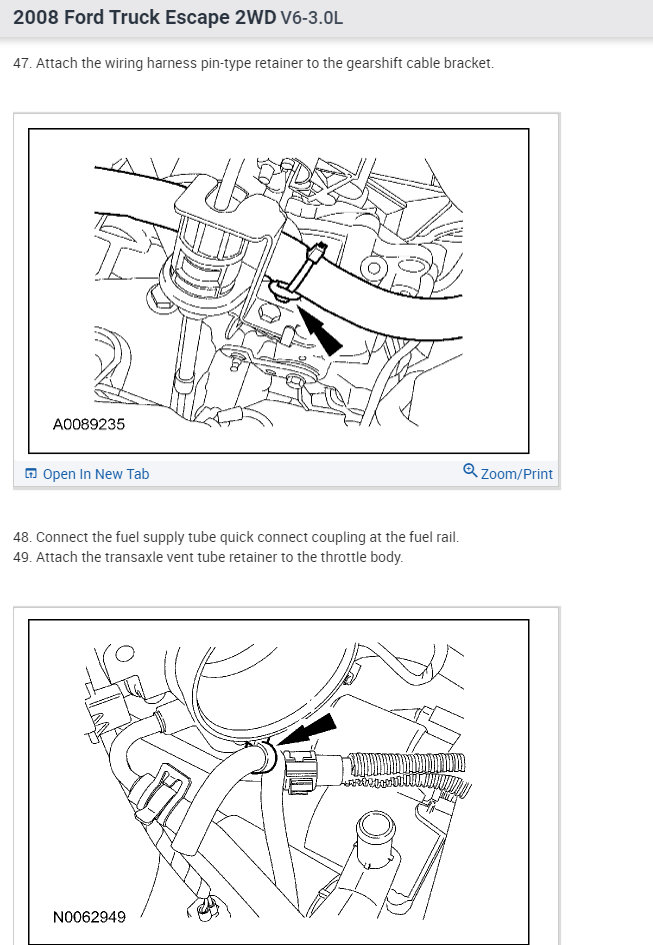

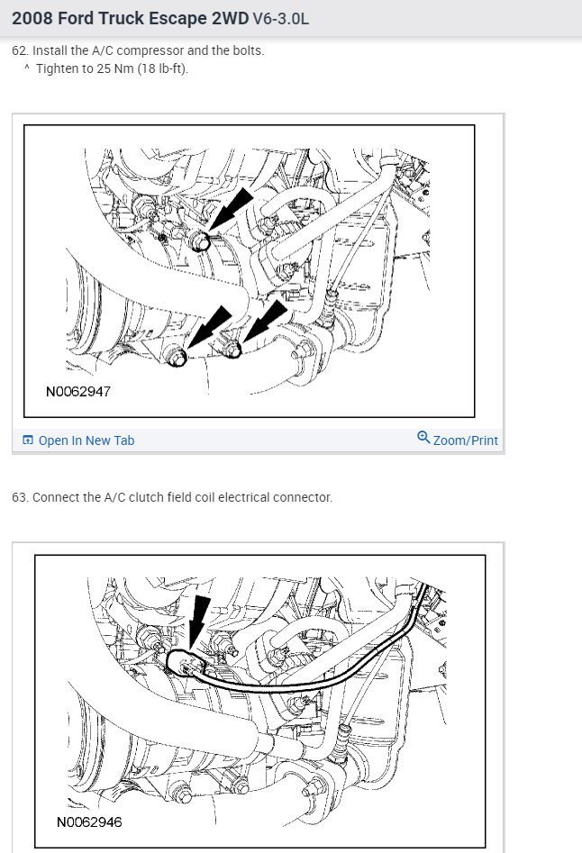

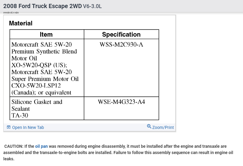

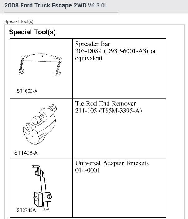

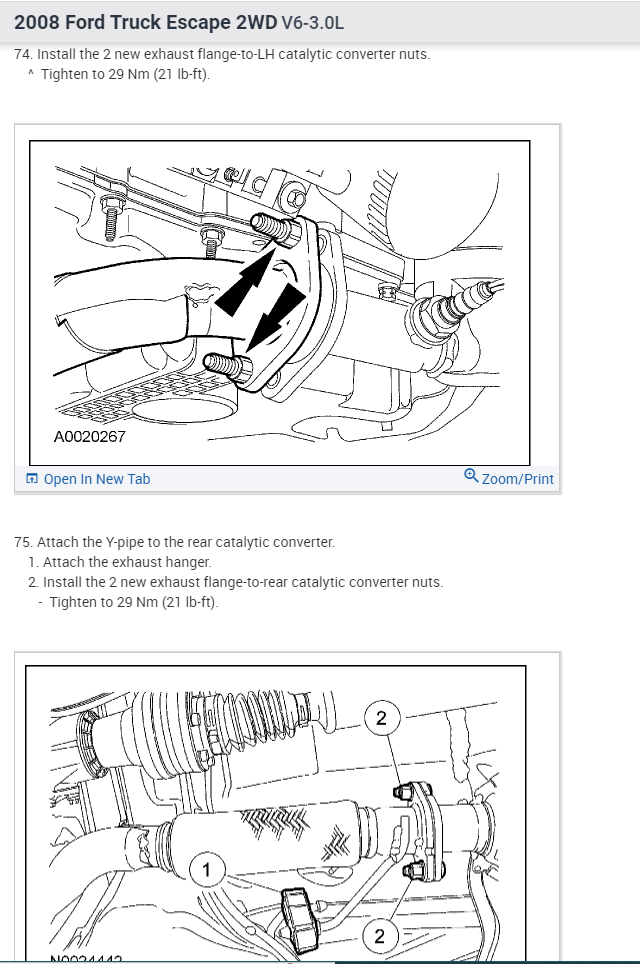

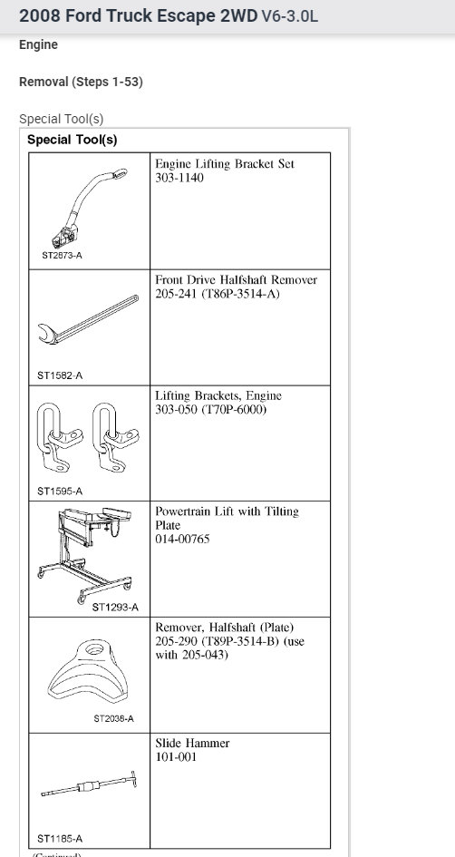

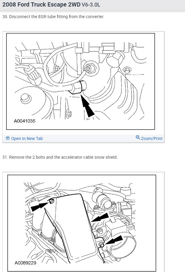

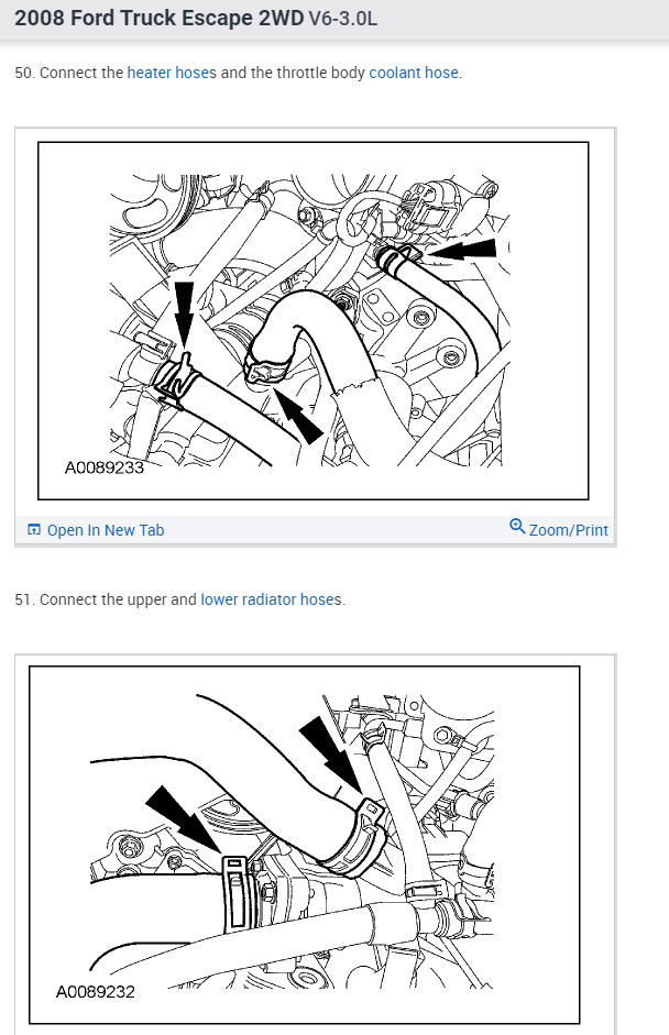

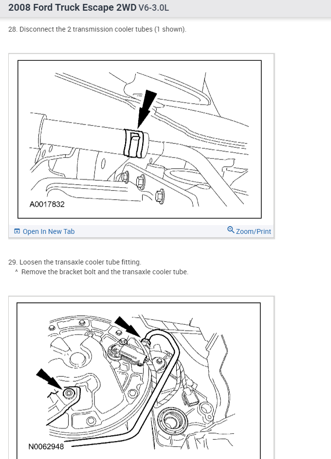

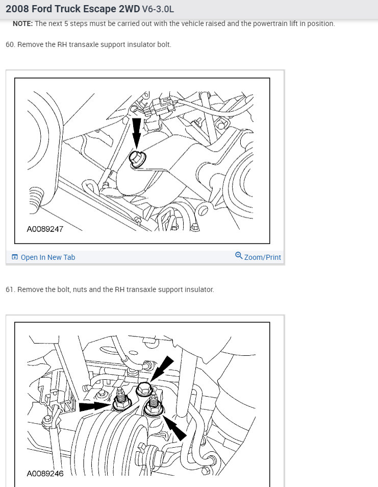

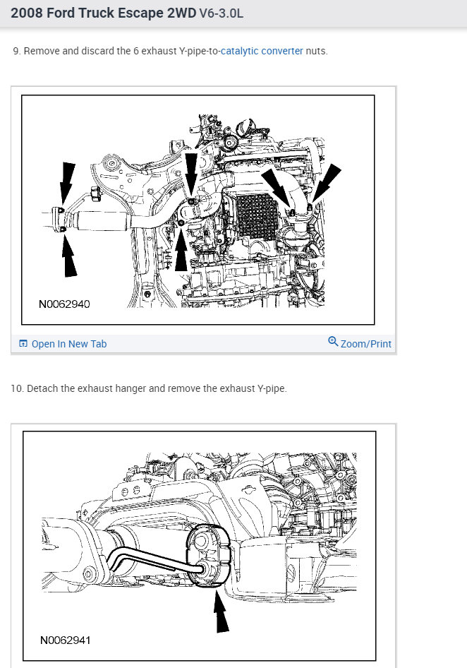

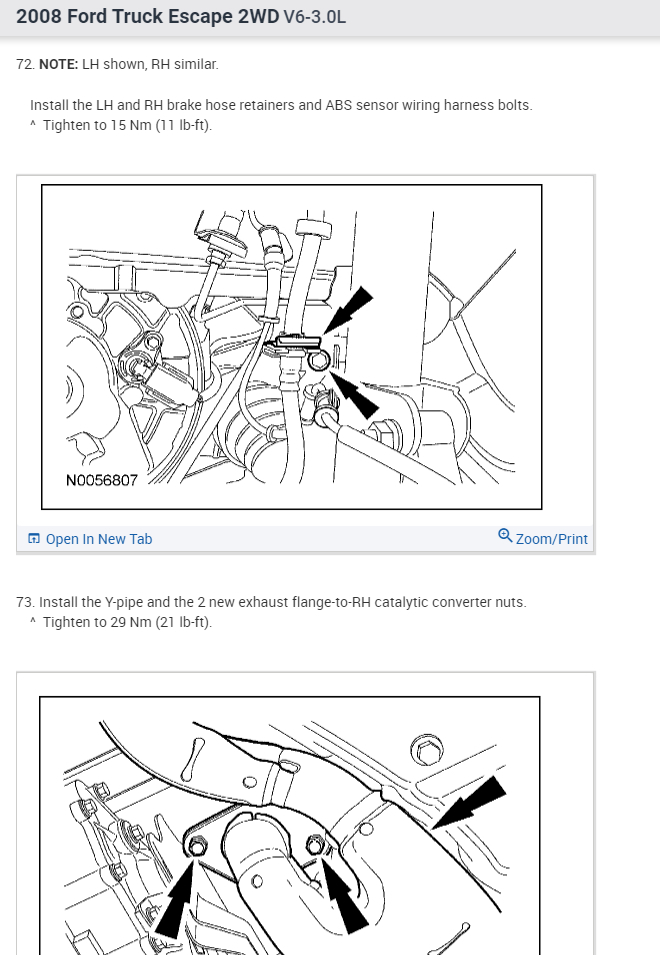

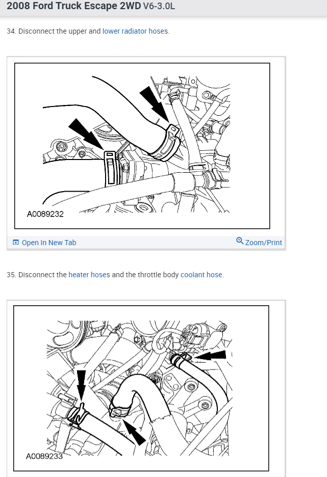

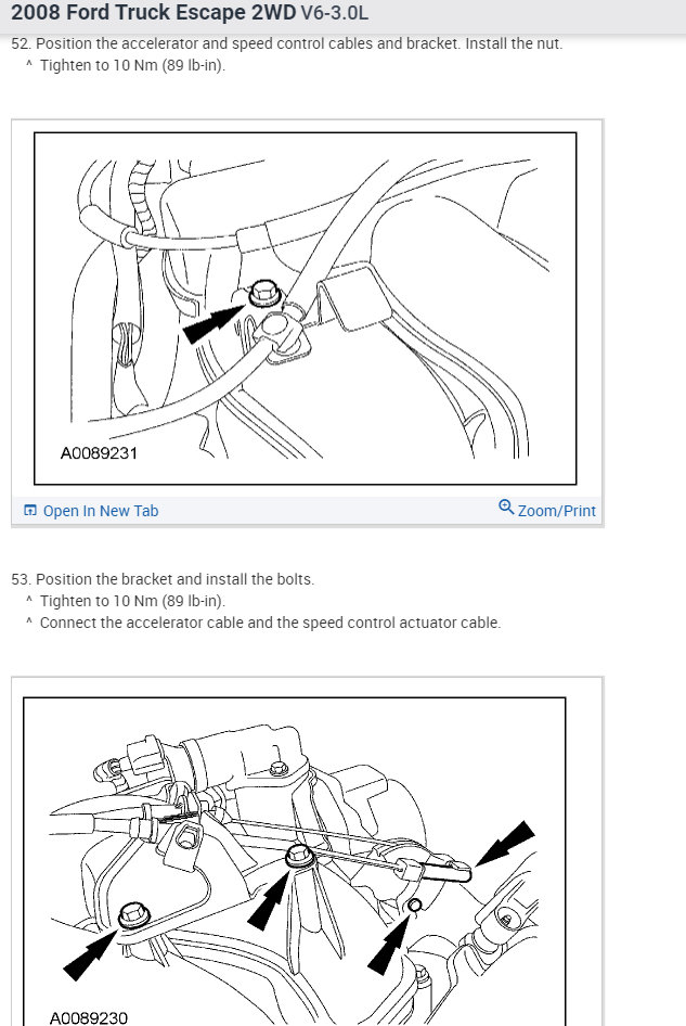

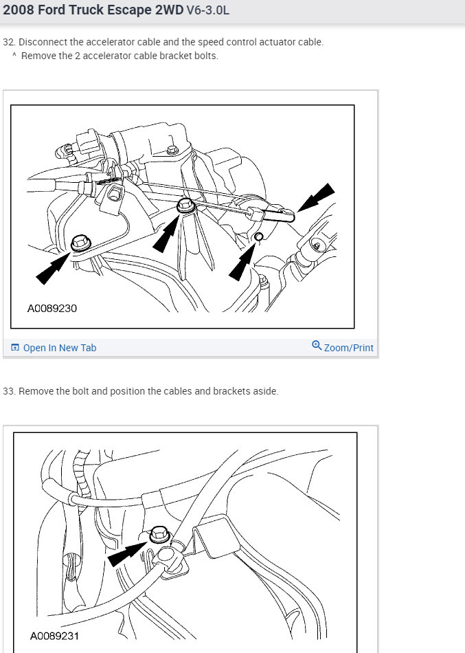

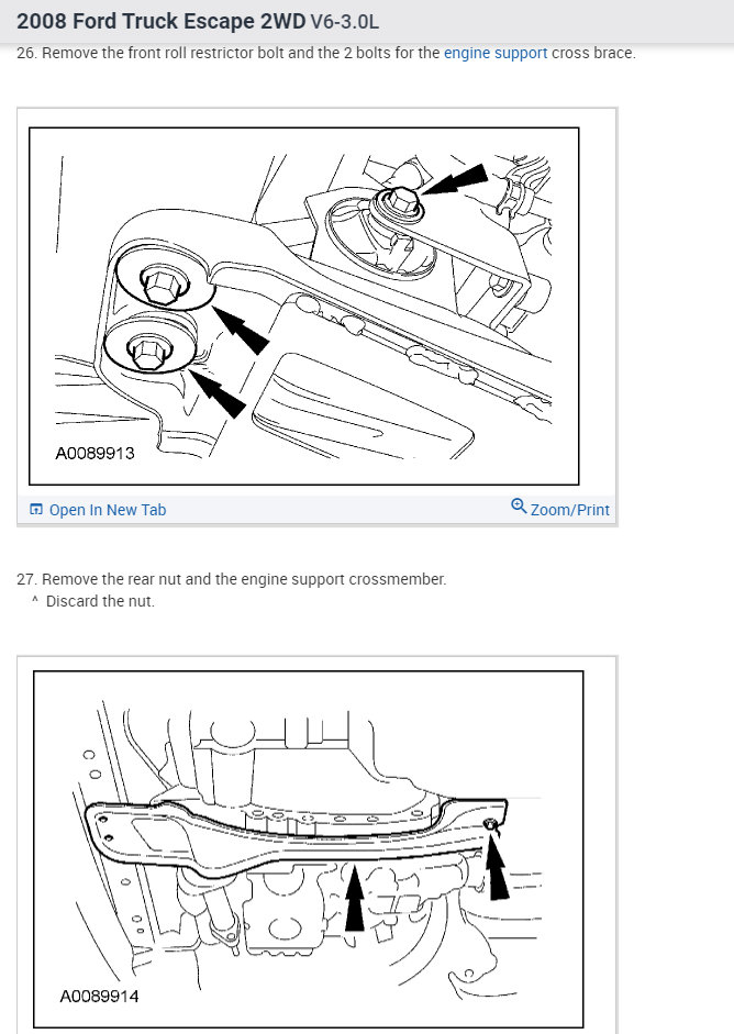

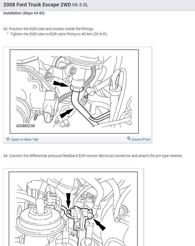

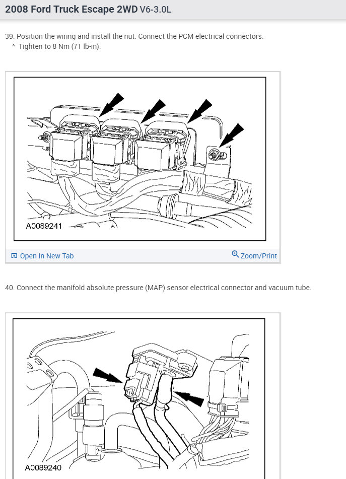

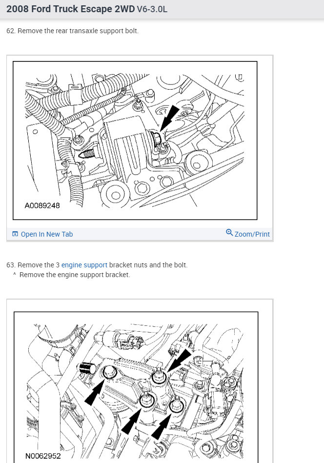

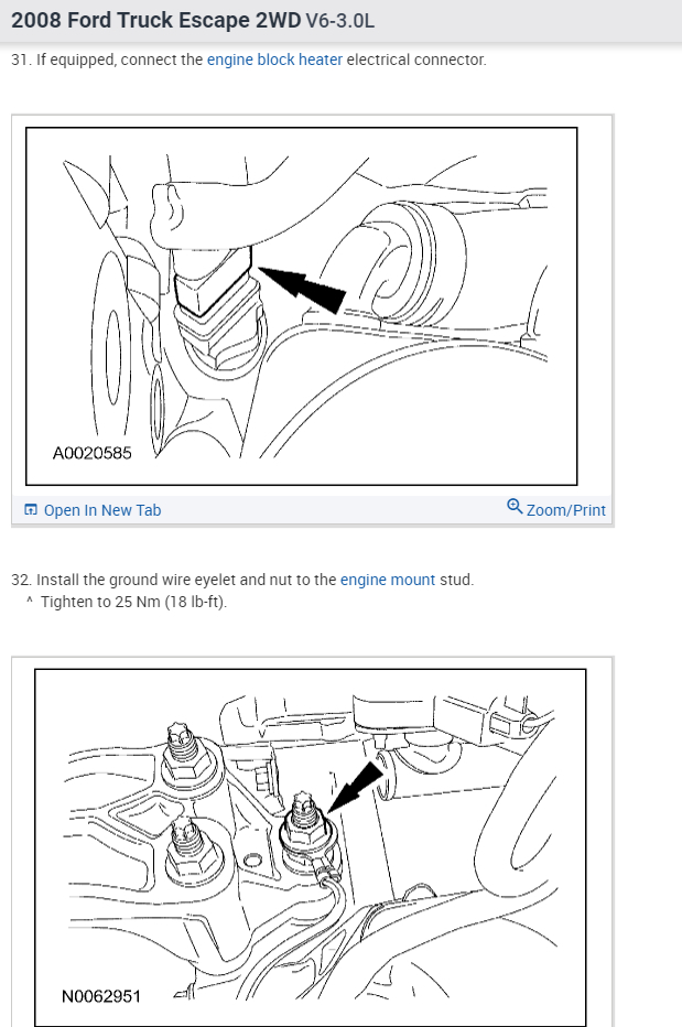

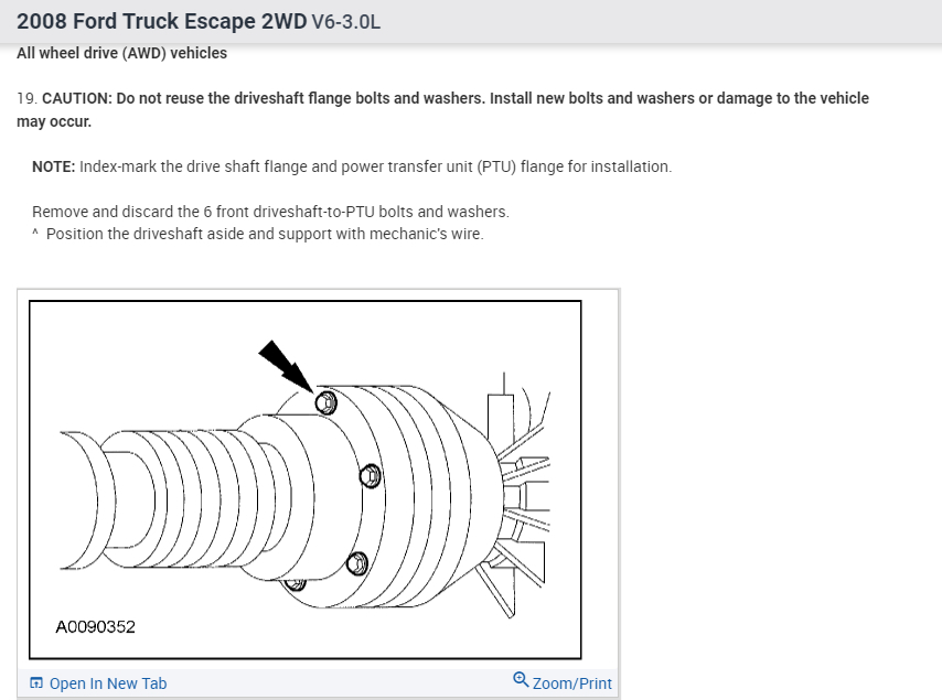

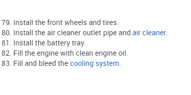

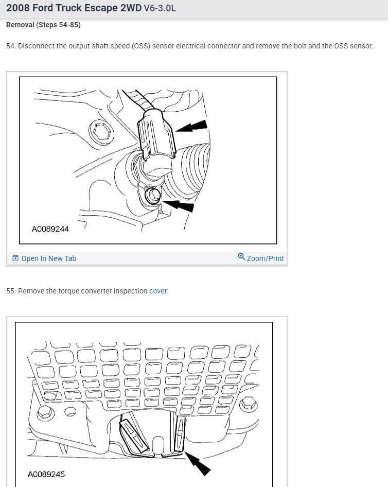

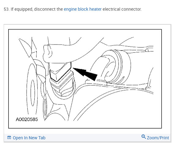

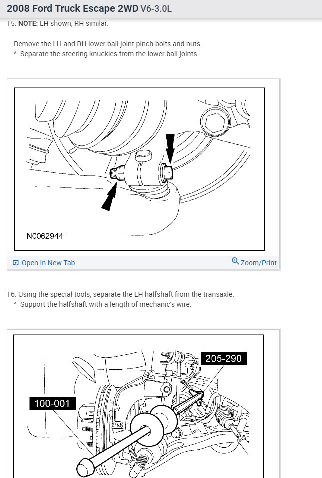

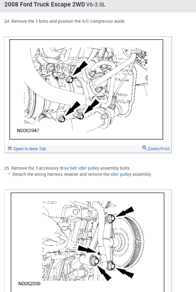

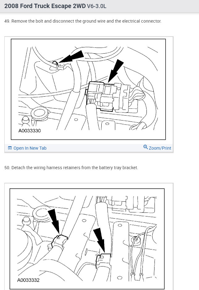

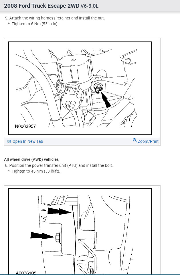

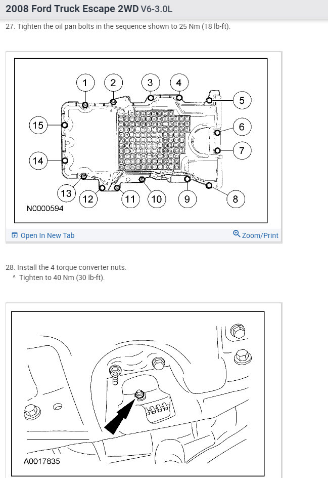

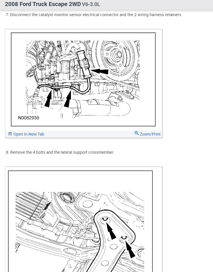

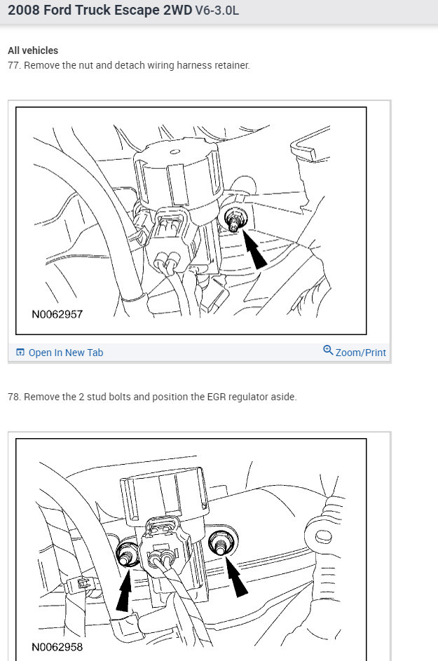

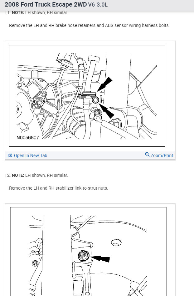

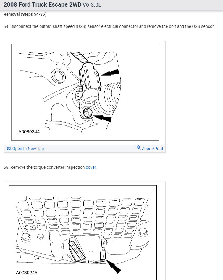

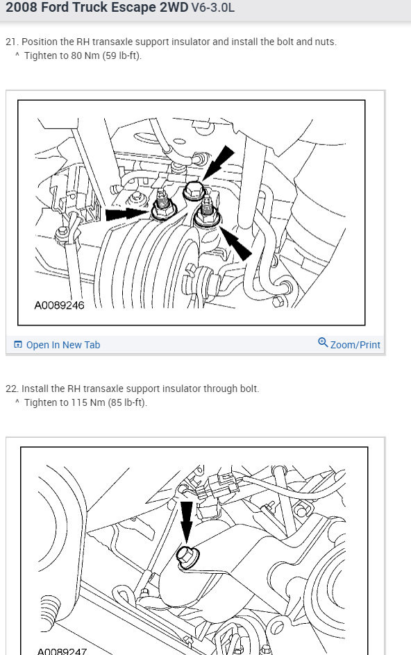

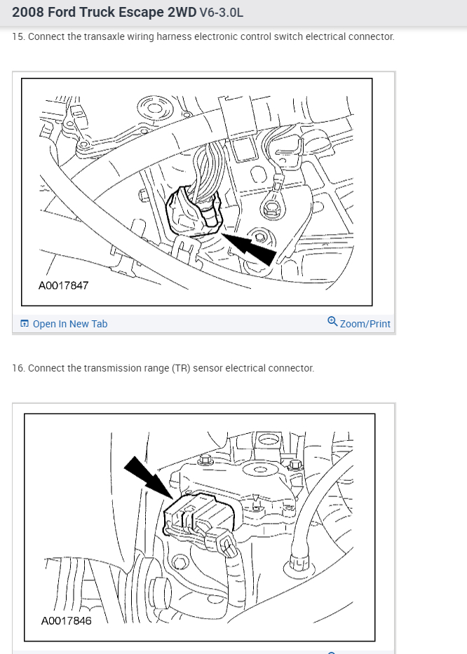

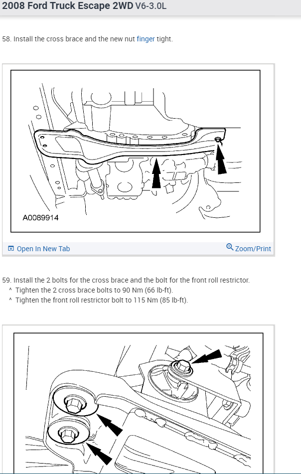

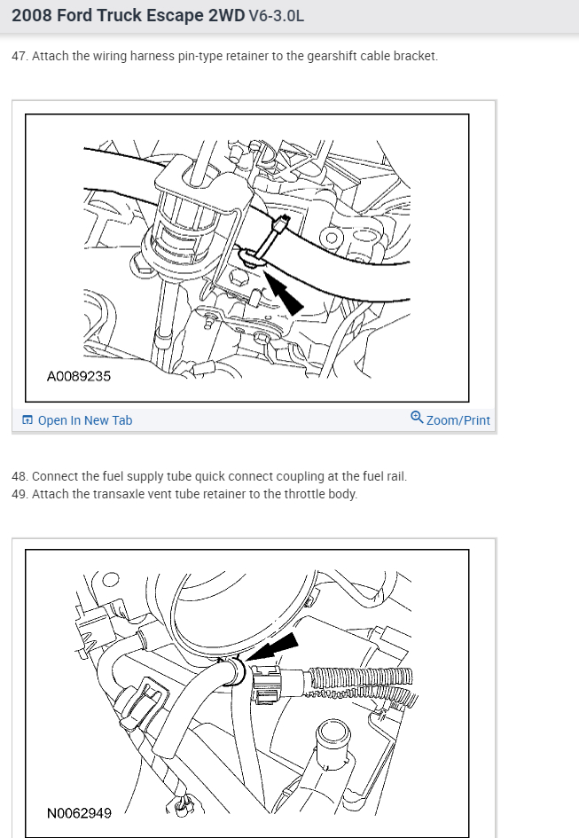

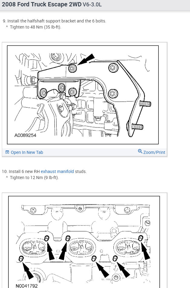

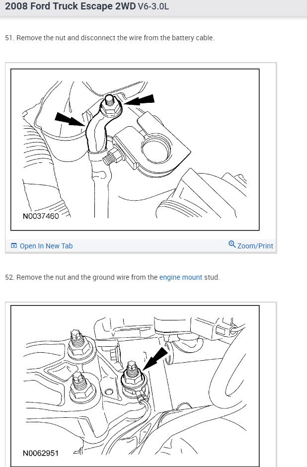

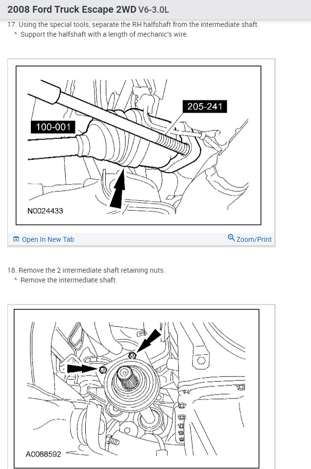

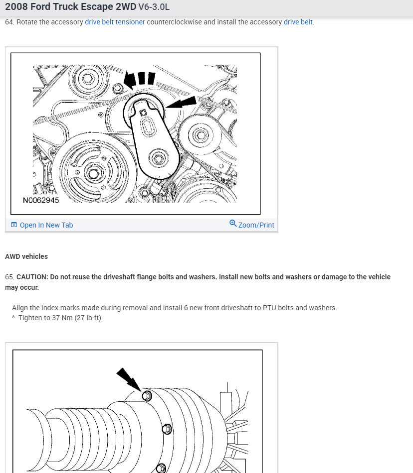

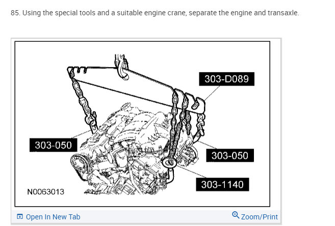

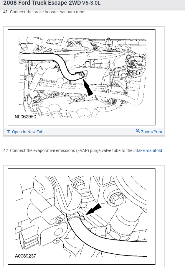

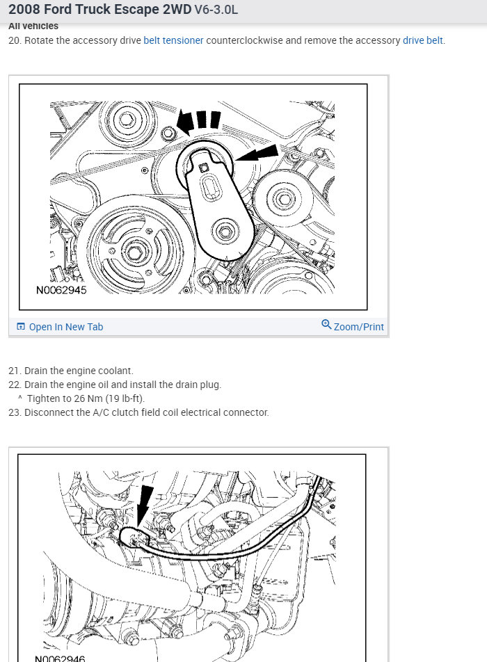

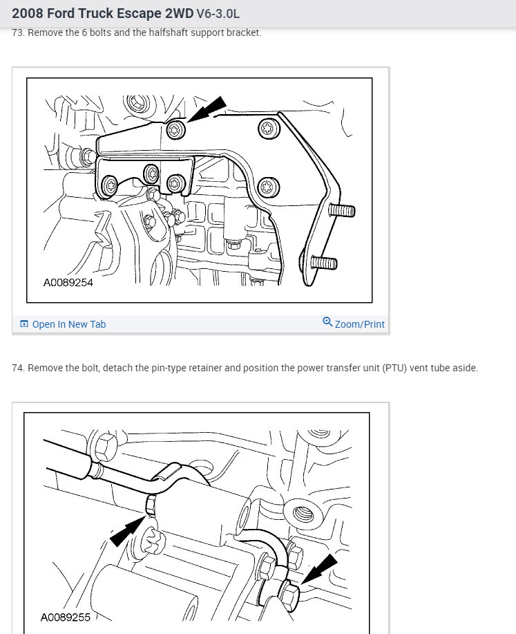

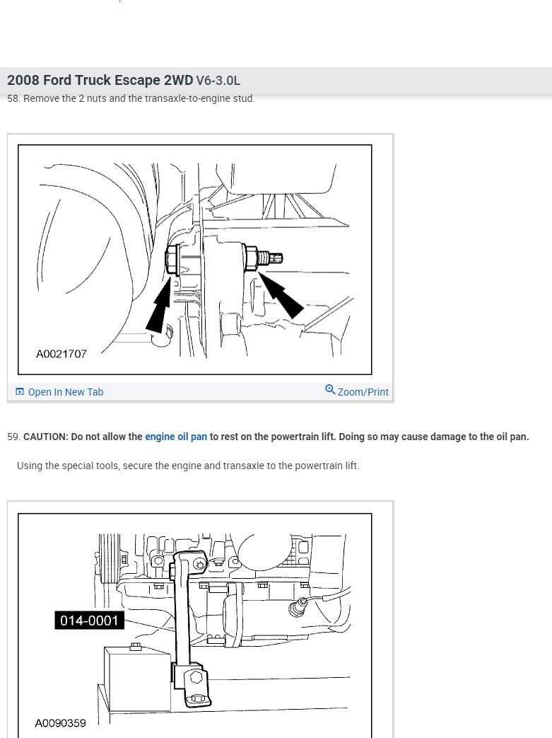

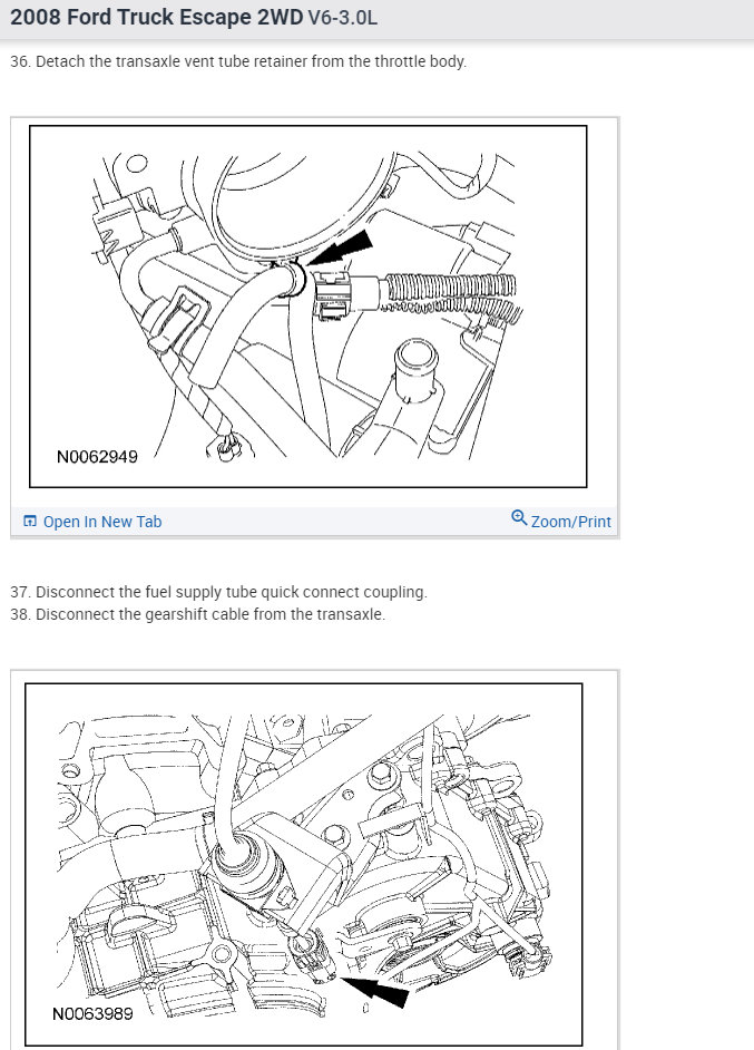

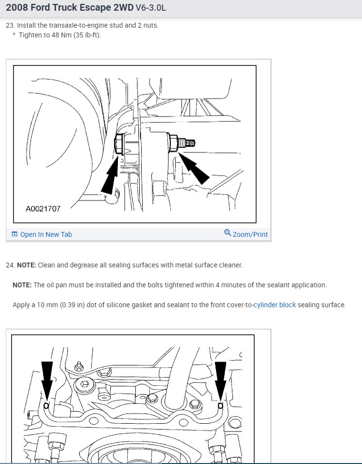

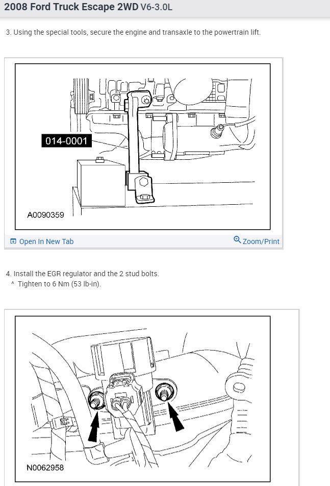

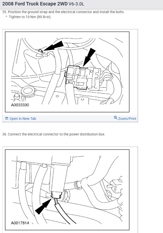

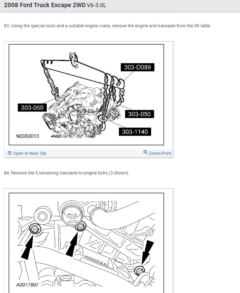

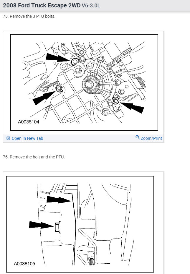

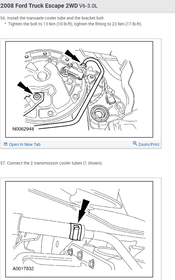

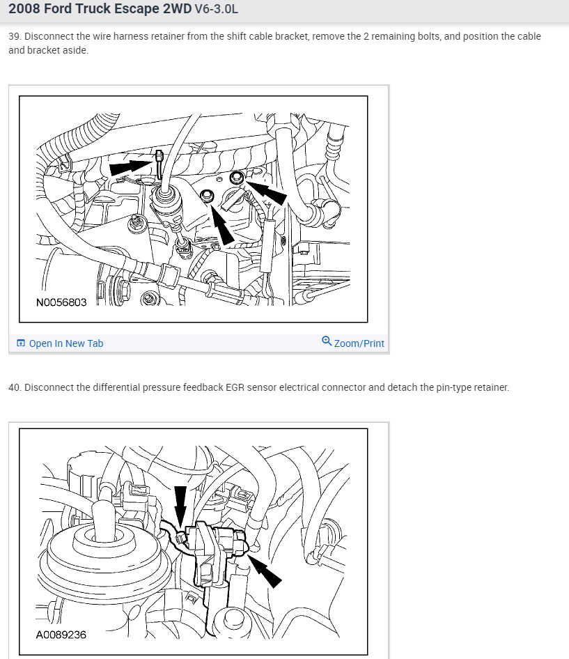

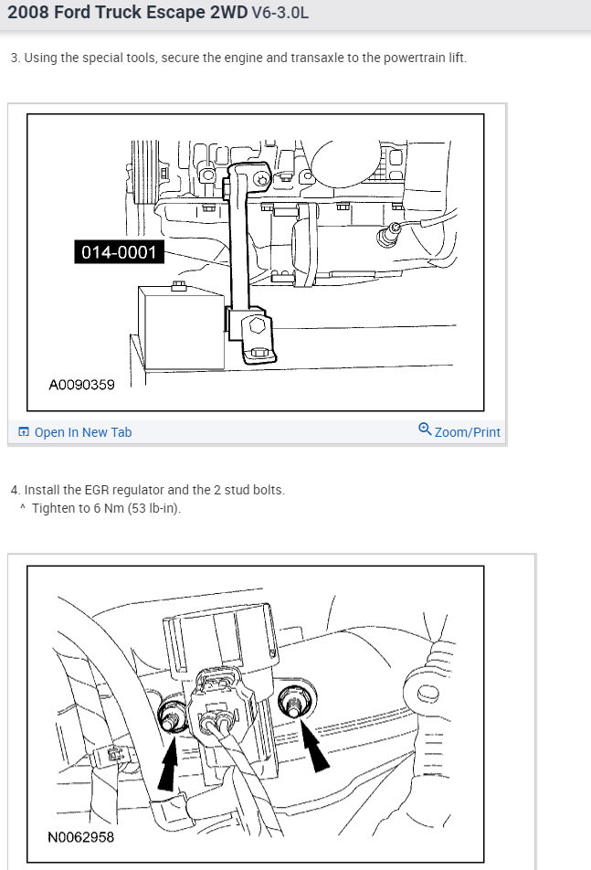

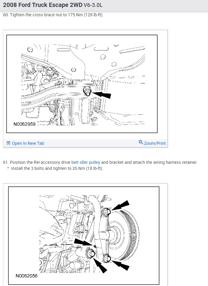

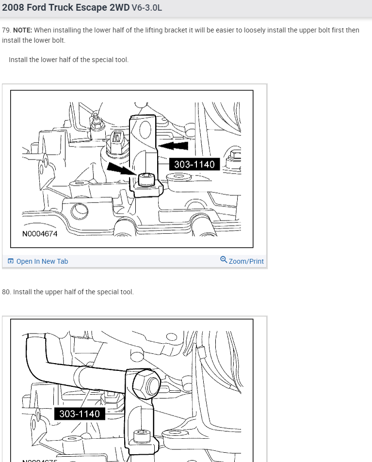

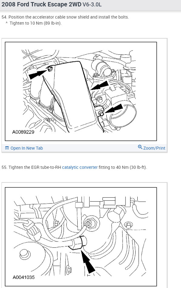

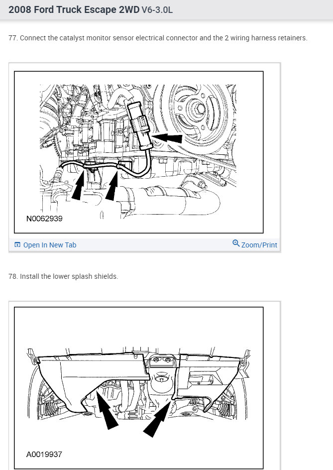

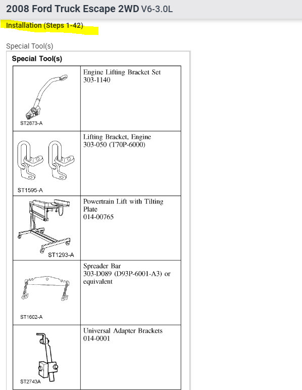

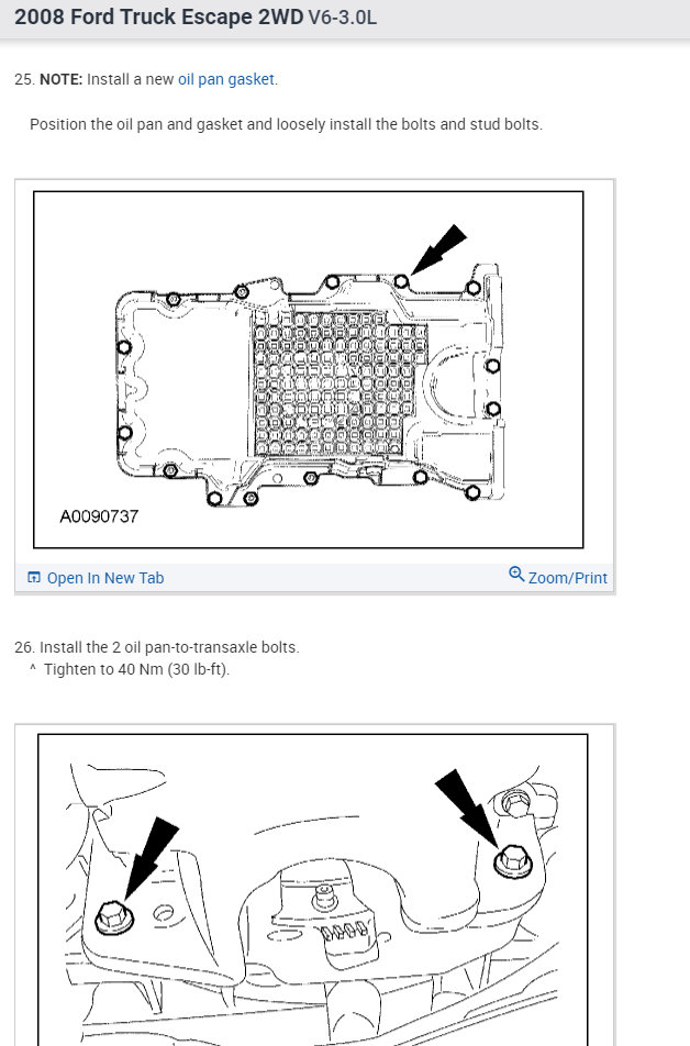

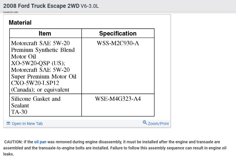

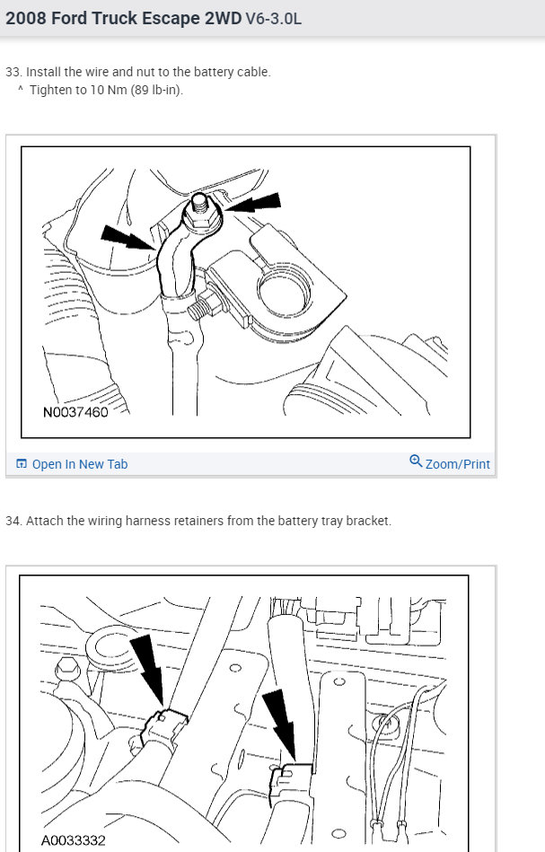

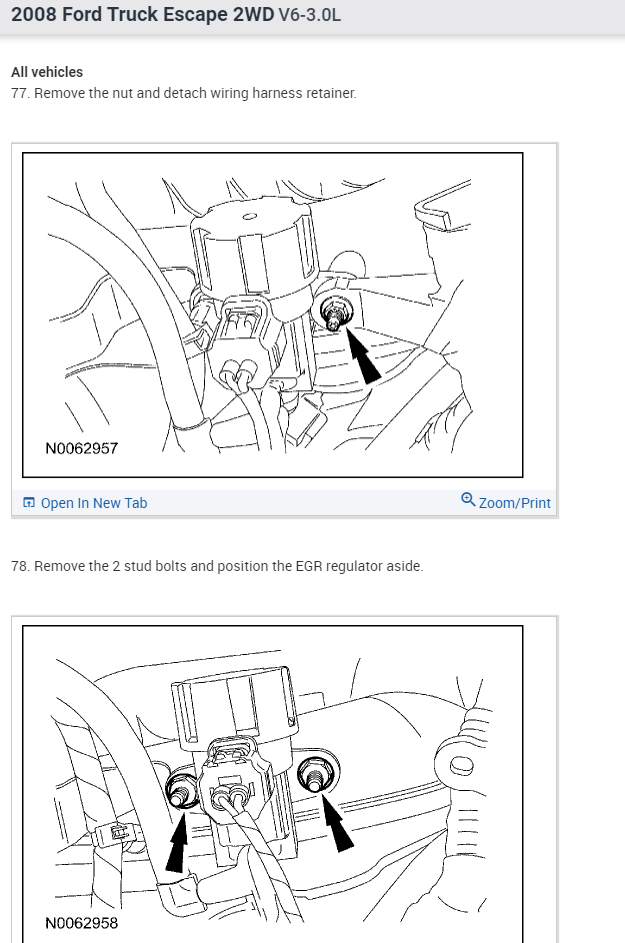

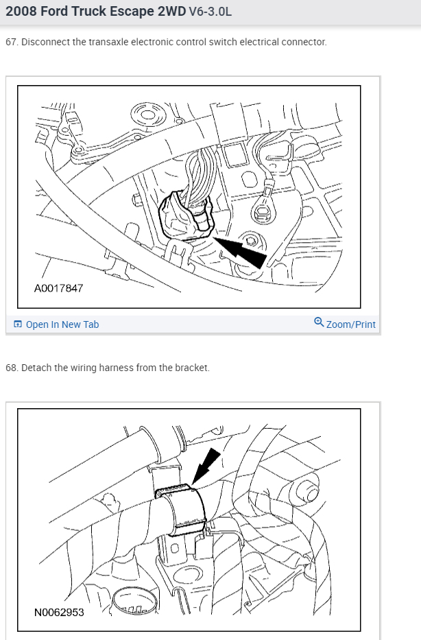

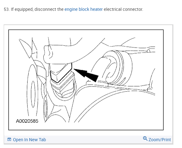

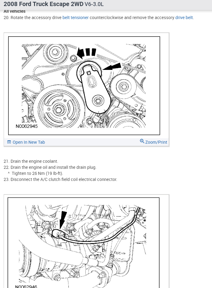

I'm removing my engine from my vehicle listed above. How do I get step by step instructions?
Sep 24, 2022 at 8:28 PM
SQM
CERTIFIED EXPERT
6,383 POSTS

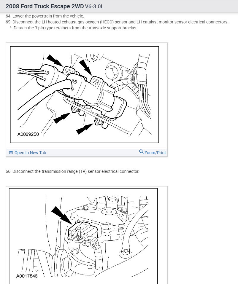

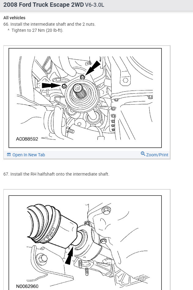

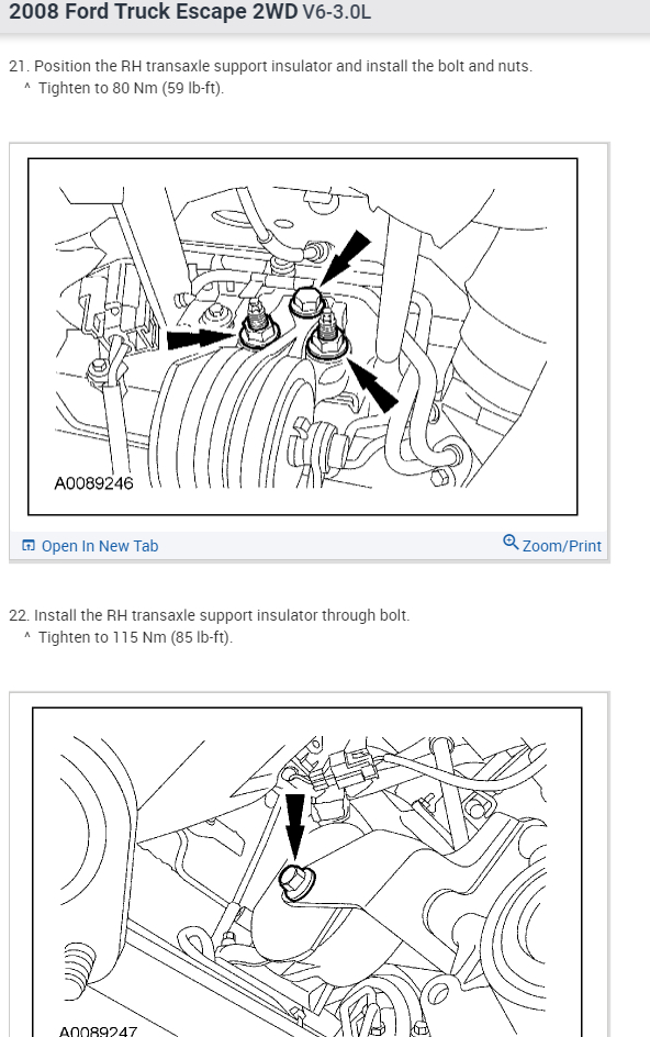

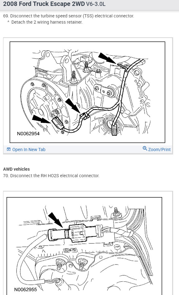

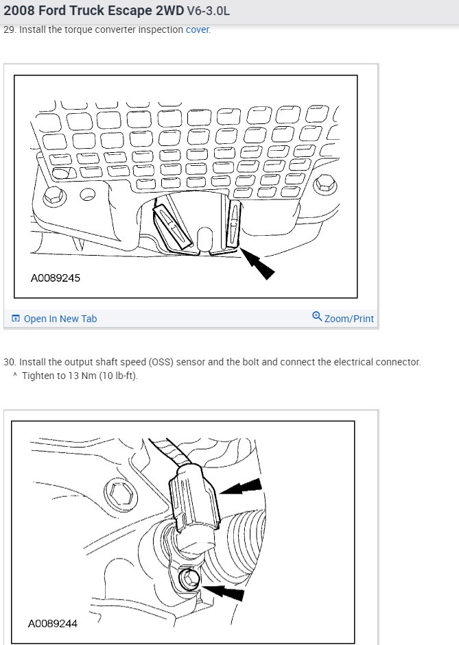

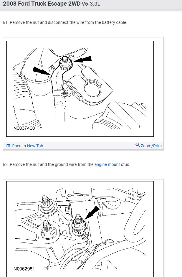

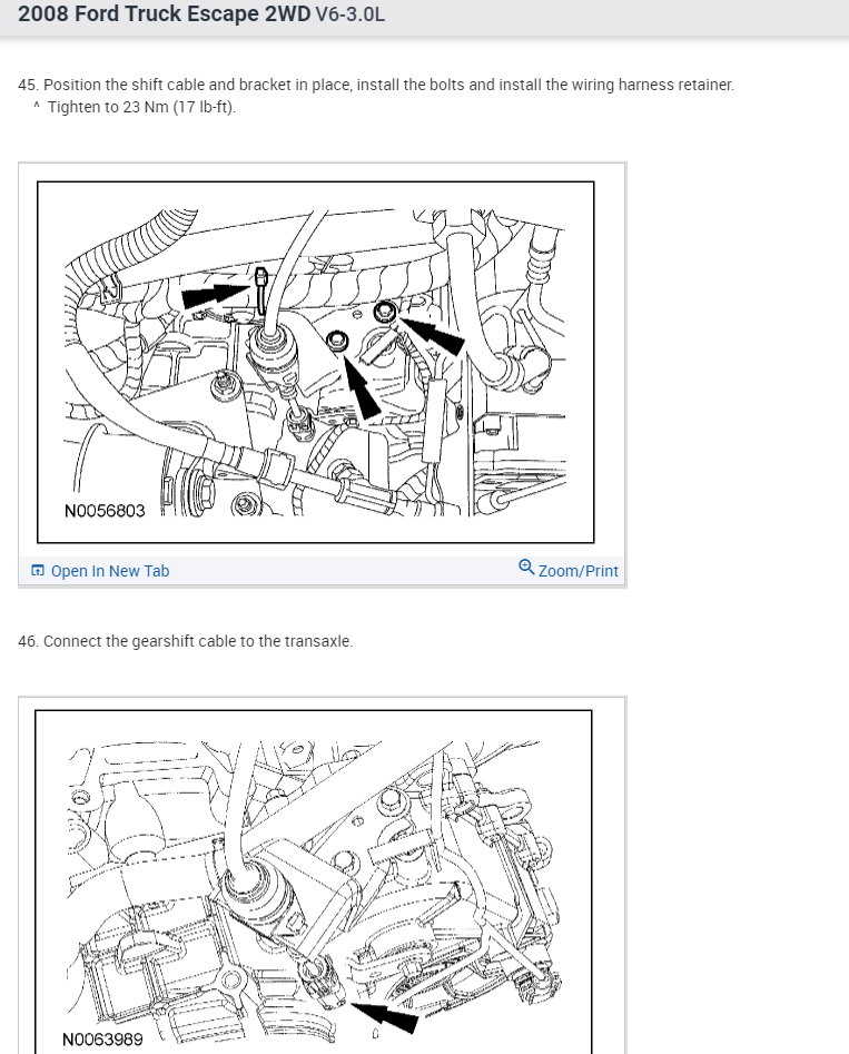

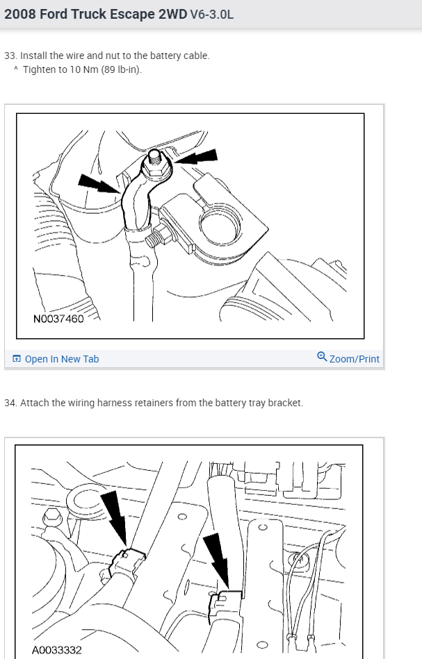

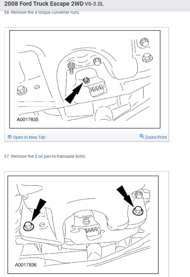

See attached for the complete engine removal and installation.
Let me know of any questions.
