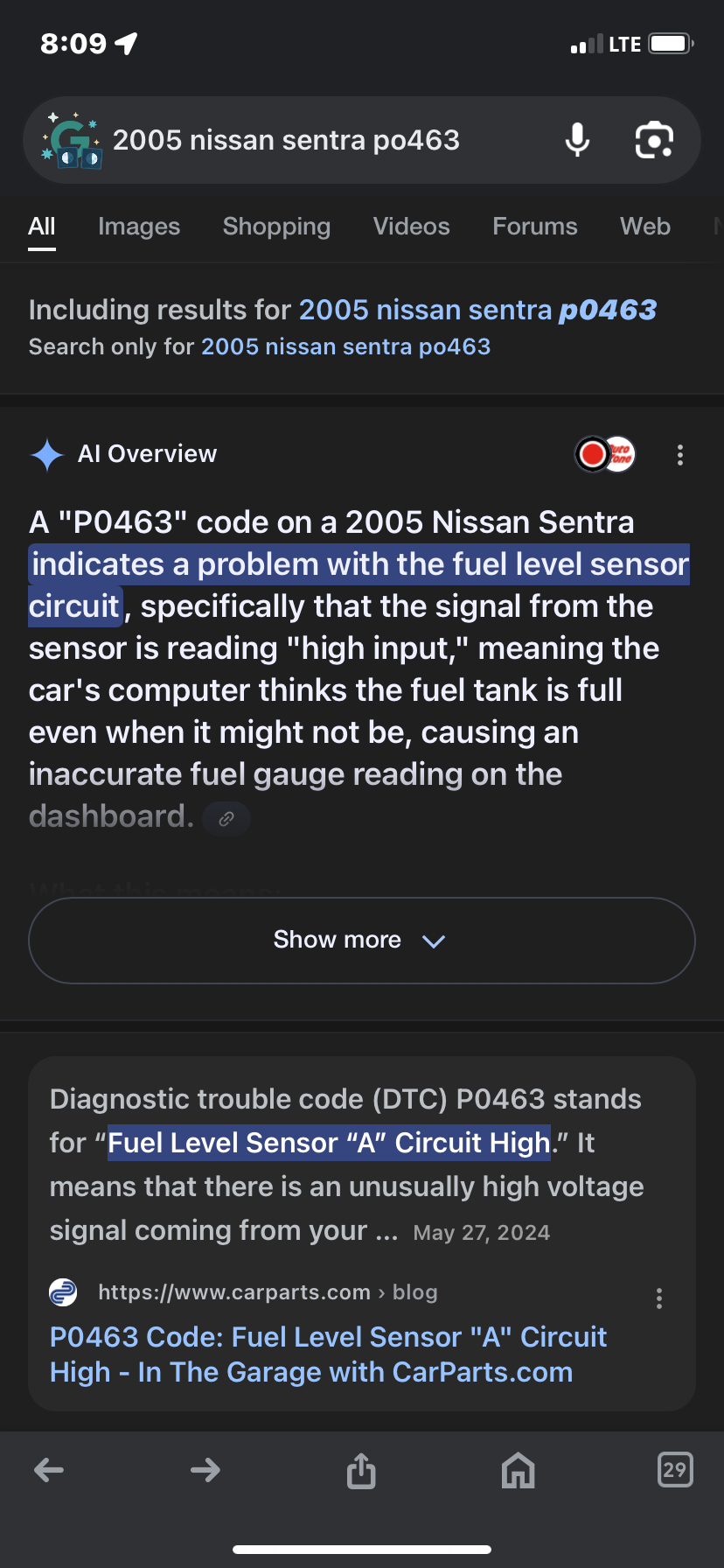

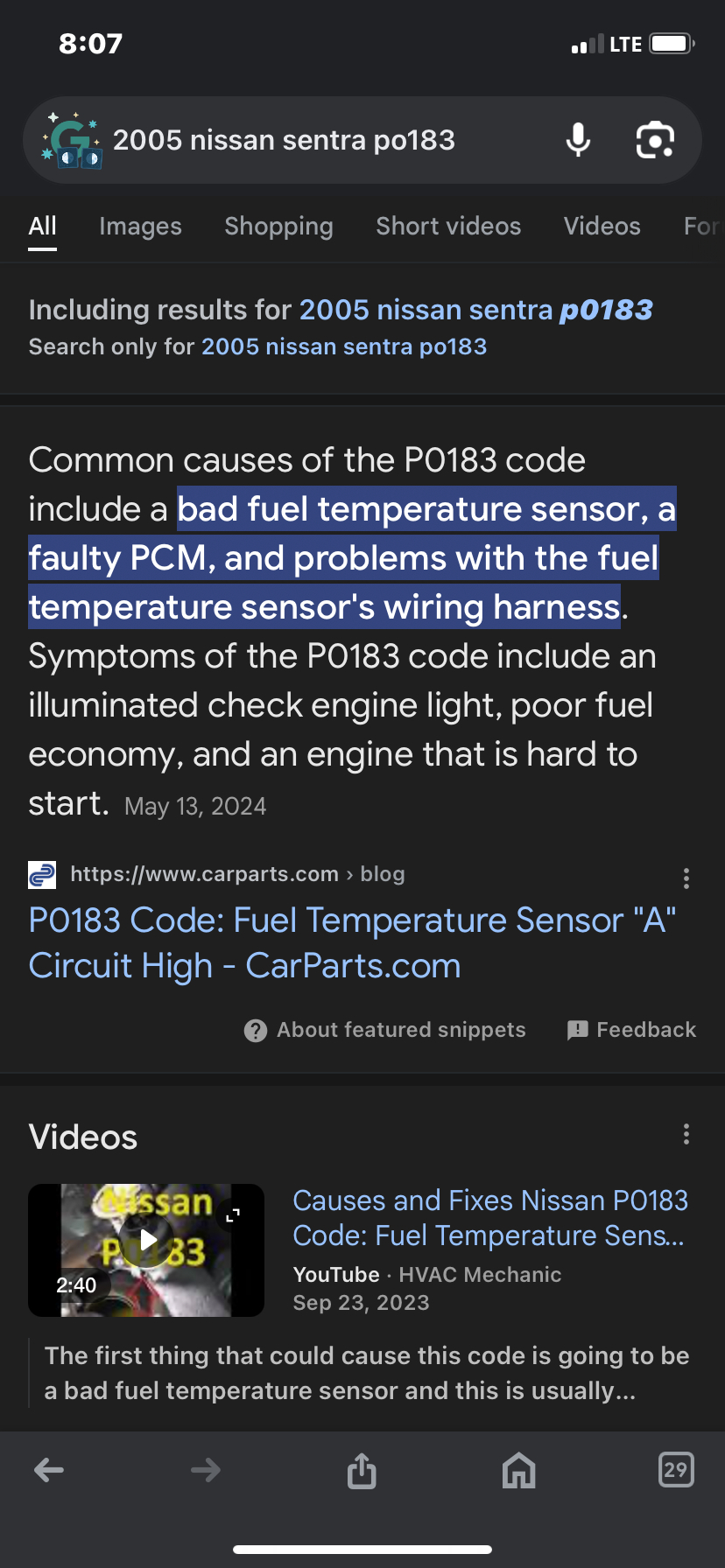

Those are the 2 codes that popped up after changing the motor in the fuel pump.
Nov 21, 2024 at 8:47 PM

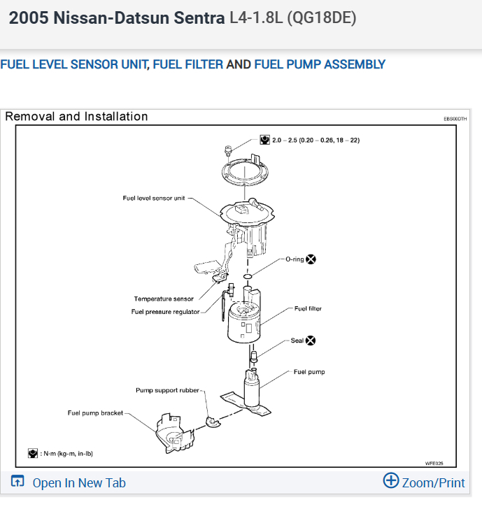

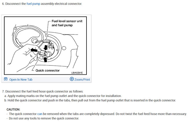

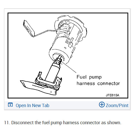

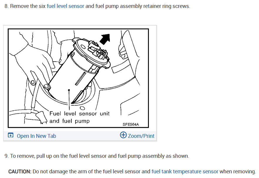

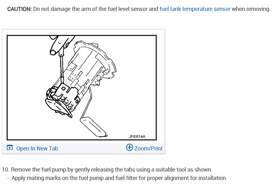

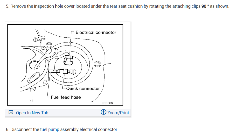

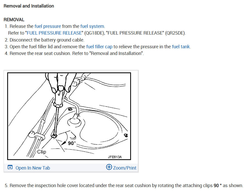

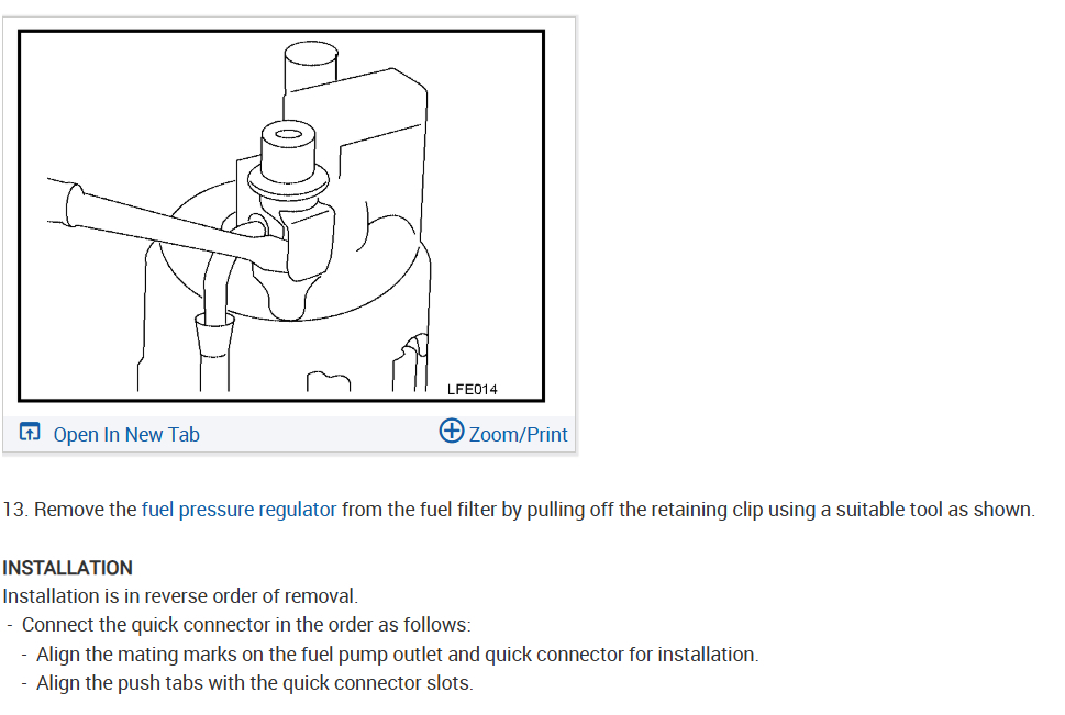

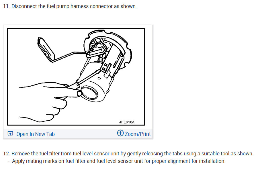

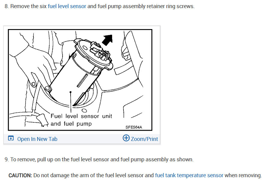

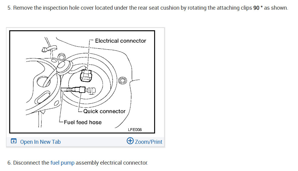

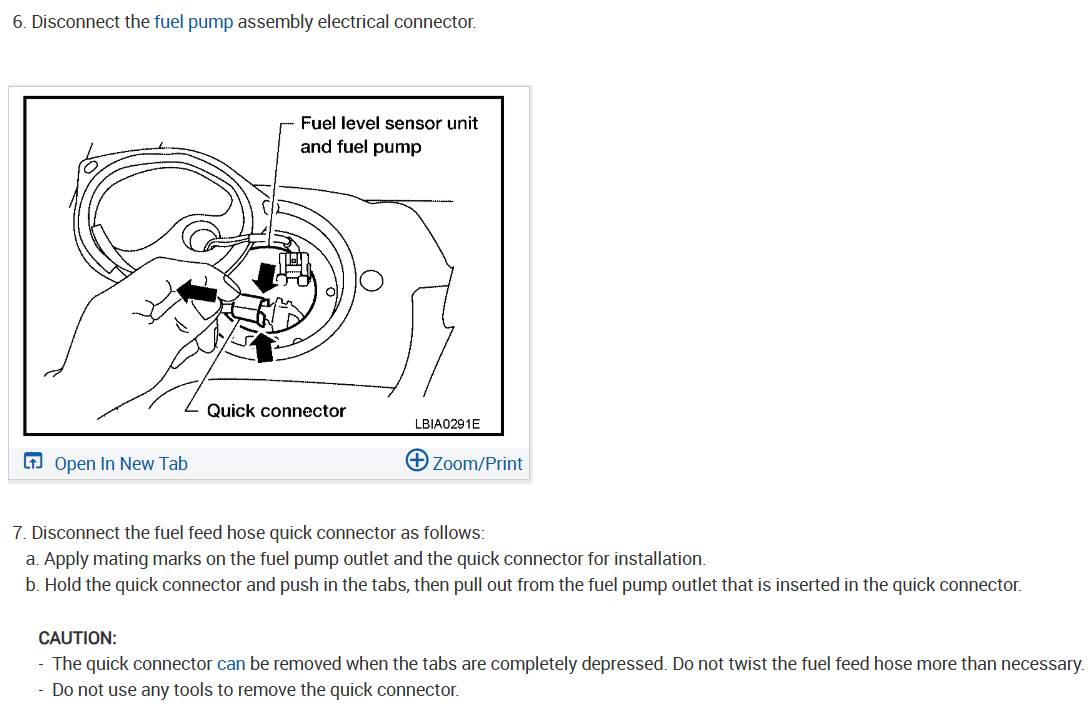

Yep, both of these codes have to do with the fuel pump module so it must be defective. Here is the correct way to change out the fuel pump in case you need it. Check out the images (below). Please upload pictures or videos in your response of any problems so we can see what to help you with.
Nov 22, 2024 at 12:22 PM
