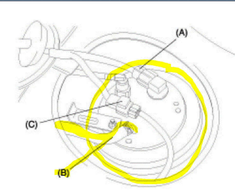

Tell me, has it been confirmed that it is the tank leaking and not one of the hoses from the tank? You can check it somewhat easily. Under the rear seat is an access port to work on the fuel pump. There you will see the fuel lines. I would first confirm it isn't one of them that is the problem and not the tank.
Once you remove the rear seat, you will find an access port. Open it and inspect the top of the fuel pump and around it to see if there are any leaks that are visible. Pic 1 shows what you will see. Letter B is the fuel supply line.

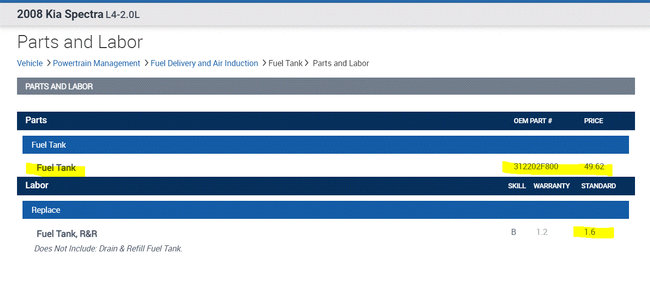

Even if the tank is bad, a new original equipment one is under 50 dollars (OEM part number 312202F800) and labor is under 2 hours (1.6 hours). Unless the vehicle is in really unsafe condition, I would likely fix it. I don't know the labor rate, but multiply it by 1.6 and that should tell you what to expect for a labor charge. There may be a few other miscellaneous things, but nothing too expensive.
If you look at pic 2, it shows the retail cost of the fuel tank and the number of hours allowed for replacement.

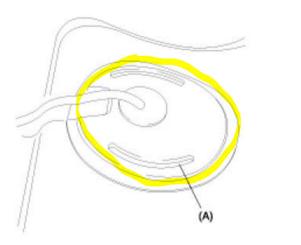

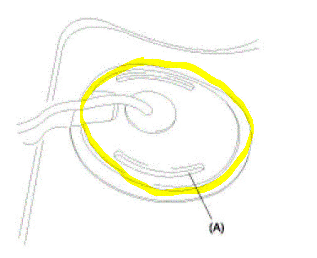

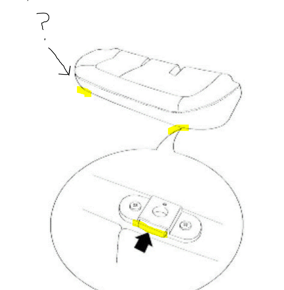

It has been some time since I've done one of these, but I don't think you need any tools other than maybe a screwdriver. There are release buttons for the seat cushion. There is either one or two of them. See pic 1 below.
Press the release button and pull toward you and then up to remove the seat cushion,
Once it is removed, you will see the access port. See pic 2. Some of these had a screw holding them and others were secured with an adhesive. If there is no screw, gently pry upwards at each corner with a flat screwdriver to remove it.
