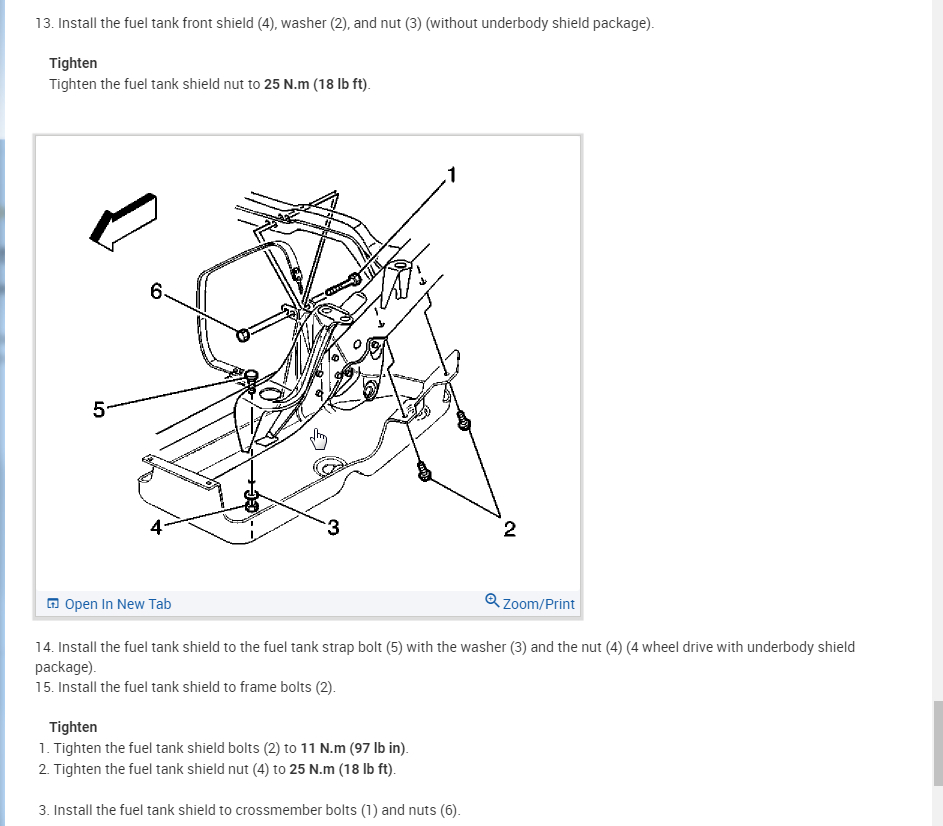

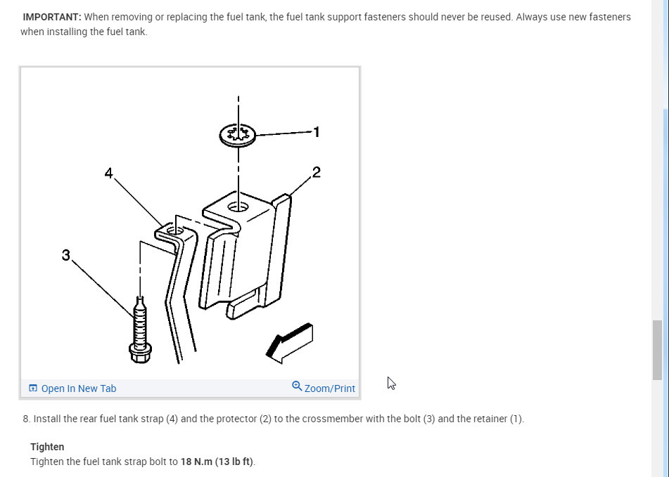

Truck listed above is a crew cab. I am trying to remove the fuel tank, I have the straps undone and there is a support that still holds it up. I'm worried the bolts will snap and wont be able to use support any more. Any ideas if I have to remove that to remove tank?

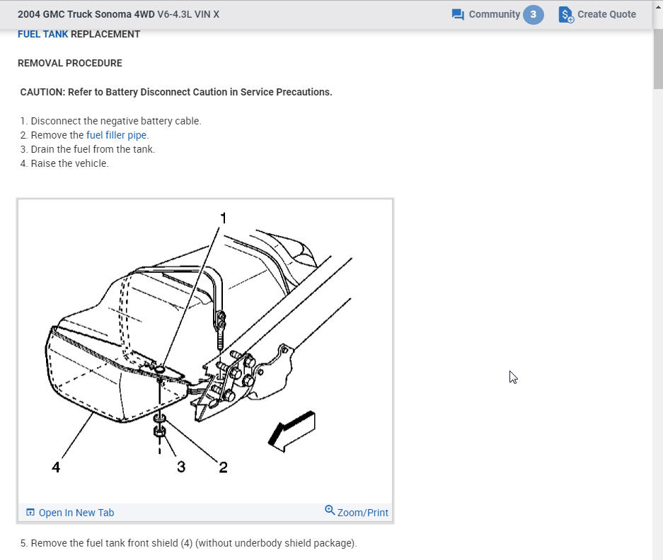

Here is the process on how to remove the tank for your vehicle. Let me know if you still have questions. Thanks

I have the straps all undone now its seems like crossmember has to come off or is there another way it's what you guys show as front strap

I think the bolts you are looking for on are the frame adjacent to the tank.

yea is there 3 or 4 because the one goes to the shackles and don't want leaf spring to fall.also i am doing it on the ground so not much room.
