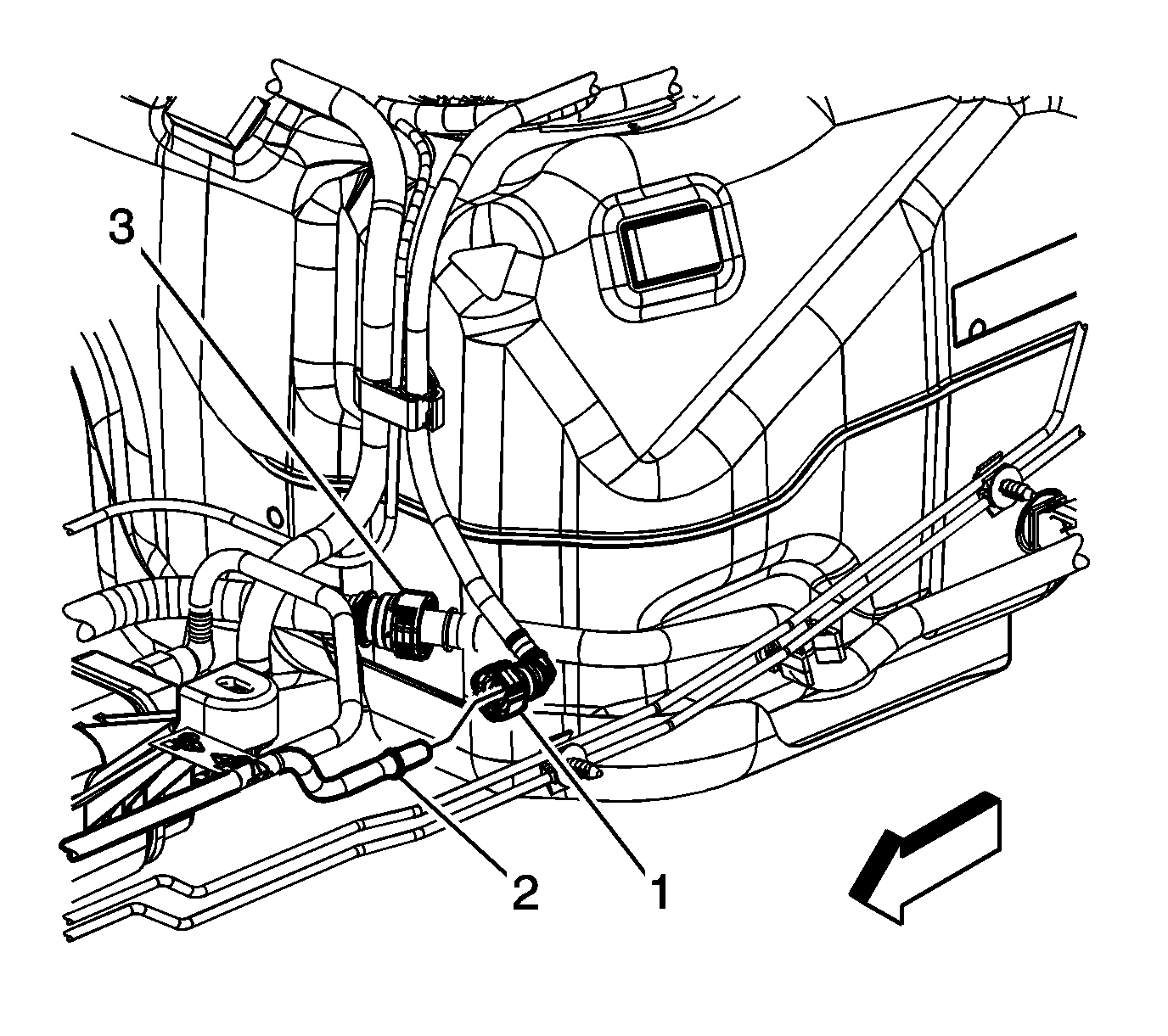

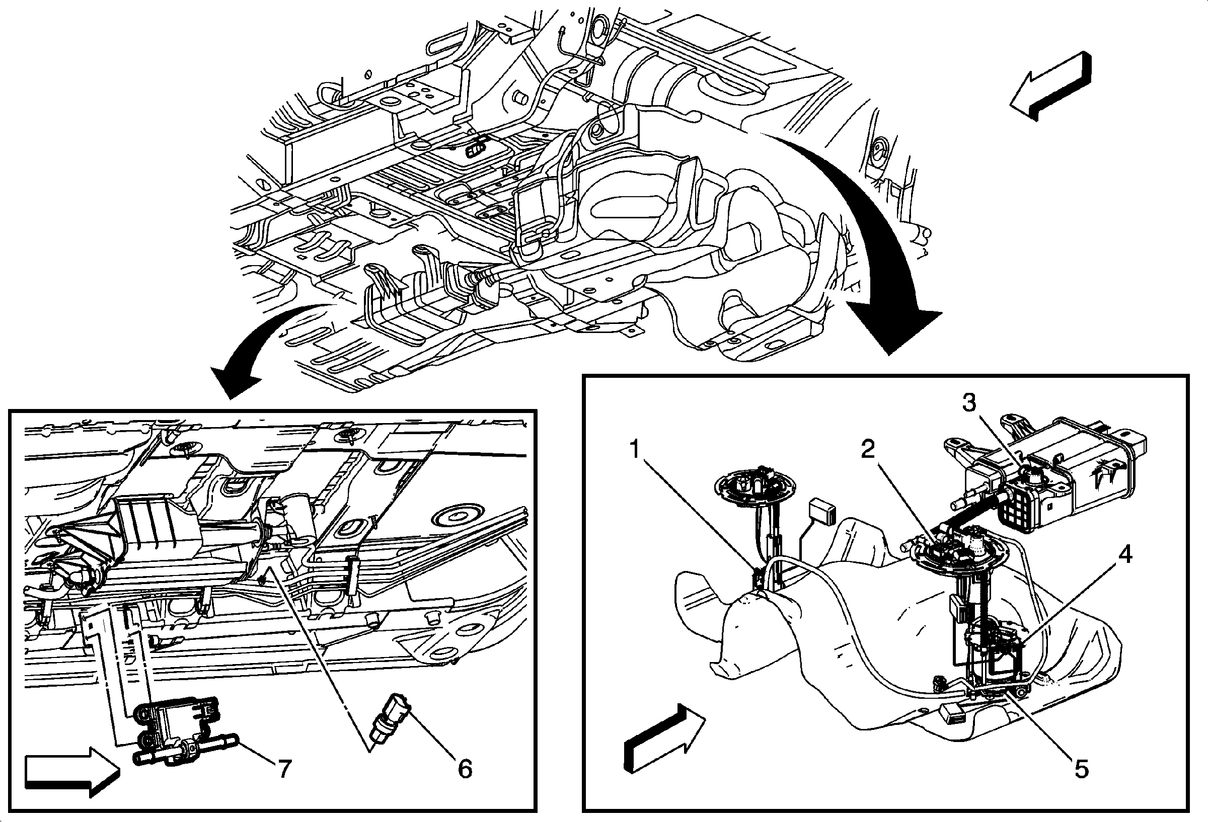

We have problems with engine light coming on we replaced already the fuel cap and still has the light on. I just wanted to ask if the sensor was on top of the fuel tank or inside?
Dec 6, 2018 at 6:39 PM
The fuel tank pressure sensor is on top of the tank. See picture 1 for the location of the pressure sensor. Locate number 2 in the picture. Also, what code is found when the computer is scanned? Does it indicate an issue with the evaporative emissions system (EVAP) or is it specific to the pressure sensor?

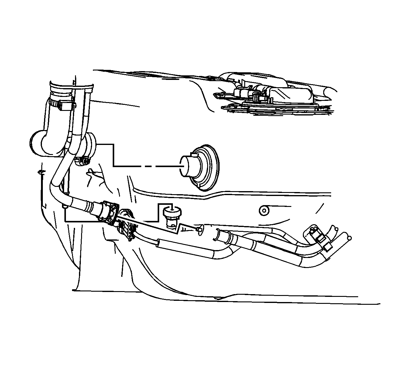

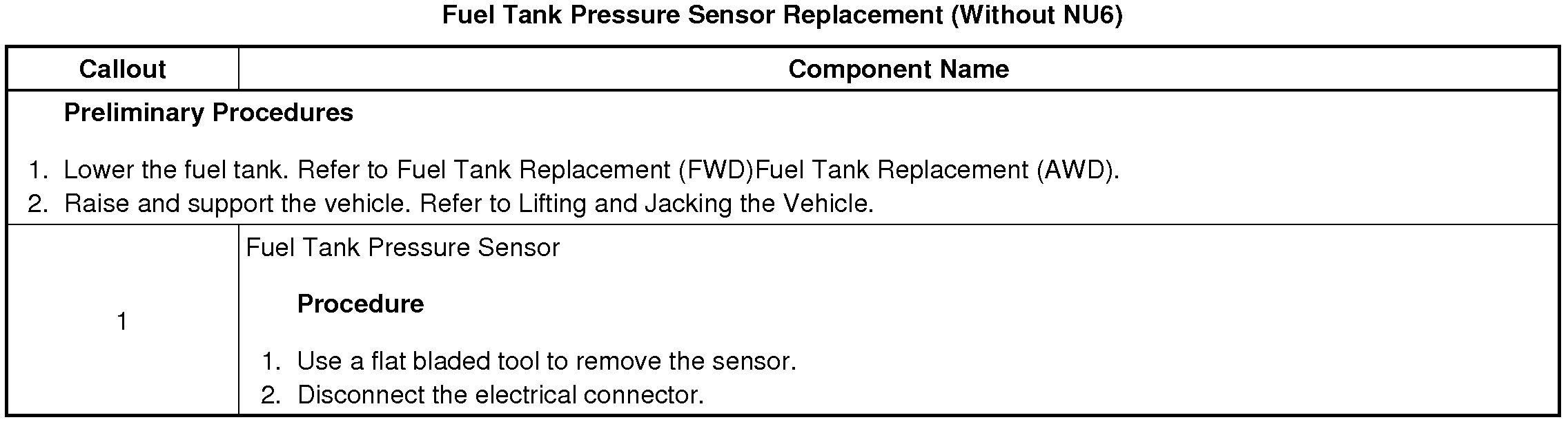

If you are certain the sensor needs replaced, here are the directions.
Picture 2 and 3 are the directions and location of the pressure sensor. Sorry I had to provide the directions in picture form, but it was my only choice.

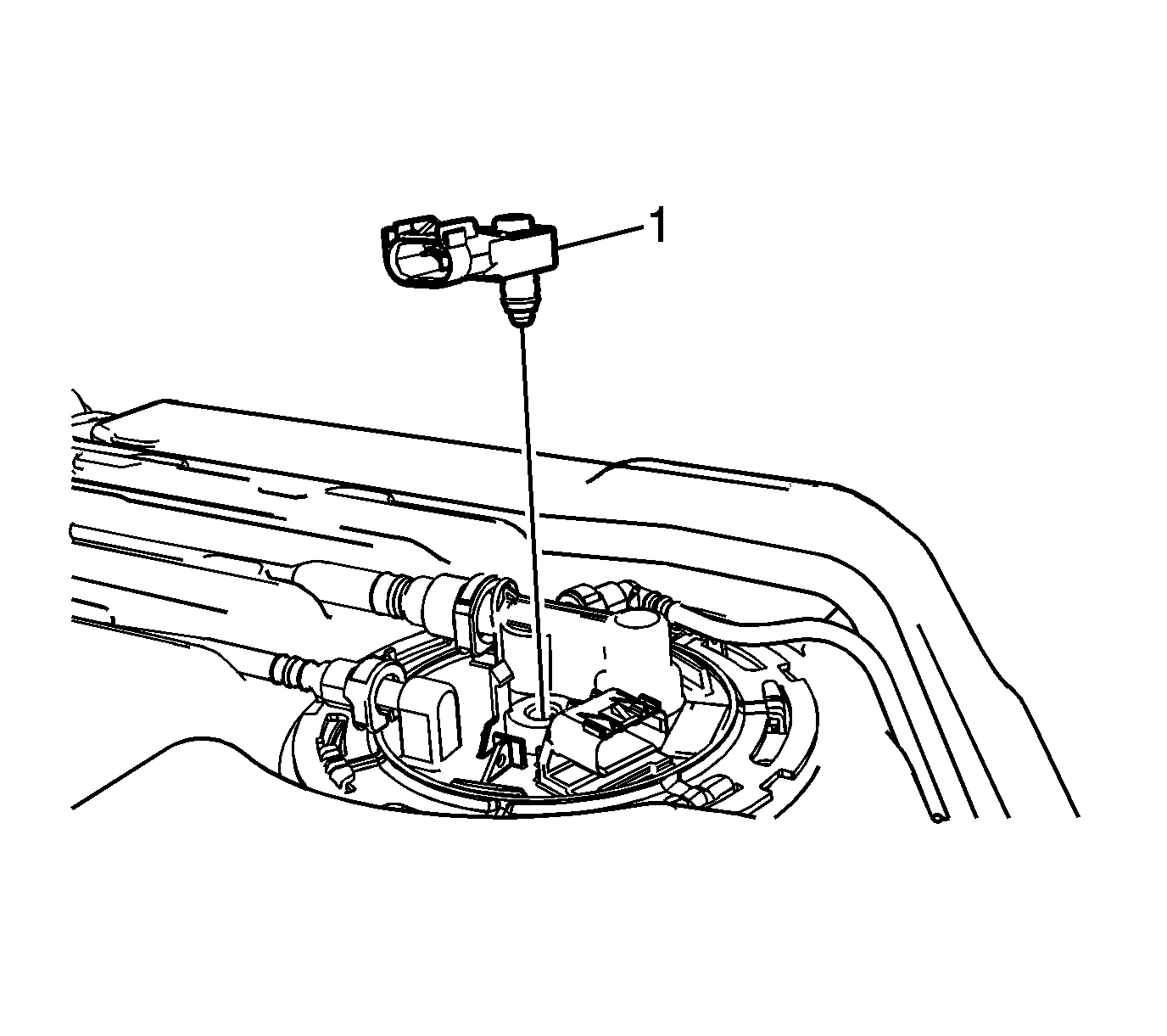

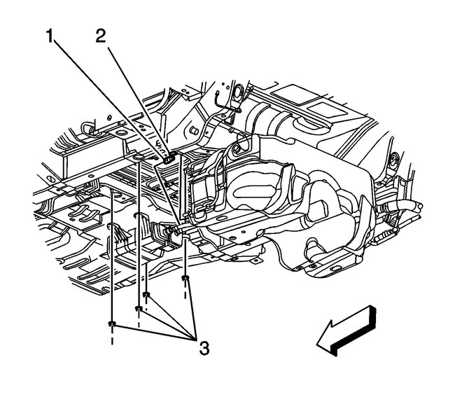

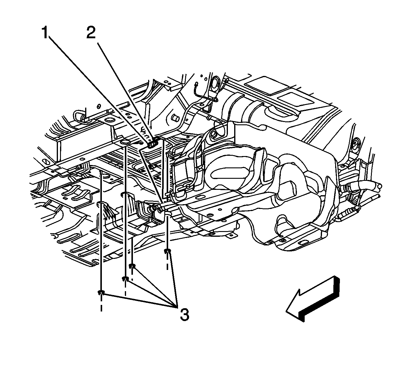

You will need to remove the fuel tank. Here are the directions for tank replacement. You will not be replacing the tank, but the directions provide removal and install instructions. Starting with picture 4, the remaining pics correlate with these directions.
