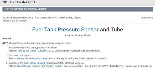

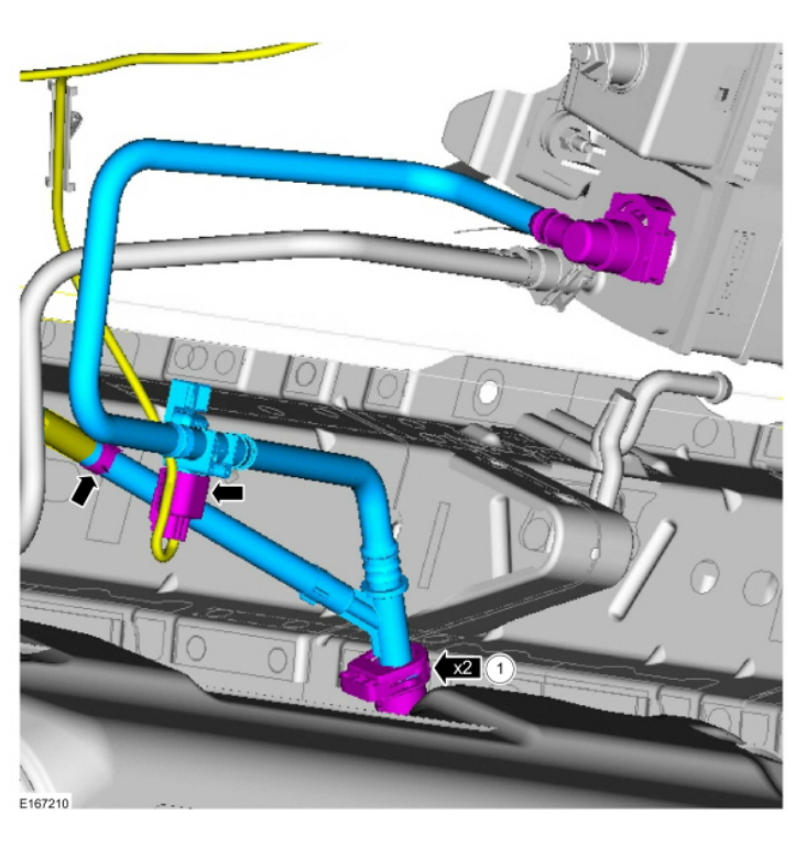

I'm trying to figure out where to locate and how to change the fuel tank pressure sensor on my car listed above. Any help would be greatly appreciated.
Jul 21, 2023 at 6:46 PM
Sure, here is the fuel tank pressure sensor. Check out the images (below). Please let us know if you need anything else to get the problem fixed.
