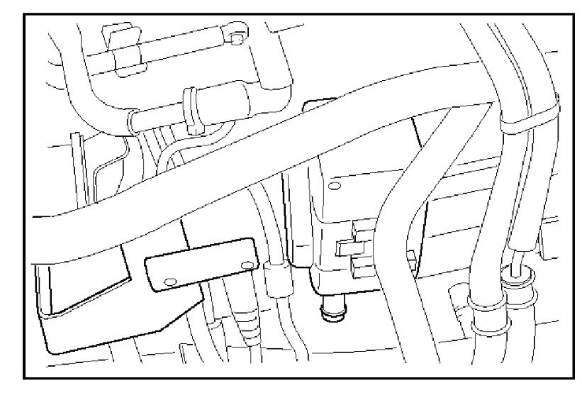

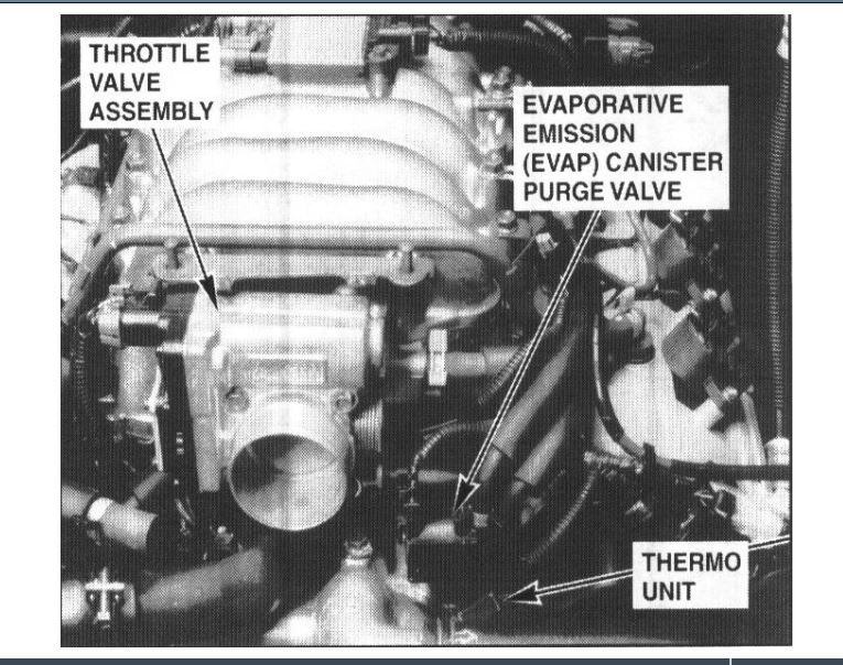

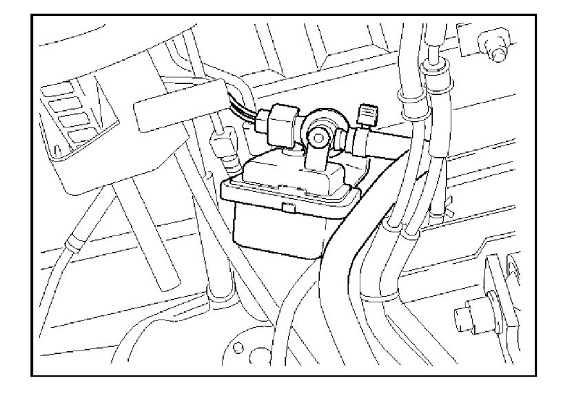

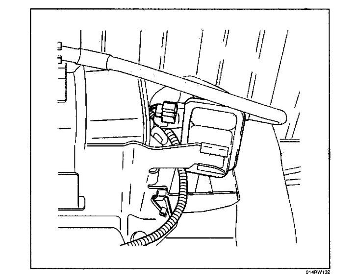

Good morning.
the first thing I would do is replace the fuel cap.

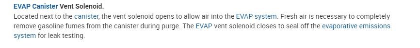

Beyond that, the vent valve is supposed to be open all the time. If it is stuck closed, it will also cause this issue.
https://www.2carpros.com/articles/how-emission-control-systems-work
Are there any codes stored or is the check engine light on?
