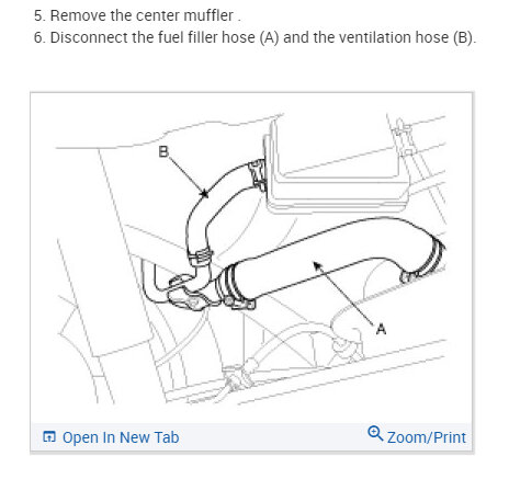

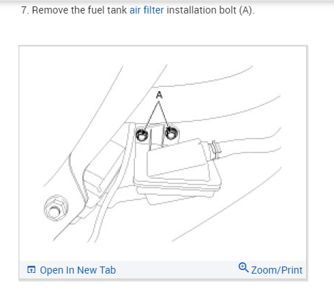

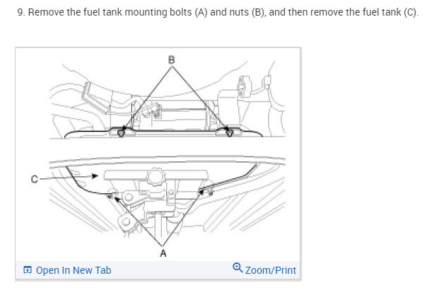

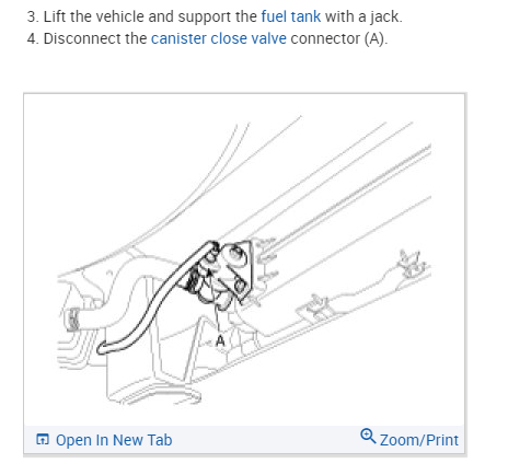

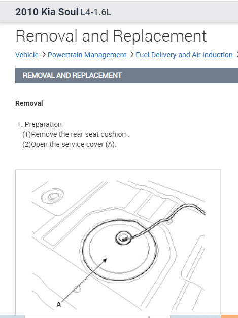

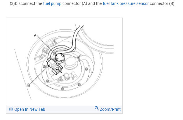

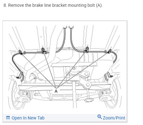

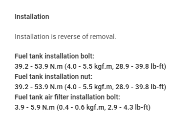

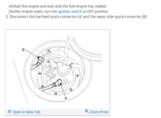

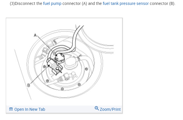

For some reason, I'm not finding the vehicle until 2010. I checked in two different manuals. I attached the directions for replacing the fuel tank for a 2010. It should be the same. If, however, you notice things that are different, let me know.
Also, make sure to keep in mind, the tank can be heavy if there is fuel in it. Make sure it is supported using a jack and something like a 2x4 between the tank and jack to lower and raise the tank.
Let me know if this helps.
joe
See pics below.
