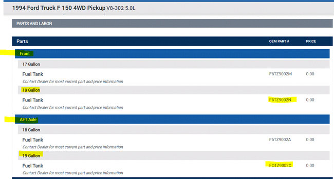

If you are referring to the "mid-ship" fuel tank, there were two options. One was a 17 gal and one was a 19 gallon. The rear tank, behind the axle, could be an 18 or 19 gallon tank.
Here is what I suggest: If you look below at pic 1, it indicates the options for the mid ship tank and the one after the axle. Additionally, it provides the original part numbers.
I'm not sure what you are considering, but see if the OEM part number crosses to the new take you want to purchase.
Also, inspect the fuel filler tube for rust issues. If it is in good conditions and has no leaks, there is no need to replace it. Do the same with the fuel lines. If they look good, there is no need for replacement.
Let me know if this helps or if you have other questions. Additionally, let me know which tank you are replacing (front or rear) and I'll get the directions for removal and install for you.
See pic below.
