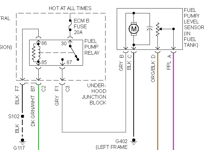

My truck has the 4.3 engine. It just quit running all at once. I thought it was the the fuel pump, so I changed it and nothing. I tested my old pump and it was working fine. I then traced all my wires up to the fuse box under the hood and nothing, my fuel pump relay? and checked all fuses and still nothing. I checked the fuel pump plug in. And it was not getting any power. What could possibly be causing this?
May 26, 2013 at 11:17 AM
Here is a guide to help check the relay and the relay location in the diagrams below.
May 26, 2013 at 11:28 AM

Engine cranking, do you have spark at the spark plugs? Do you have injector pulse? Any fuse you check, you have to check for voltage on the fuse circuit. Use a voltage tester. Wiring diagram below.

2000 chev silverado 5.3 4wheel drive no power to fuel pump only for sender checked fuse and relay all good i did notic i only have 1 source of power where the relay is do i need 2 sources and if i do where does it come from thanks

If its tied in with the oil sending unit it will look like this, the PCM energizes the relay coil side then the switch side will close to give power to the pump this is how it works-

Welcome to the forum, Did you check for voltage at the fuel pump relay circuits? Voltage to the load side of relay is hot all the time. Check voltage for the coil side of relay, engine cranking.
you might use a noid lite, see if you have injector pulse, engine cranking? Are there any codes? Did you use a gage and check fuel pressure before replacing anything? Also, check for voltage and ground at pump connector.
