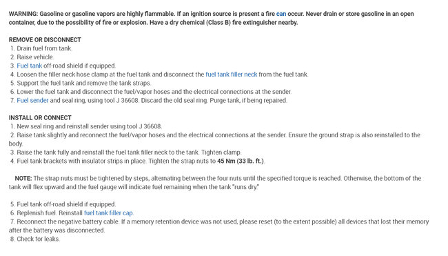

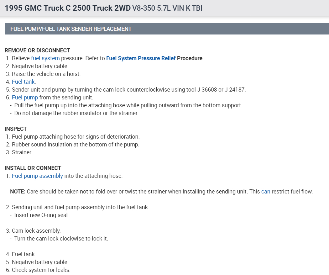

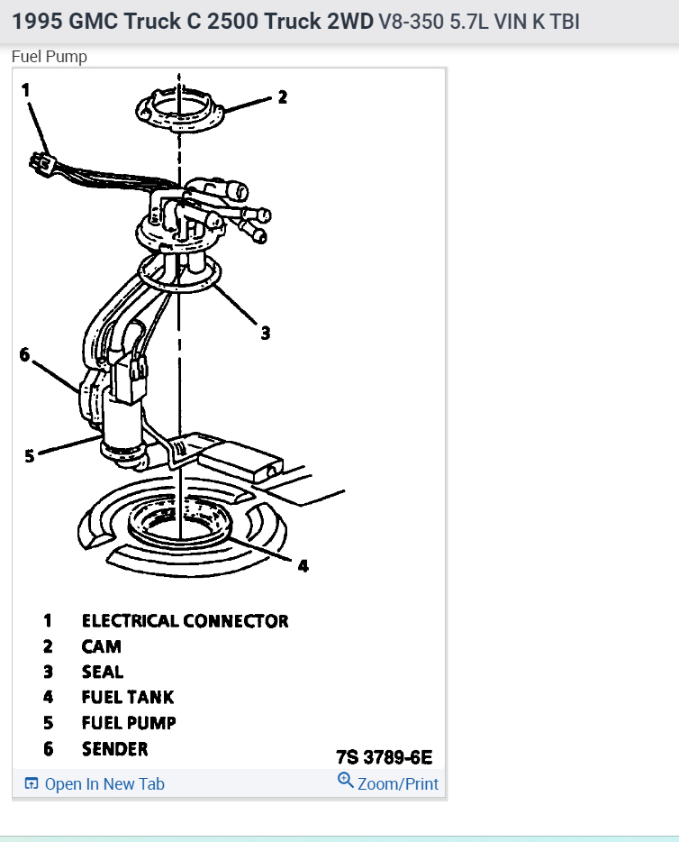

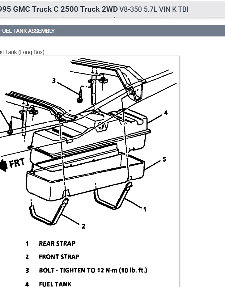

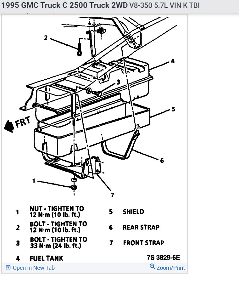

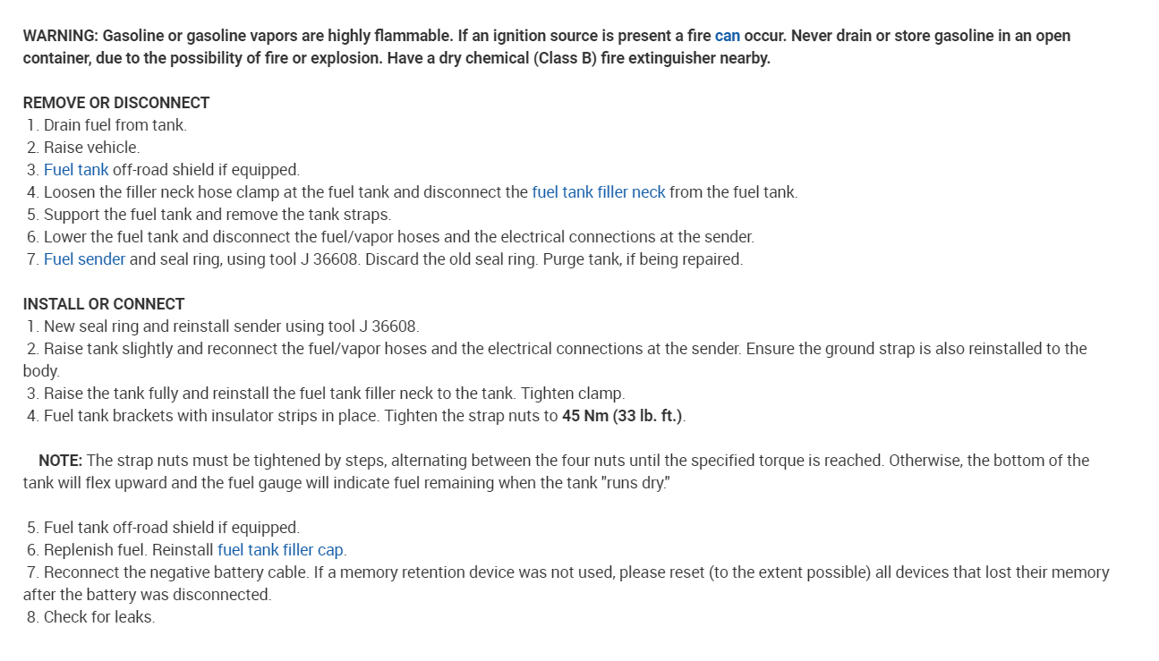

Yep, it sounds like the fuel pump has gone out here is how you can remove the tank to change it out, you must drain the fuel first.
https://youtu.be/Q5MH2gnyFH0
Here is the pump for $48.00 on amazon:
https://amzn.to/3HQ6goS
Please check out the instructions for the fuel replacement in the images below. Please let us know if you need anything else to get the problem fixed.
