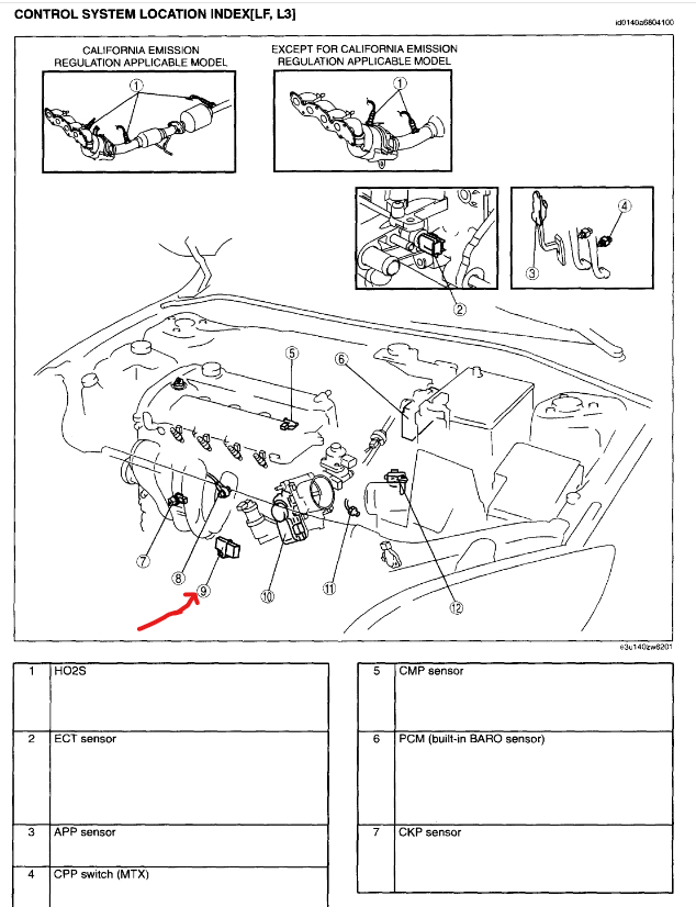

Vehicle throwing code P2187 (System too lean at idle). I have replaced both o2 sensors, a new fuel filter, and run an injector cleaner through it, issue remains. Fuel trim (long term) is sitting around 20% and short term grows from 0 to 20% when at idle over approximately 5 minutes. While running, short term fuel trim varies between +8% and -8%. Hoping for suggested next steps in diagnosis before I shell out for new injectors, a new MAF sensor, new fuel pump, etc.
