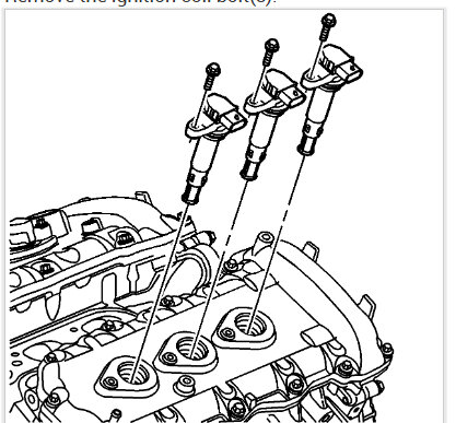

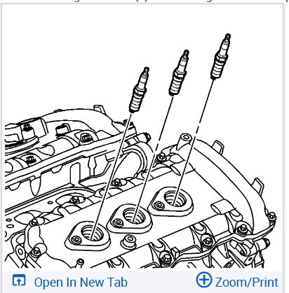

This sounds like a weak fuel pump (low or high pressure) or the engine is misfiring, I would make sure the tune up is up to date, spark plugs and coils. Also, service the throttle body. Here is a guide to help check the fuel pressure. You might have a tank of bad gas as well. Also, even thought the check engine light is not on I would run the codes

Spark plugs - ACDelco 41-109

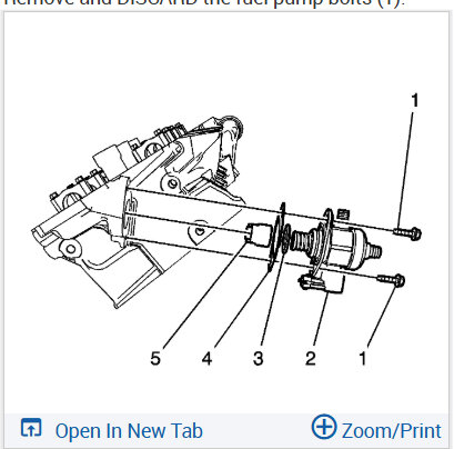

I have seen the high pressure fuel pump go out on this car, Check out the images (below). Let us know what you find.

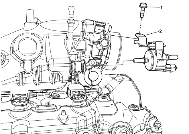

So reran scanner it’s in my evap system I’m thinking purge valve purge canister but does that explain the kick and issue with downshift?
Jul 30, 2025 at 3:25 PM
If it is stuck open than yes you could have a leak, here is the location of the valve, once removed you should not be able to blow through it. Check out the images (below). Let us know what you find.
