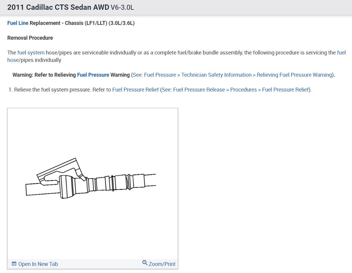

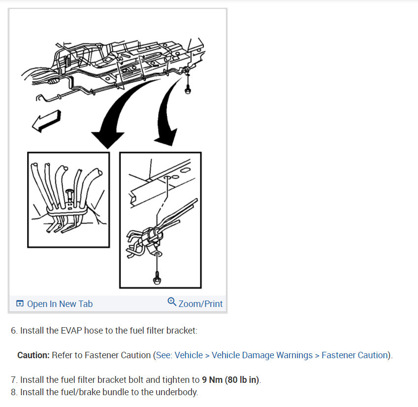

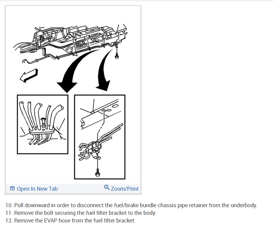

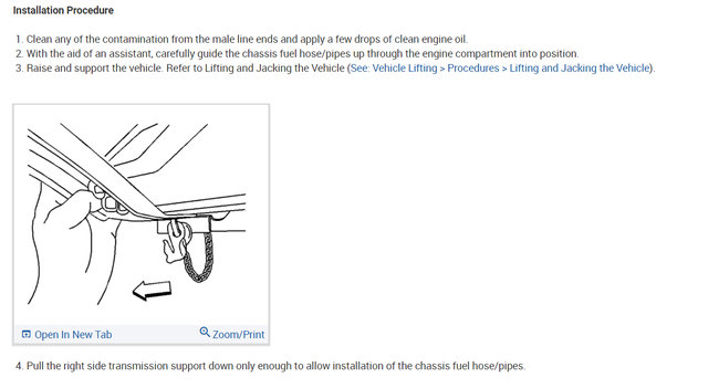

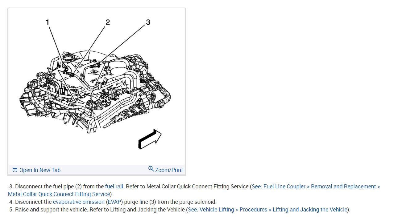

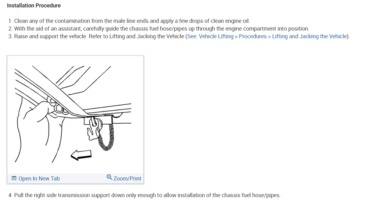

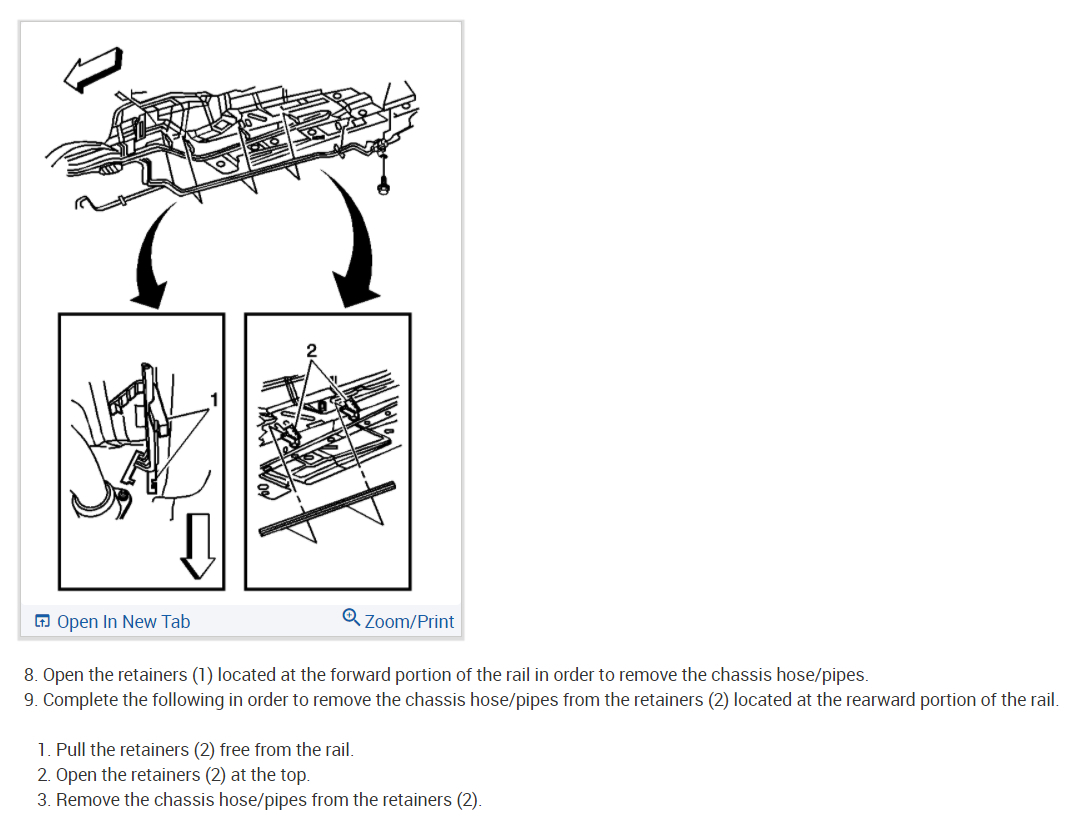

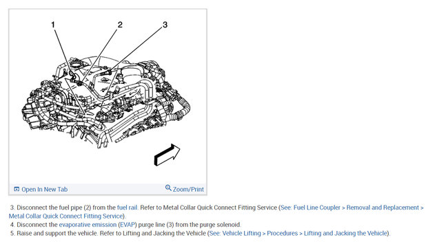

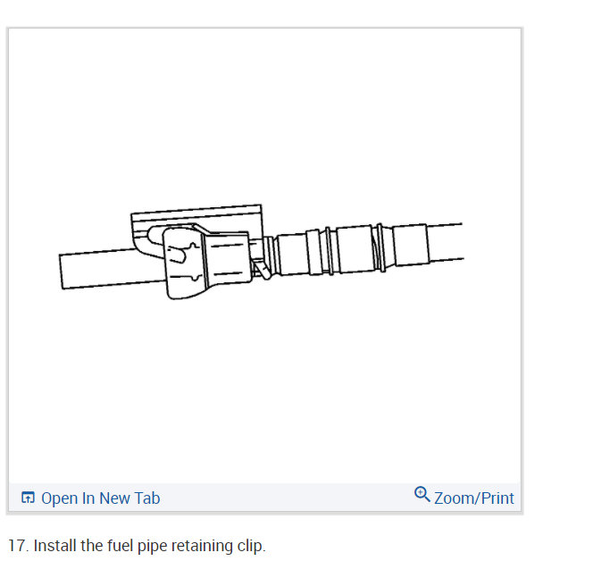

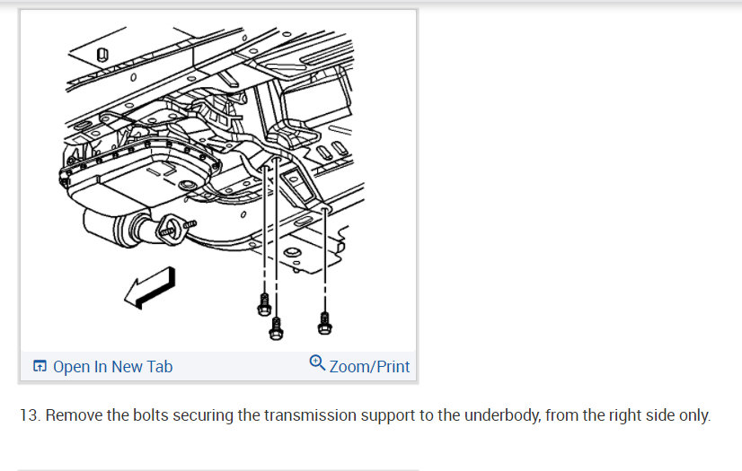

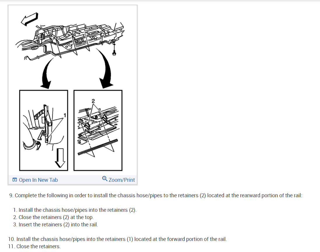

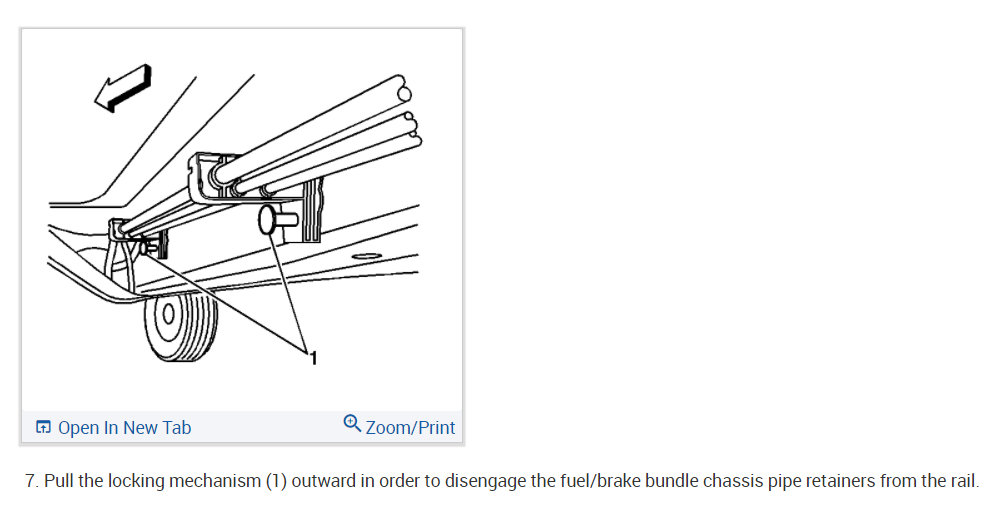

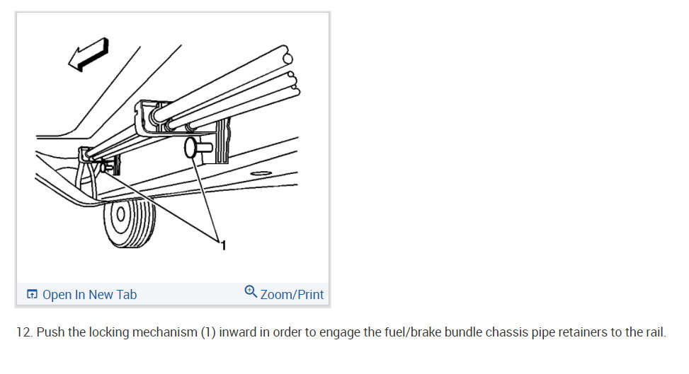

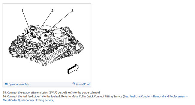

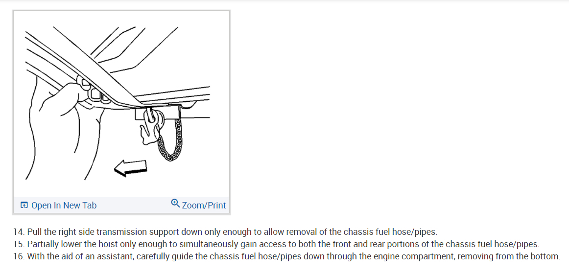

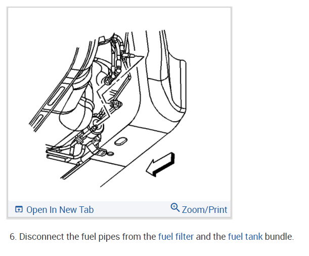

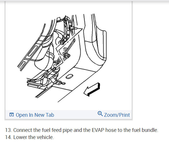

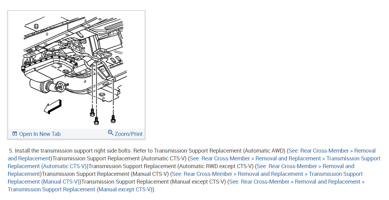

I would like to get a diagram of how the piping is run from the tank to the engine showing the location of each of the components in the piping. Piping size would also be helpful if available. Which side of the vehicle the piping is routed is very important. Thanks, Frank
Jan 11, 2021 at 4:17 PM
Here is the fuel line replacement instructions in the diagrams below which show the routing. Check out the diagrams (below). Let us know what happens and please upload pictures or videos of the problem.
