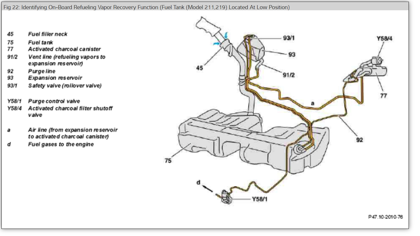

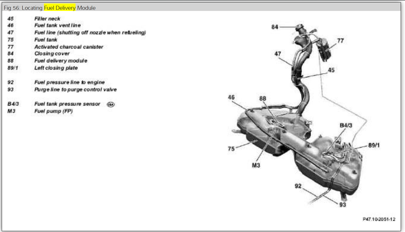

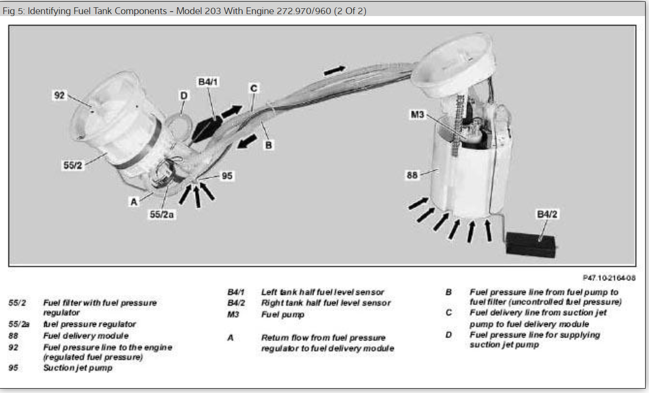

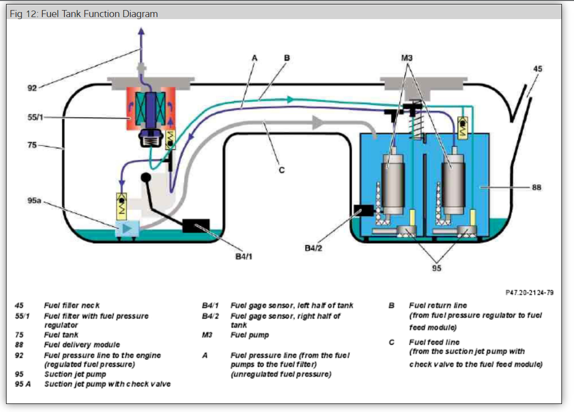

I have the PZEV with code 917 version 2006 Mercedes-Benz e350 and I would like to know what the purpose of each fuel line attached to the fuel filter does. I would like them each identified and explained consecutively with a diagram/s if possible.
Oct 28, 2018 at 2:24 PM

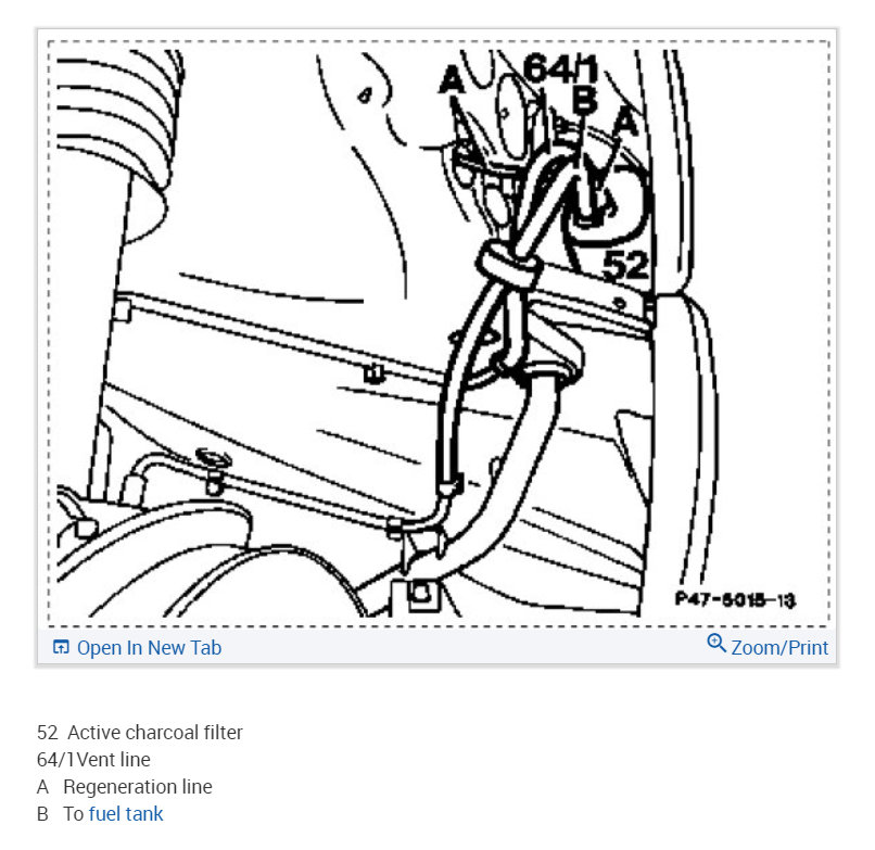

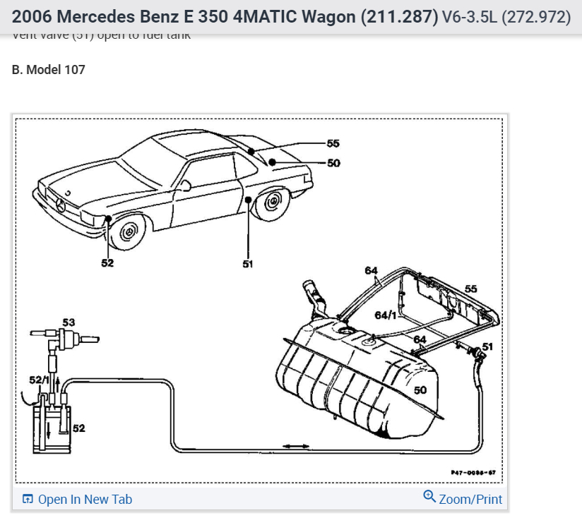

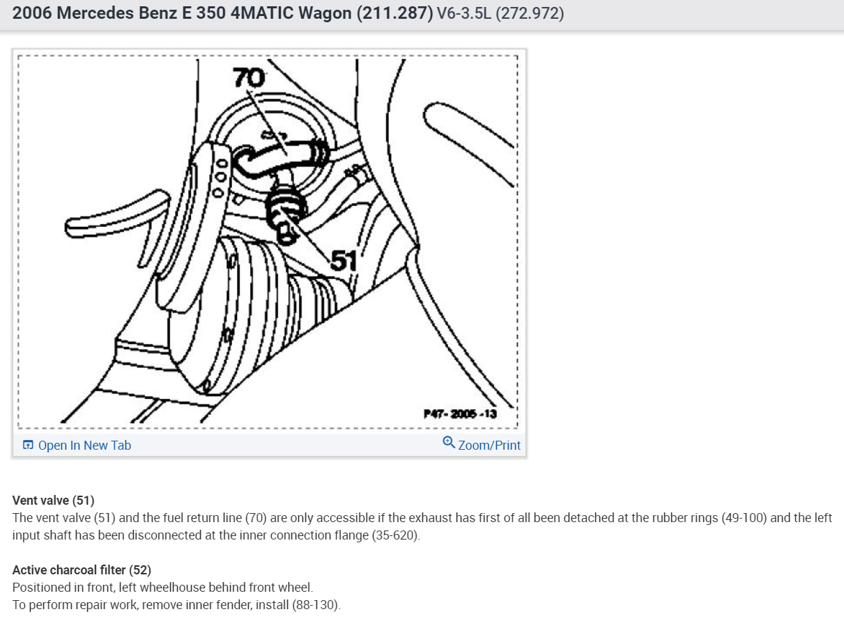

Here are all of the fuel system descriptions and diagrams I could find on your car. Check out the diagrams (below). Please let us know if you need anything else to get the problem fixed.
Oct 30, 2018 at 12:44 PM

I asked specifically for fuel lines connected to the filter, flow charts. These are vacuum diagrams.
Oct 30, 2018 at 3:51 PM

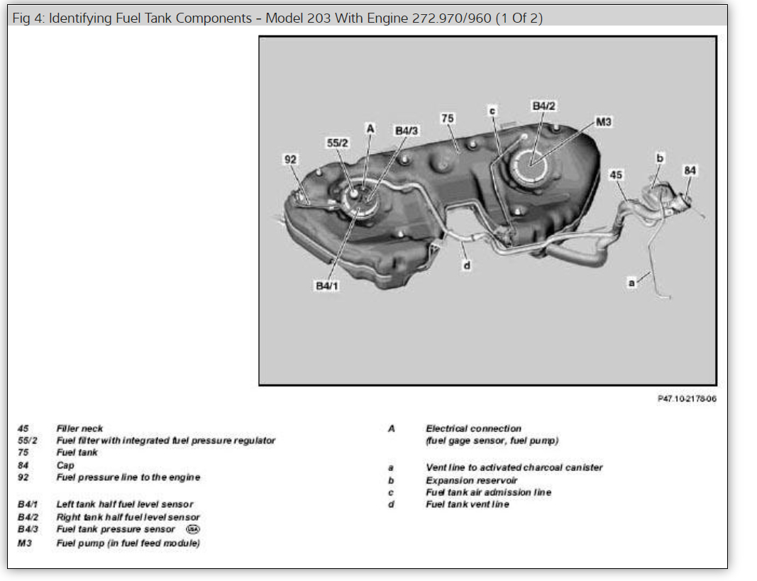

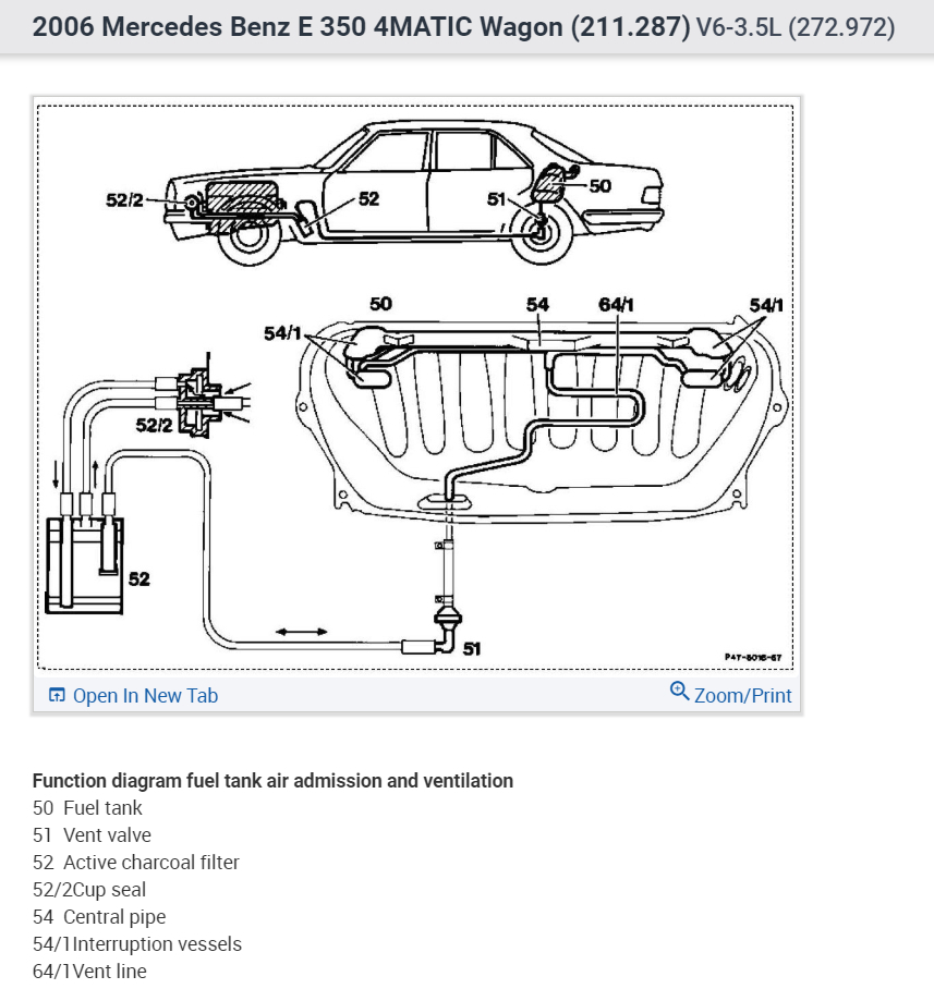

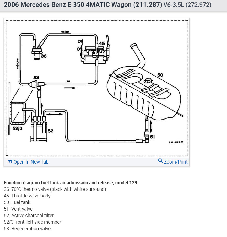

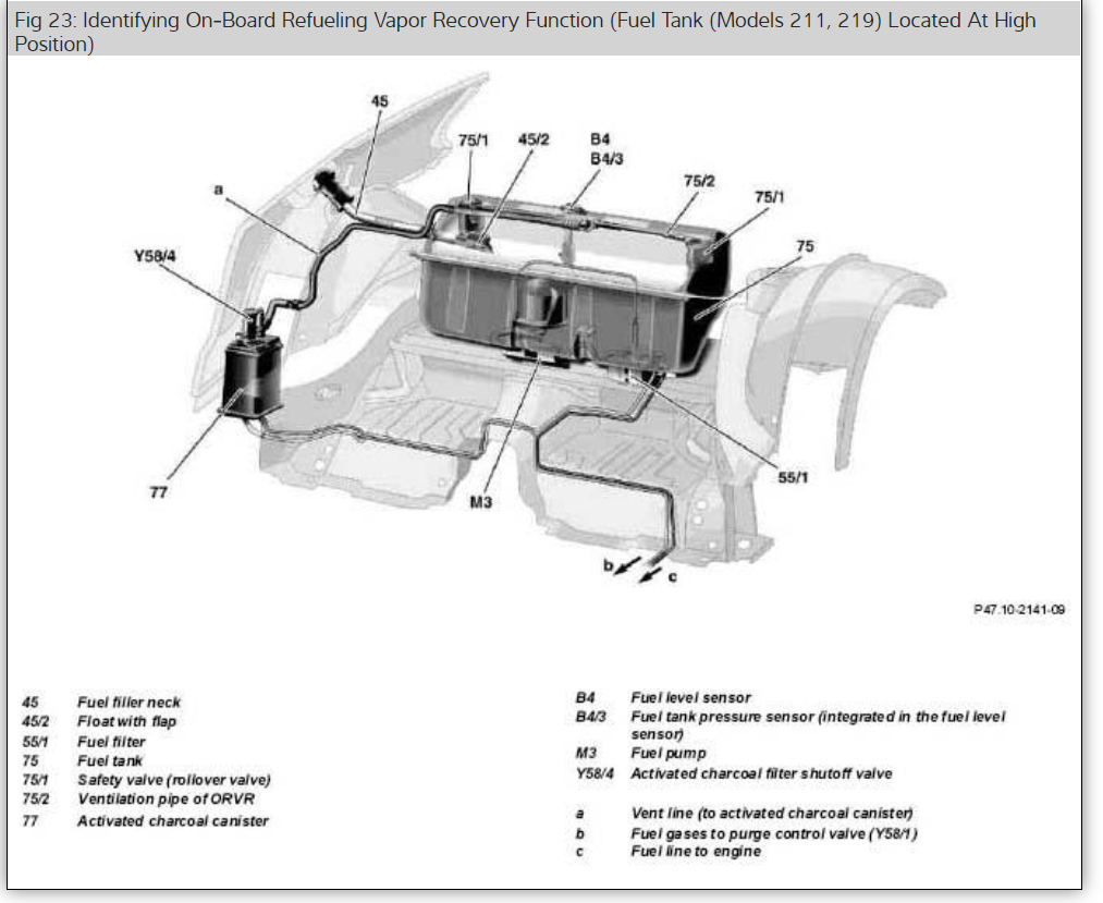

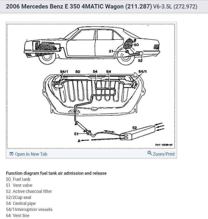

Sorry about that here is what else I found. Let me know if that helps.
Oct 31, 2018 at 11:16 AM

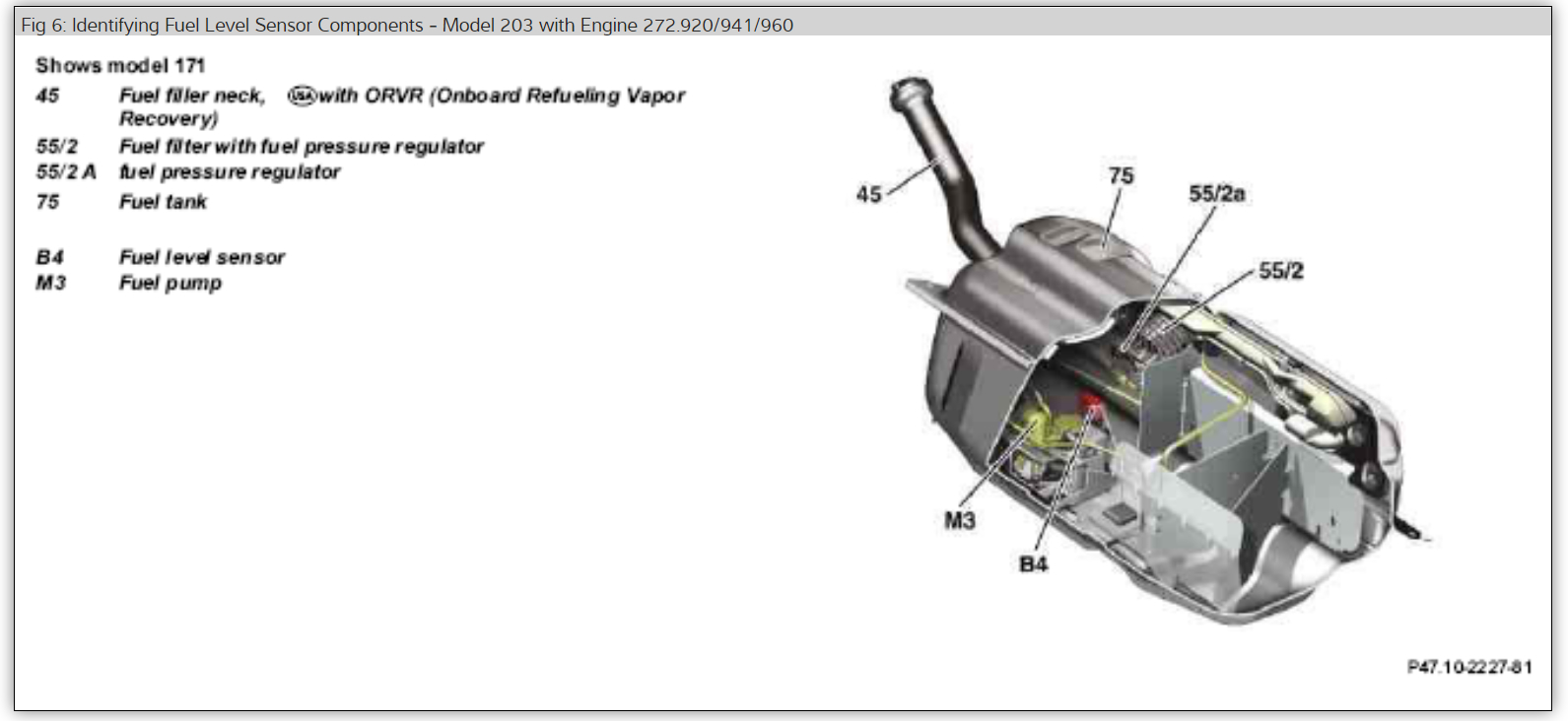

That is very helpful. My case is that fuel smell then later fuel pump stopped working. My question please is the fuel sending unit with integrated fuel pressure sensor the same for PZEV and non-PZEV tank??
Thank you
May 14, 2023 at 12:27 PM
Here is what is said about the problem:
In the 2006 Mercedes-Benz E350, the fuel sending unit with an integrated fuel pressure sensor may not be the same for PZEV (Partial Zero Emission Vehicle) and non-PZEV tanks. The PZEV designation is typically used to indicate vehicles that meet stricter emissions standards. These vehicles often have additional emissions control components and systems compared to non-PZEV vehicles.
To ensure the correct fuel sending unit with an integrated fuel pressure sensor for your specific vehicle, it is recommended to consult the vehicle's manual, contact a Mercedes-Benz dealership, or reach out to a trusted parts supplier who can verify the compatibility based on your vehicle's VIN (Vehicle Identification Number).
