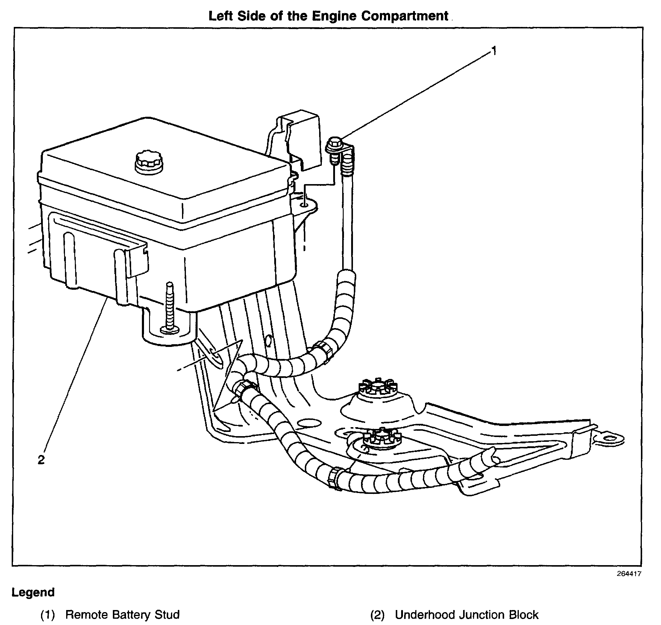

As far as the fuel pump relay, it is located under the hood in the relay box. I have attached a picture of the relay box to help you locate it. Under the lid, it will identify what each relay is for.
