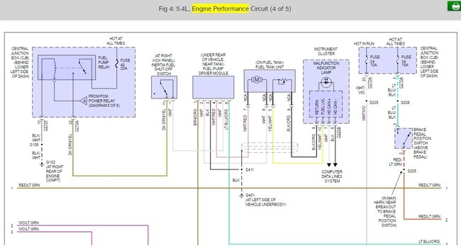

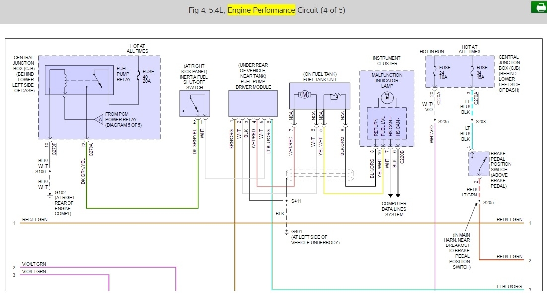

I was able to find a diagram in "Prodemand" as to the location of the relay you requested.
See partial diagram below, upper left corner.
The Medic
Feb 5, 2017 at 5:57 PM
BROLG172
  • 4 POSTS
thanks the schematic was very helpful. I have been unable to find one online it just kept flooding my PC with useless webpages.
